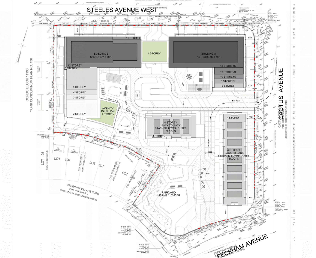

* note that this the highlighted area is all 1 lot legally, and contains both listed addresses, but also contains additional addresses.
This proposal will include those properties fronting Cactus, they may or may not include any others.

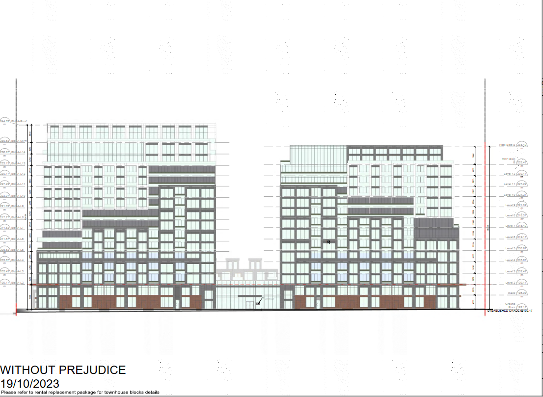

This ought to be the norm along arterials as you mentioned @Northern Light

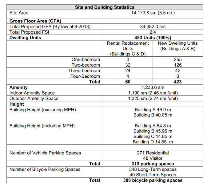

Quick thought exercise, the net new unit total here, after replacement is 423.
That's over a span of only 135M of frontage on Steeles.

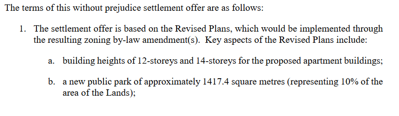

This one was before November's Council meeting in the form of a settlement offer:
From the above:

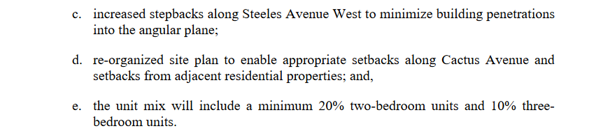

Note, the offer was then revised:

Sure, ok.... I'm fine w/the height reduction, but the rear setbacks look down right goofy...........why? It was too much already......
Seriously though........ I'll defend a lot either because I believe in it, or because it's a toss-up, and people deserve some room to make a call.............
The setback at the front is almost weirder......from a wind management point of view, I don't want to see a 13s streetwall.
But if you're going to do a single setback this looks more like box checking than achieving something..
Ok......if everyone's happy, sure....
