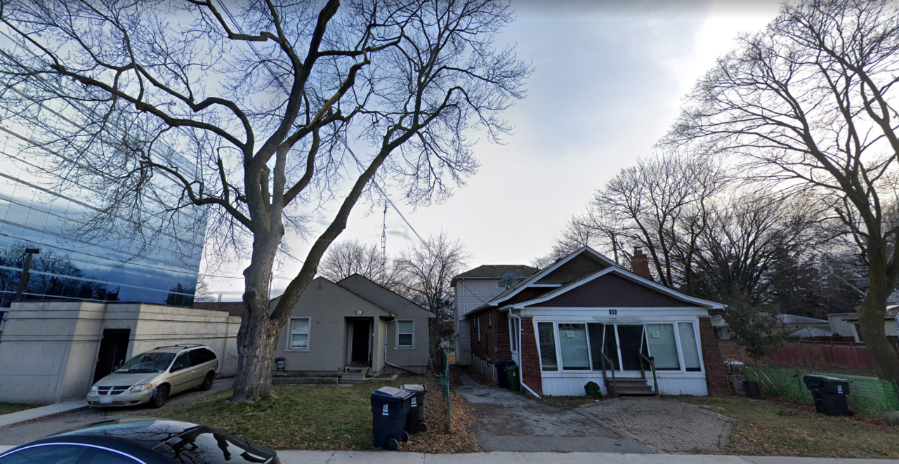

Lets look at the Streetview photos first:
One can see the adjacent Yonge St. parcel off to the left in this photo.

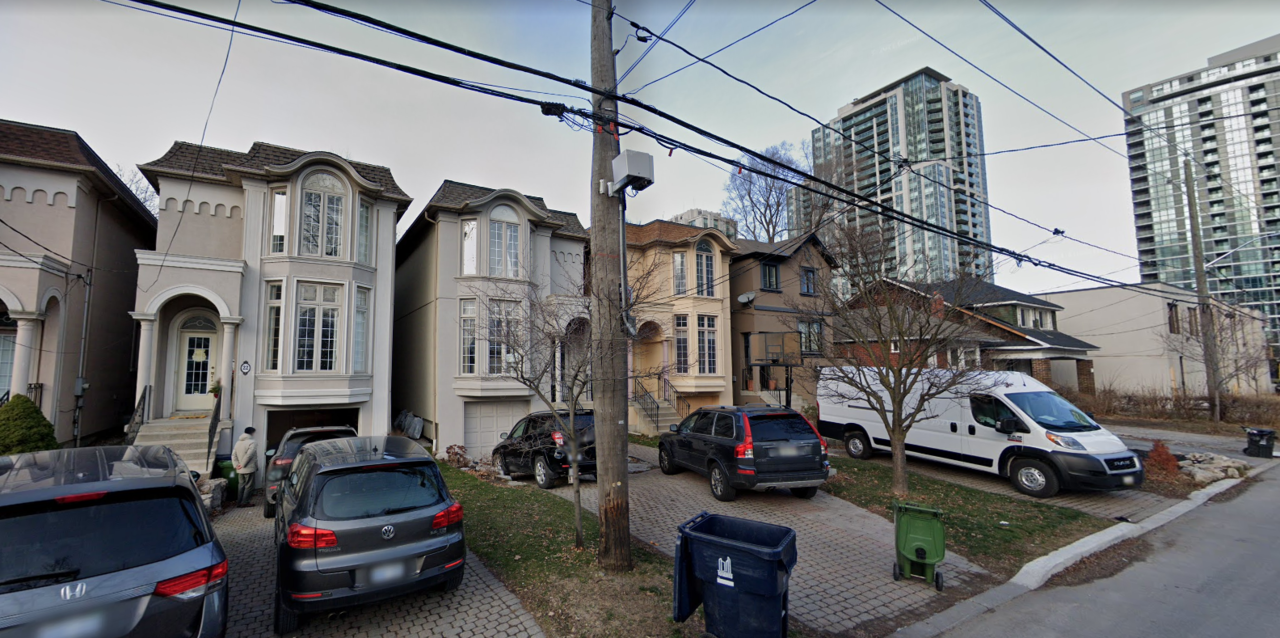

Across the road is :

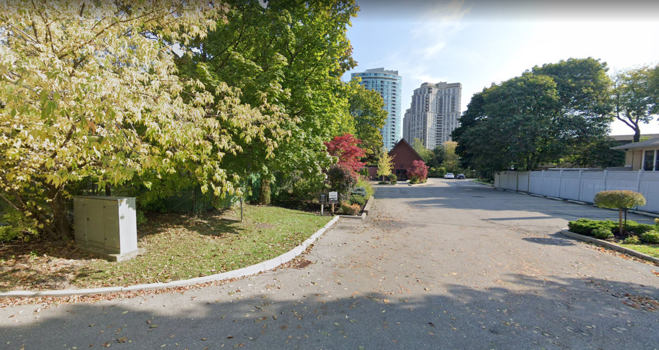

The area immediately south is a parking lot for a Crematorium........followed by more SFH

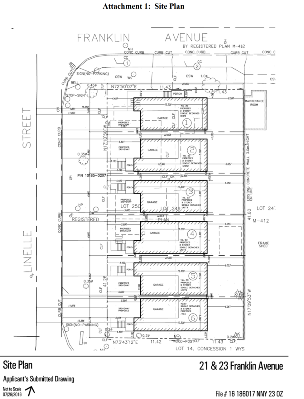

21 & 23 Franklin Avenue are each 37.5' frontage lots a tad bit over 130' deep creating a land-assembly of 75'X130'
- what's allowable is to severe into 3 lots of 25' frontage - resulting in 25'X130' lots with McSkinnies that you see across the street - meeting the minimum frontage and lot areas within the Official Plan for this area

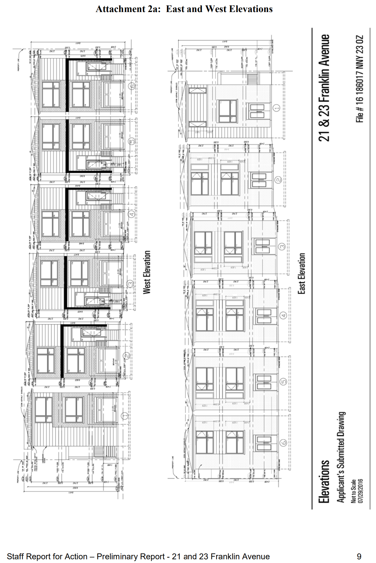

- instead of severe into 3 lots to build 3 McSkinnies,... this applicant (Bijan Moini) proposed to severe into 6 lots to build Micro-Houses. How? Because this is corner lot, applicant plan to severe into 6 not along the current frontage along Franklin Ave but along the side of Linelle Street - creating 6 lots of about 22'X75',... and because the maximum allowable lot coverage in the area is 30% but 32% is often granted upon request - but not the 39.5% being requested here,... these will be Micro-Houses that's half the size of the smallest McSkinnies currently in the neighbourhood! Also, note - the side of a corner lot usually have a parcel of City land about 15' wide,... here, that public space will now be used as sidewalk and THEIR driveway and front yard.
Of course City would refused this Development Application,... so applicant went to OMB/OLT PL170188 & PL180607 - my recollection is the applicant won the appeal to severe into 6 lots - I don't recall the new lot coverage percentage.
