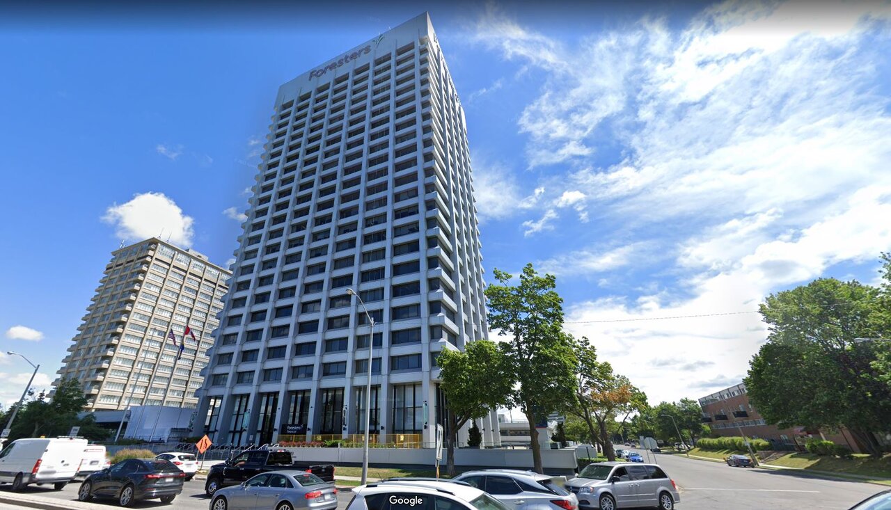

View of the Foresters building on Don Mills:

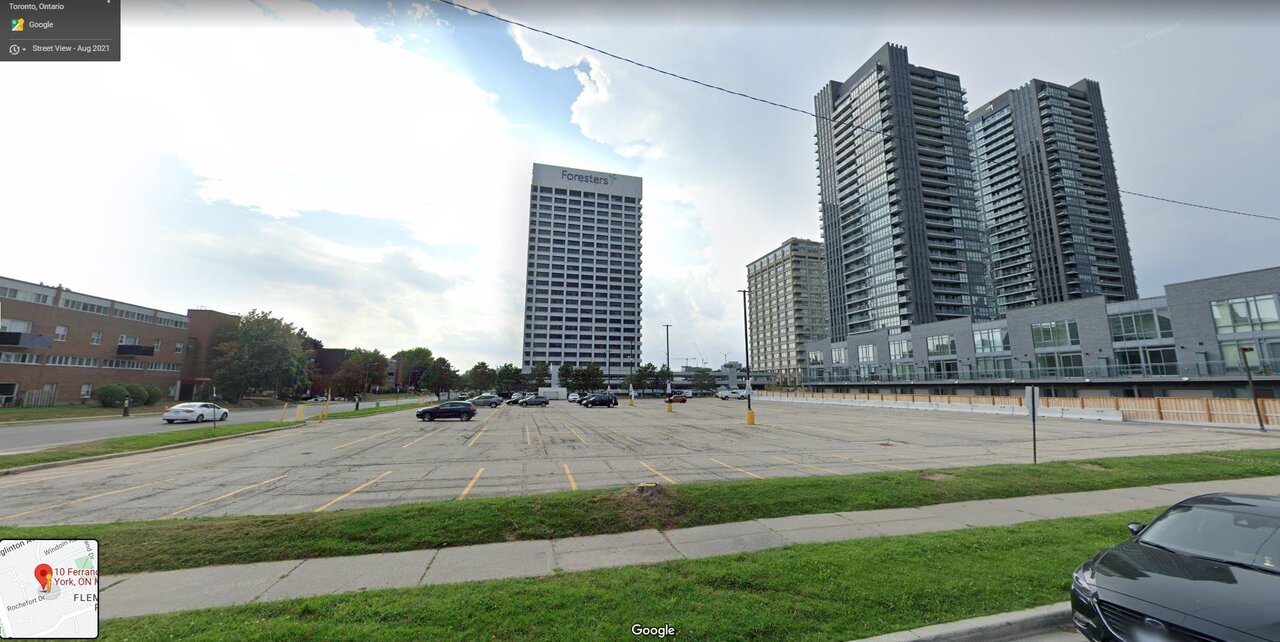

The surface parking lot that runs along Ferrand Drive:

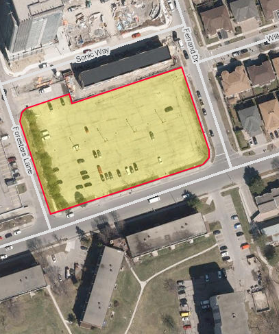

The low-hanging fruit on the site is obviously the surface parking.
That portion is ~6800m2 or a bit over 70,000ft2
Based on typical separation distance requirements, this appears to support 2 potential towers.

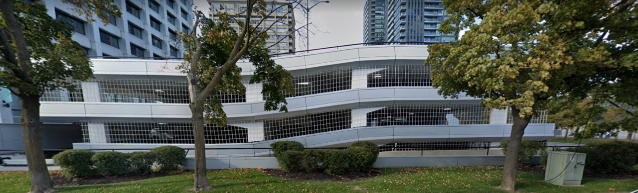

A look at the parking structure just to the west across Forester's lane suggests a tower may be plausible (just), assuming the existing office tower were retained.

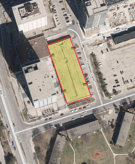

Aerial Pic:
Aerial Pic:
The total area is ~35000ft 2, but a bit more than 1/2 is eaten by separation distance requirements.
* note that I have excluded 'Foresters Lane' from the calculation even though it is part of the site area, as I am assuming the City will require a new public N-S street here.
I have not factored specifically for additional streets beyond that.
Were the office tower component in play, I believe you may see Sonic Way extended to Don Mills.
Were this the case, the office site could still easily manage 2 towers.
If the office site were not divided by a road, and were it developed with the parking structure site it could hold 4 towers for a total build-out of six towers.
I have not factored in on-site park dedication here.

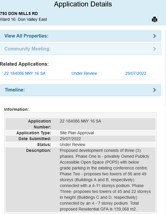

This didn't take long...........App is in!
We were all correct @ProjectEnd , and @innsertnamehere the Foresters building is staying........
But I underestimated Menkes ambition here.....they're going to try to squeeze in 4 towers here...... + Foresters
Some very strategic placement of towers, and use of podiums ............and you get something huge that the City won't approve! LOL
I'll post everything below, the teaser is that all 4 tower floor plates are over 800m......
Note that the ZBA and the Site Plan are both here.

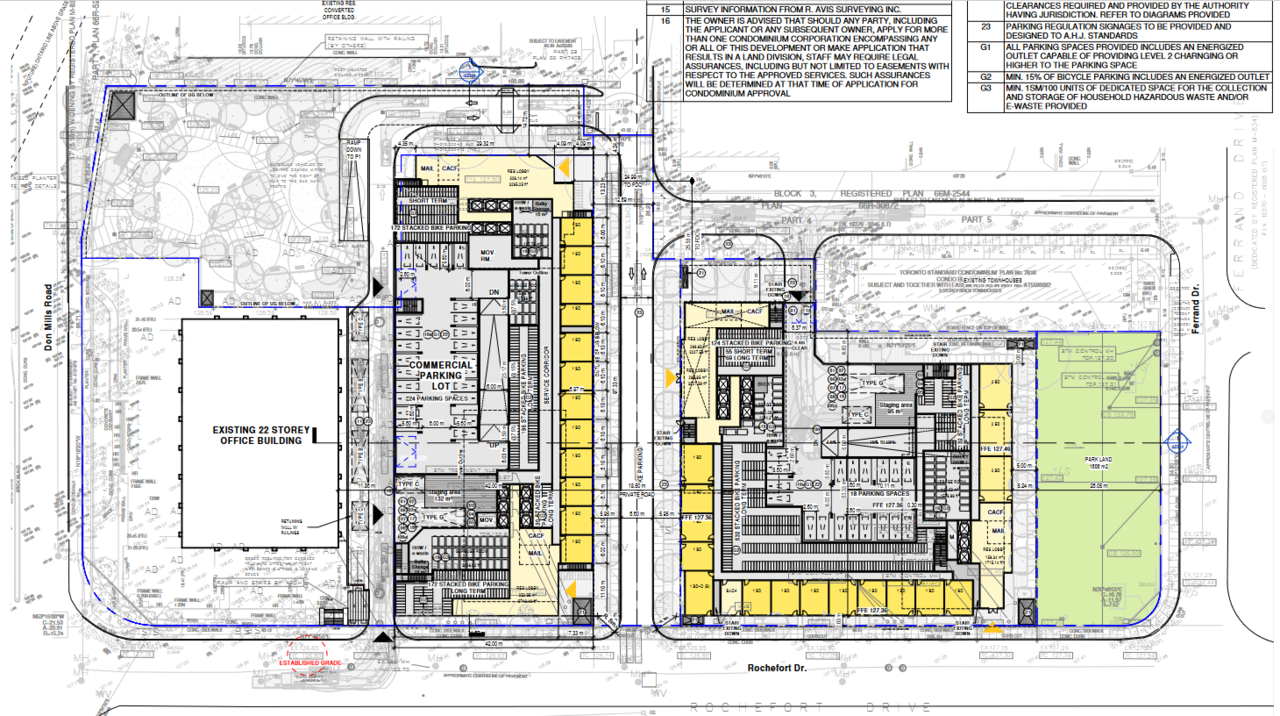

Lets have a look at the Site Plan first:
So, everything new by way of residential is on the Ferrand portion to the site.
But the current 'conference centre' next to the office tower comes down first, as they propose to building parking underneath that and nothing else, to replace what they are losing behind the tower, and then top it with a new POPs
Architect is Sweeney

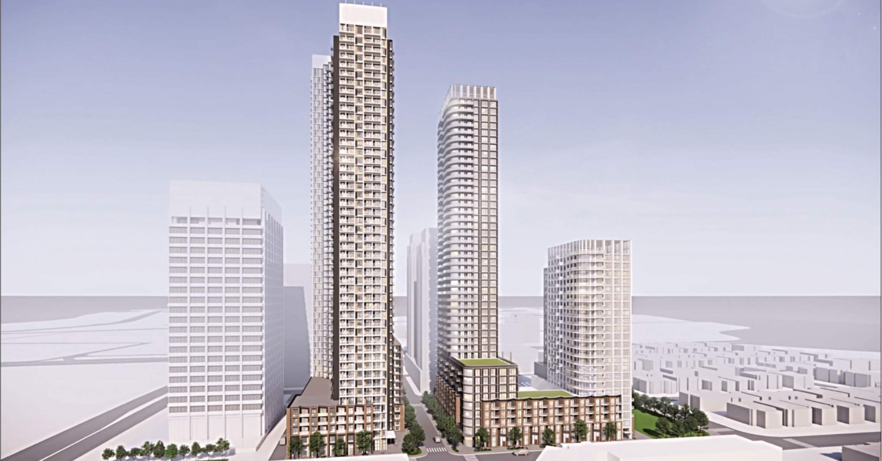

Renders:

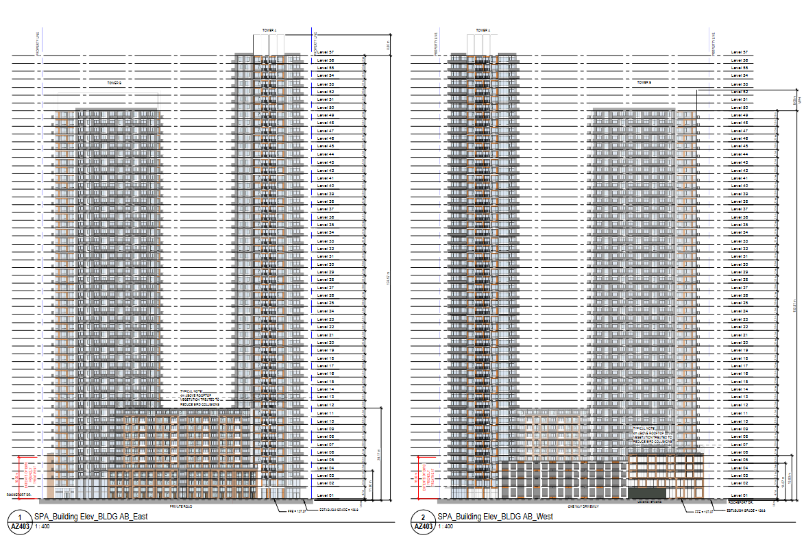

Elevation:

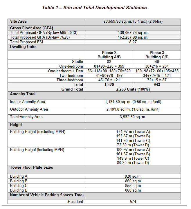

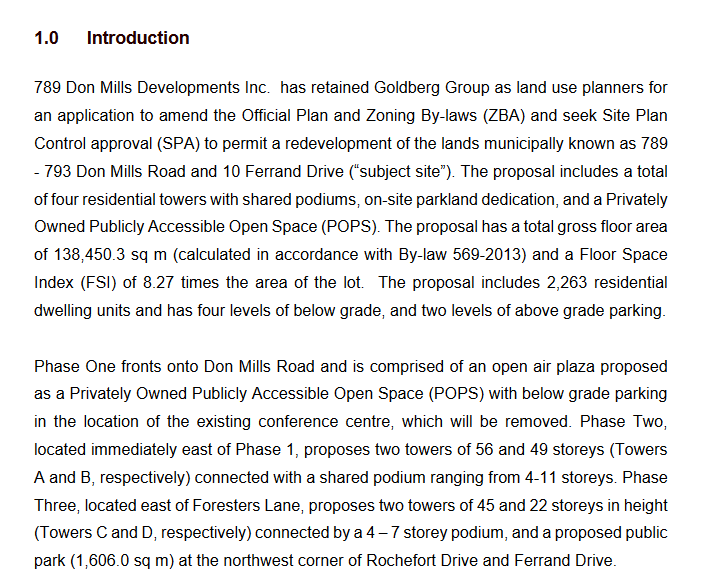

Project Stats:

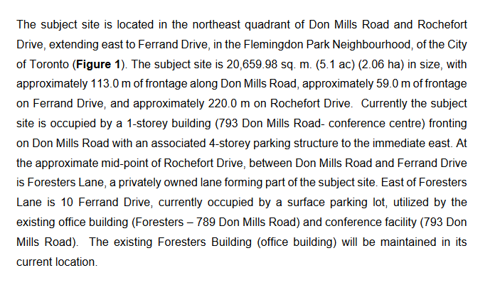

From the Planning Report:
So....the proposal includes 2-4 levels of above-ground parking in the condos...........which the proponent proposes to wrap in residential at-grade:
Commentary:...........whoa boy..............there's a lot here that I'm not thrilled by and/or planning may take exception to; and something things, that they (planning) will probably be fine with that they should not.
While I'm not particularly phased by the heights, the asks exceed what is proposed/approved at every corner of Don Mills and Eglinton........I do not see that getting approved (at that height)
The Don Mills Secondary Plan for the area contemplates a public road where the private road (Foresters Lane) is maintained/proposed.
The floor plates for the towers all exceed 800m; while, if that goes through, @HousingNowTO would love the precedent, I can't say I see a compelling policy reason for an exception here that the City will buy.
No new retail to support the area.
On parkland..........NO.
Planning may like that this is on-site and an ok'ish size........but its not large enough to create sports facilities; and its literally 1 block from a new under-sized park just down Rochefort.
The developer here should be doing off-site acquisition next to the existing park to grow it to a functional footprint.
One final note, the cumulative impact on schools in this area, of all these proposals is beyond problematic.
A new school proposed across Don Mills will be nowhere near large enough if it has to support all the density now contemplated (and yes, more proposals are coming)..........
With two subway lines here, parking should be cut in half. Use some of that space for more community services/spaces instead.
Also, how can anyone call 11s a "podium" with a straight face!'
And 1.5 sq.m. of amenity space seems on the low side; isn't it usually 3-4?

Can you explain what you mean "by the teaser is that all 4 tower floor plates are over 800m......"
I assume that comment is one that everyone understands so I may be missing out due to my lack of knowledge.

The City of Toronto has 'tall building design guidelines'. These typically limit the size of a floor plate in a condo tower to 750m2.
So all 4 towers being in excess of 800m2 is contrary to the guidelines. Planning is usually a stickler about this, and I can think of less than a handful of exceptions that have been
approved.
