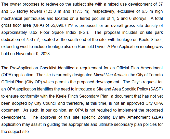

The App:
From the above:

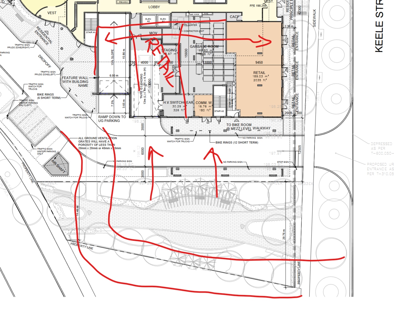

Site Plan:
Ground Floor Plan:

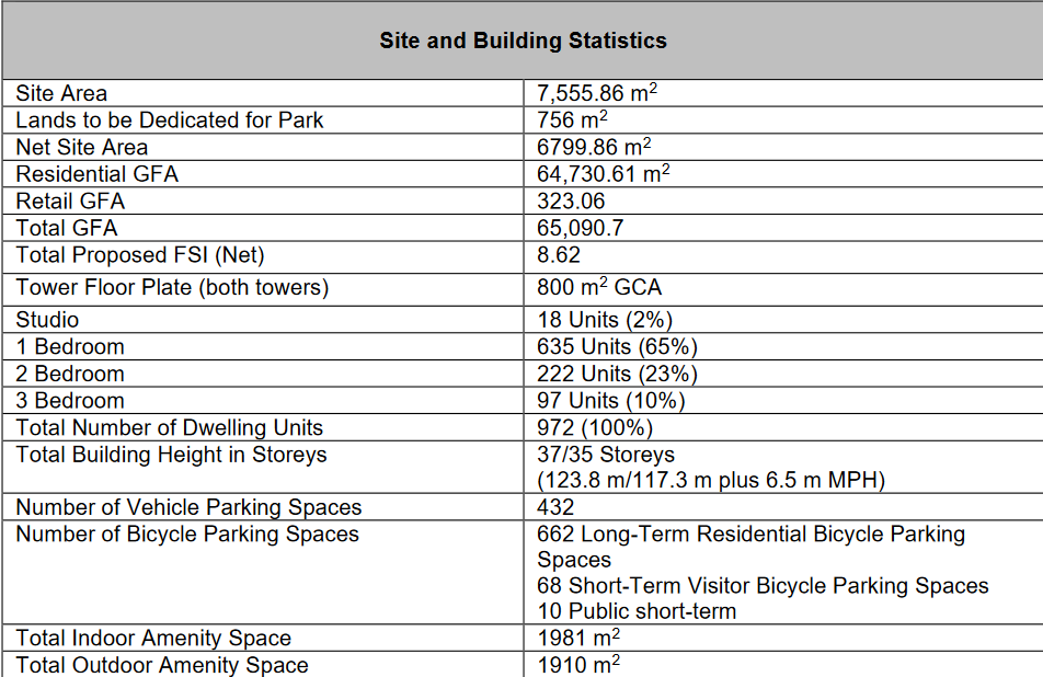

Parking Ratio: 0.44
Elevator Ratio: 8 elevators - 972 units ; 0.82 elevators per 100 units

For KirKor, this is a surprisingly unbusy design. I think the street wall could due to be 2 storeys shorter; and given a warmer tone.......as opposed to black; the retail on the Keele frontage in particular is adequate and the indoor amenity space should not be allowed to front Keele.
The Parking ratio is a tad high, but not absurd; the elevator ratio is distinctly too low by 2 elevators.

As noted in my comments, I can see no reason there shouldn't be more retail on the Keele frontage, repurposing the 'indoor amenity' space in the concept to retail is not a particularly arduous rethink.
Make sure to advocate for a solid street wall of retail on that side.

Height in the title seems off. It's supposed to be 123.8m plus a 6.5 metre mech. This would make the height 130.3 metres. @Paclo
Despite the 123.8m number appearing elsewhere in the submission documents, as per the architectural plan elevations the height to the top of the 37th floor is 120.3m + the 6.5m MPH

Current proposal is for 43 & 41 storeys and a total of 1100 residential units including the 33 rental replacement units
