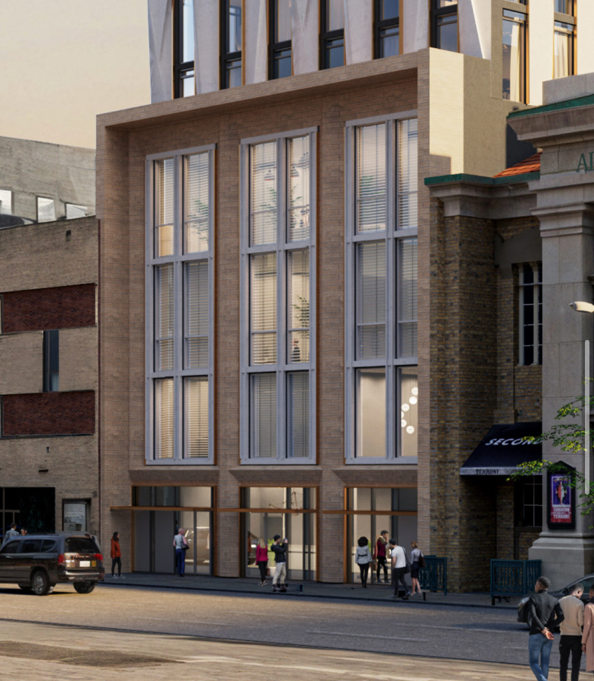

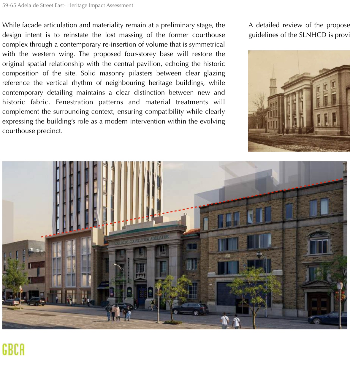

Clearly vapourware, but still: it would be nice if BDPQ designed a decent façade here. What is this? Overscaled windows, overscaled masonry, weird protrusions. There’s no continuity in materials, alignment, scale or detail with the courthouse next door, which is among the best and most important 19c buildings remaining in Toronto.
GBCA’s argument here is weak sauce.
The idea that this could be a serious proposal, or would be received as such by the city, reflects so poorly on our design culture. Please try harder, everyone.
I disagree. What's the incentive to put time and effort into something that will never get beyond the screen or printed page? There is absolutely no difference whether it's stunning or a shoddy kit of parts, so why expect that anyone should put in any effort beyond the bare minimum required to get to the desired outcome? Andy Pollack doesn't care what this building looks like, so why should Quadrangle?
In fact, it puts front and centre something I've long advocated: at this stage, there should be no design at all. Zoning is about height and setbacks. That's it. The idea that things get 'designed' for a rezoning is a silly waste of everyone's time. In essence, rezoning should be nothing more than this:
