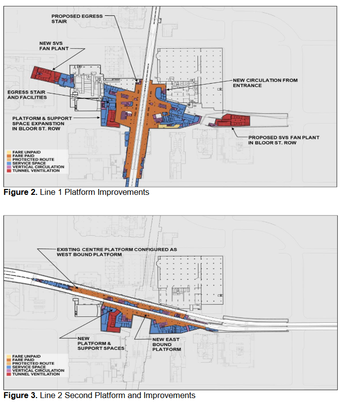

Didn't see a thread for this; it now appears to be a real project, albeit in its early stages.
From the big report to Exec. Ctte
Transit Expansion Program –Status Update
Bloor-Yonge Capacity Improvement Current Phase: Initiation and Development
DescriptionThe Bloor-Yonge Capacity Improvement is a TTC project that includes:
•Building an additional platform at Line 2 Yonge Station;
•Modifications to the Line 1 Bloor Station platform;
•Increasing vertical circulation elements and
fire ventilation upgrades to the station; and
•Constructing a new substation.
Drawings here:
179681

It's interesting to see the new platform will be offset from the current one. You see this on older systems like NYC and London.
