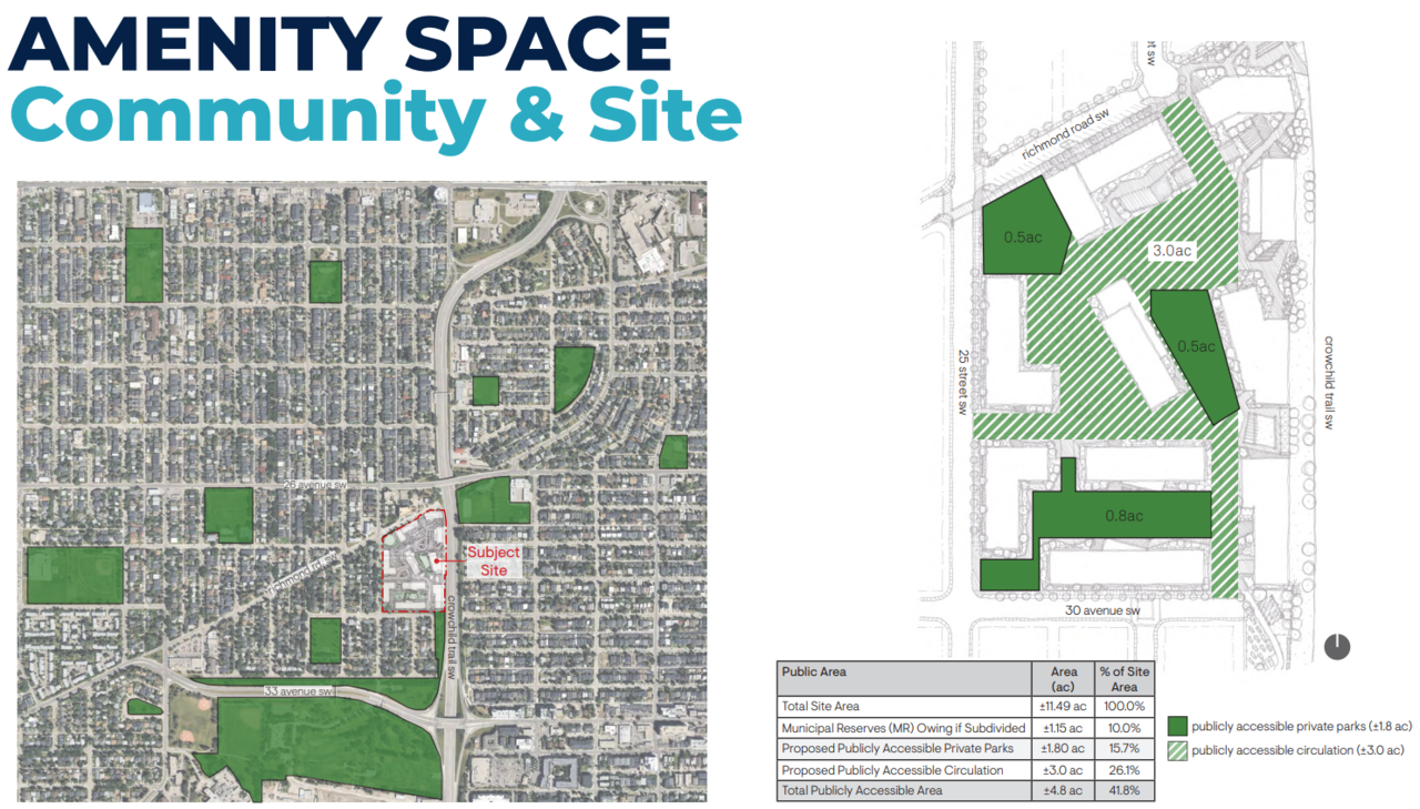

A presentation was made recently to the community association that shows a lot of the details of what is being planned, which can be found here:
Keep in mind these are just concepts as we are still at the land use stage, but overall it is looking like quite a good / comprehensive TOD project (potential for 2500 units) next to our Max Yellow BRT station on Crowchild / 26th Ave SW. Images are from the presentation linked above, lots more details/information can be found in there.
Still early stages but this might be the first full-effort TOD proposal we have seen in a long time. The fact they de-emphasize car and parking circulations even at this stage is encouraging. A site of this prominent of location can really be a catalyst - if you want a walkable city and a city that can change from car-dependent inner burbs to something more urban, this concept is a strong step in the right direction.
The height of of the taller buildings will be a major point of discussion as this comes together, but overall the density and layout is exactly the type of thing we should be encouraging on an existing BRT stop, less than 5 minutes outside the city centre, with great and improving walking and cycling networks, in rapidly growing region of soon to be 2 million people.

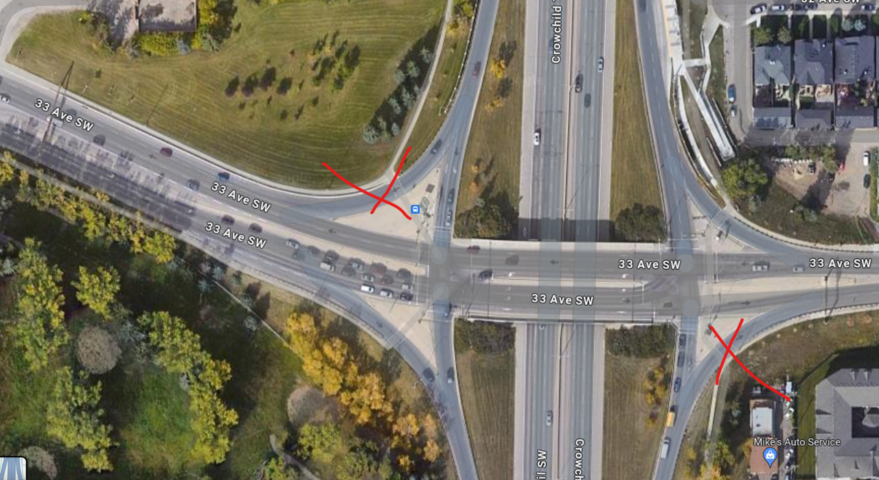

The main thing would be to reduce crossing points where speeding cars interact with 2,500+ new potential pedestrians. For starters drop both these slip lanes - someone exiting Crowchild and entering the area should have an immediate visual queue that they are no longer on an expressway and it's time for 40km/h as they are entering an urban area. Make it far more obvious there's a highway and there's a community distinction.
SB Crow to WB 33rd is most egregious - swooping slip lane plus a long merge lane to maintain speed is wildly out of context and only a recipe for dangerous crossings and high-speed traffic noise.

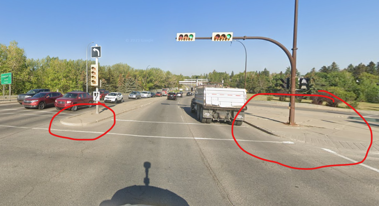

Ramps not aligned to crosswalks. Crosswalks randomly with curbs in the middle. If a person in a wheelchair dared to cross here, they'd have to leave the crosswalk.
Similarly on the east side off Crowchild, but worse. No ramps at all. Isn't there a BRT station a half-block from here? Do we not have rules to create pedestrian access here? It's literally impassable with a wheelchair - even before we get to the high-speed cars turning all over the place!
