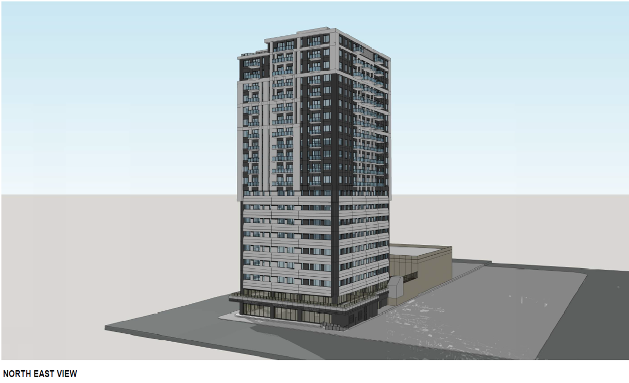

The DP to convert/expand the existing EQ Bank office tower in the NW corner of 12th Ave and 8th Street SW into residential has been posted. This is not only a conversion of the existing 9 storey office building, but then adding on another 13 stories.
This is the building in question:

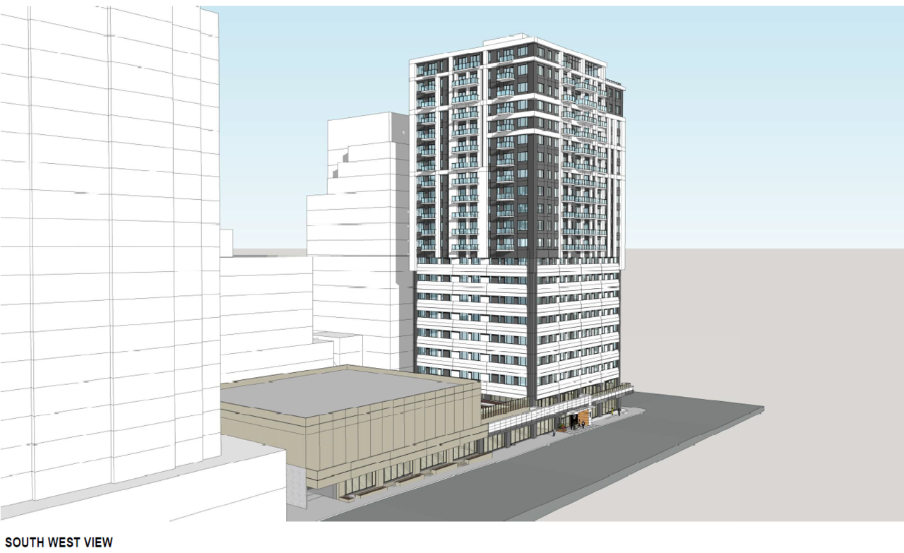

Here is what it is proposed to look like from the DP drawings:
Looks terrible. How difficult would it be to replace some of the exterior on the lower portion to better transition to the addition?
Yeah I'm not sure why they couldn't at least try to find a way to tie the extra floors and the existing structure together a bit better.
Design aside, I'm not sure it's much of a win. I'm all for converting office space, but where it's really needed is in the commercial core. Smaller offices in the Beltline help keep the area and businesses busy during the day. I guess the extra residents in the core is still a good thing though.
Oh, I kinda love it. And it’s in a location perfect for a large residential development, being right next to a grocery store. I’m sure it will turn out hideous, but at this point it’s just like… yes more density please!

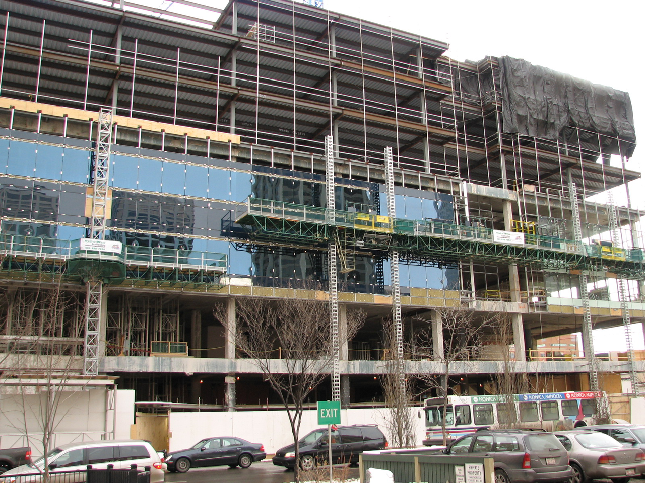

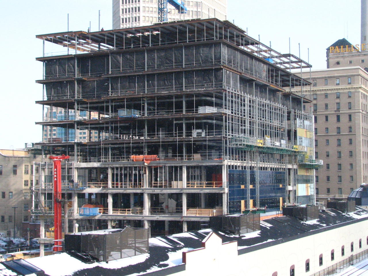

The last time we saw somethign like this (additional floors added to an older building) was Penn West Plaza. Too bad the Streetview time machine doesn't go back quite far enough to see the original, but you can see it under construction in September 2007:
As it turns out I still have some old construction pics from that project
