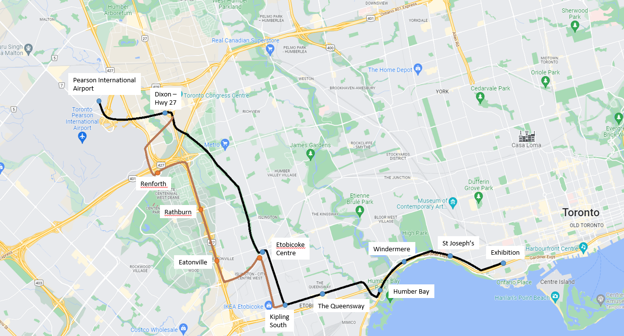

Here were 2 of my options for future extensions of the line. Feel free to critique as required:
I have missed a lot of local stations in the above fantasy map. There's a lot of room for improvement.
This is how I pretty much envision it - travelling west to serve Humber Bay then up along the Queensway to either Kipling or the 427 to serve density appearing in those areas. All mostly elevated / at grade to avoid tunneling.

Thanks for sharing. Could the OL rolling stock make that tight of a turn by Humber Bay?
Honestly don't know what the specs of the OL rolling stock is going to be. But looking at Google, it shows average turning radii of 60 - 80m which would fine in that area. In any case, the line would have to be underground in that area.
