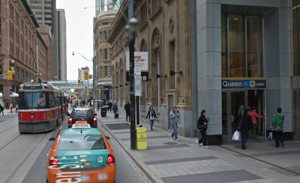

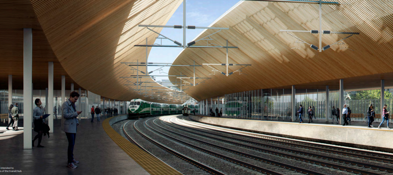

Go back and have another look at the picture I posted of the proposed RLS Gerrard Station. Should we really spend a billion dollars so that people commuting from, for example, Kennedy to Queen/Yonge via GO+OL would be forced to take five escalators each way, every day, just in one station? I really don't think people have grasped how f-cking ridiculous Gerrard Station was going to be, but it was necessitated by geotechnical concerns.
Like seriously.... think about the enormous escalator at this entrance to Queen Station...
.... and then multiply it by 3.

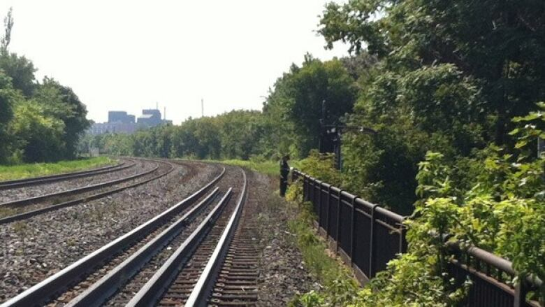

Most of the trees in question are already fenced off from public use anyways. Replacing them with a tall soundproofing wall (something the community has already been asking Metrolinx for), isn't going to ruin the "heritage" of the neighbourhood. Will it change? Yes, of course, but please don't pretend that there is some public service that is being taken away here. Those trees were likely planted with the express purpose of buffering the neighbourhood from the visual sight of the trains. A wall will do that, too.
And besides, there is a bunch of space in some parts of the corridor before the trees:
A good design should be able to minimise the number of trees that would be affected.
Oh, and, where-ever did you get the idea Gerrard, Leslieville and East Harbour stations would have "no weather protection"? It's easy enough to conceive that the Leslieville platforms could be like Davisville with full-size platform screen doors. You know, like the outdoor Montreal REM stations? And, I remind you that East Harbour GO has been planned to be mostly indoors from the outset. Here's one of the most recent conceptual drawings, albeit from shortly before the OL announcement:

Go back and have another look at the picture I posted of the proposed Gerrard Station. Should we really spend a billion dollars so that people commuting from, for example, Kennedy to Queen/Yonge via GO+OL would be forced to take five escalators each way, every day, just in one station? I really don't think people have grasped how f-cking ridiculous Gerrard Station was going to be, but it was necessitated by geotechnical concerns.
Its a very Toronto thing that we assume all transfers must be done by escalator.
Multiple high-speed, high capacity, fully automated elevators would work fine.
The trees weren't planted, with the odd exception where a backyard come up against the ROW, the vegetation is all seeded in. The odd 'good' tree; but mostly non-native invasives.
However, they do serve to meet the City's Tree canopy goal and combat climate change; their removal can't be offset without adding back similar numbers of trees; this would require considerable property acquisition.
The trees also serve to provide some shade next to abutting public parks; and are broadly visually pleasing in a way that a noise barrier will not be.
The render you're showing is based on a 4-track configuration.
It is certainly possible they will do that with six tracks, though it isn't likely.
PS, that opening in the middle is still large enough to let in a fair bit of rain and snow; and certainly won't keep the platform a nice temperature in winter.
