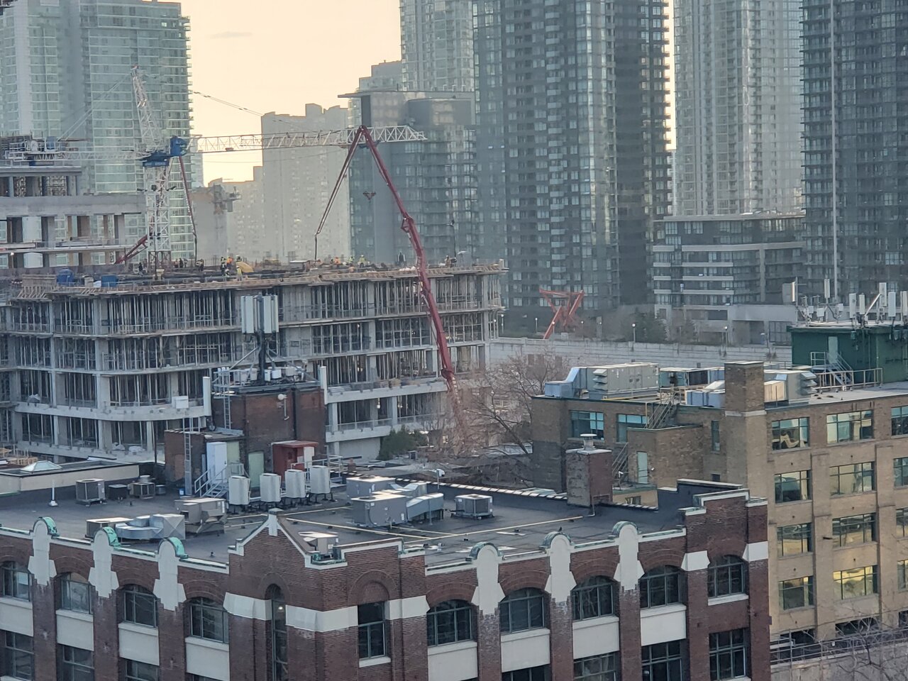

From Tridel on Thursday, April 8. Presumably for a transfer slab on Building 4.
The Well – Concrete Pour This Saturday​

On Saturday, April 10th, our teams are scheduled to pour concrete on site beginning at 6:00 AM. We anticipate the pour to be complete before 6:00 PM.
You may experience increased activity on Front Street as trucks will be delivering material to the site. There will be increased traffic control personnel stationed at our gates to help with the direction of vehicle and pedestrian traffic.
What's a transfer slab?
A good explanation in the link provided by CheterCopperpot above.
There are multiple transfer slabs in The Well complex - some of which are still visible in photos being taken now. In the photo immediately above, the two buildings to the right (east) of the one where the pour is taking place today, each one has a visible transfer slab. The slabs are where the set back are from the commercial floors below the slab and the residential floors, just starting to be built, above. The slabs look to be around five to six feet thick. The structural load bearing columns for the residential floors do not line up with the structural columns for the commercial floors below them. The transfer slab is built to handle moving the load from the upper set of columns to the lower ones.
Other transfer slabs are located in the below grade areas of the complex, above the service / truck access driveway makes its way through the basement. Given the width of the driveway, transfer slabs are used to provide a clear span across the drive ramp while supporting the load bearing columns in the commercial areas above.
