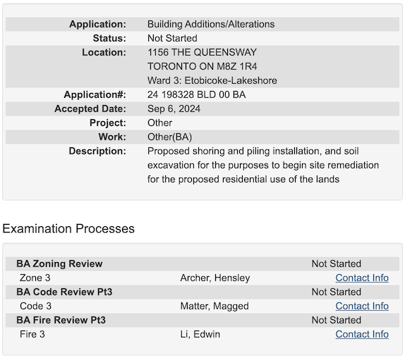

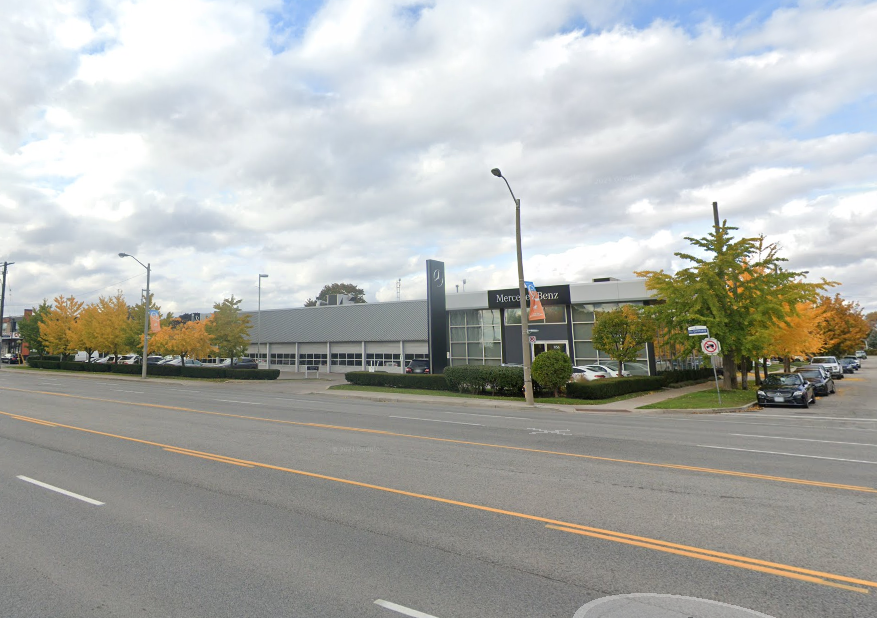

New application into the AIC for the current Mercedes dealership on The Queensway. Interestingly, no ZBA here, going straight to SPA w/ Minor Variance.

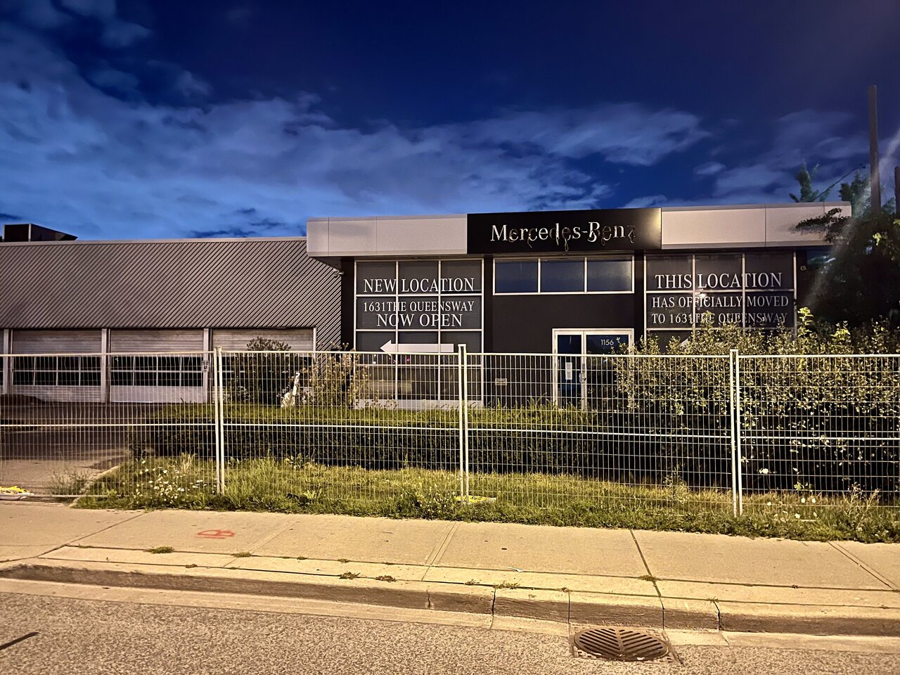

Site as is:

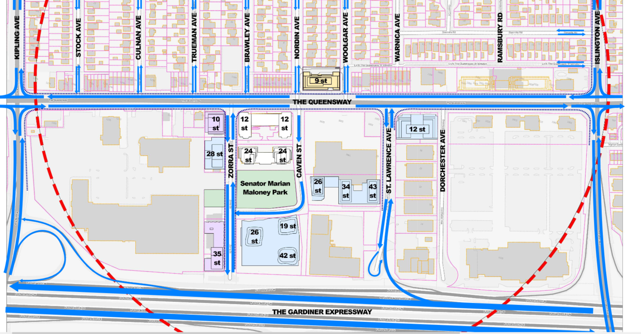

Block Context Plan:

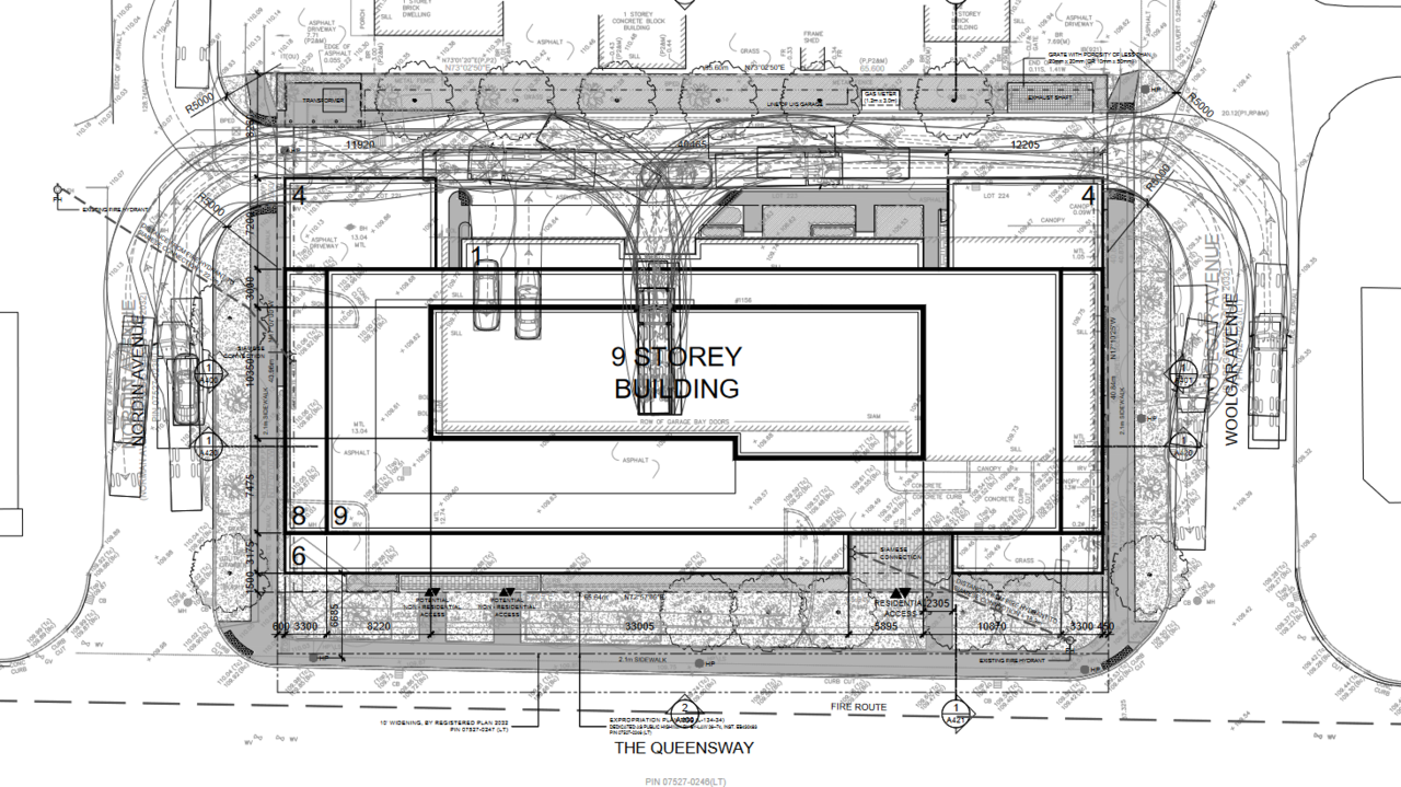

Site Plan:

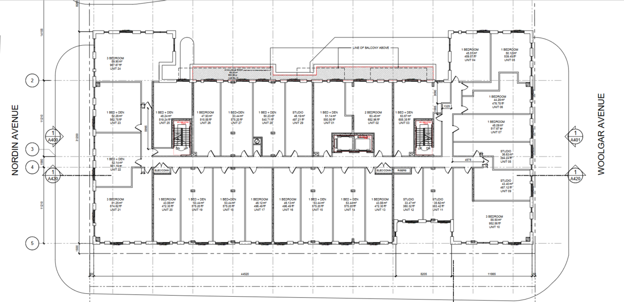

Unit sizes/layouts - uhhh, uhhhh

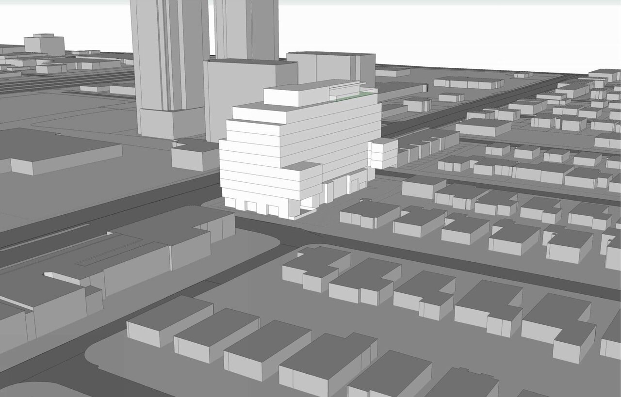

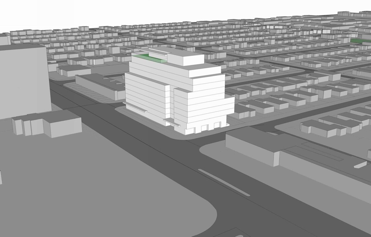

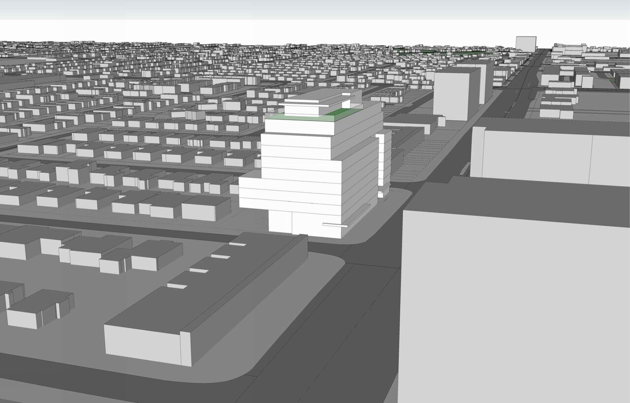

Comments: At first blush, I wanted to say some nice things....... I mean the height ask is very reasonable, and for CORE, the building appearance is..... bad, the building is well within precedent and this is certainly a more urban site use than what is currently present.

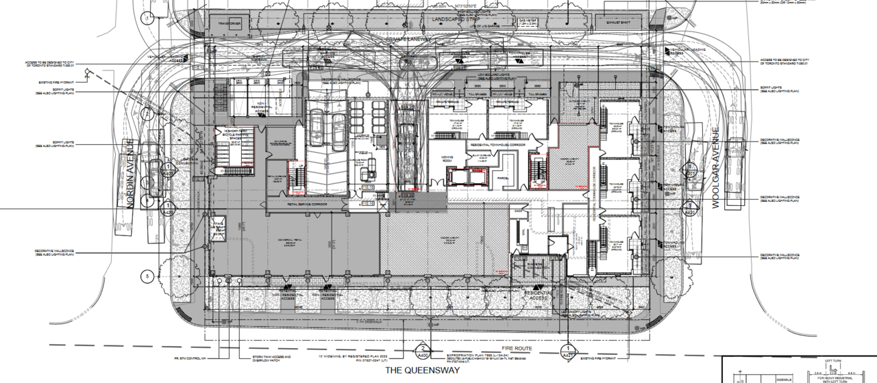

But then we get to a few problems....... badly configured retail, and indoor amenity spaces facing The Queensway at-grade.
On that point, the extensive use of at-grade townhomes contributes to a contrived ground floor layout as does more, separate indoor amenity space at the rear of the building.

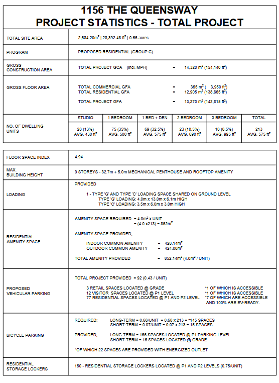

Thereafter, there is the matter of problematic unit sizes and layouts, heavy on shoe boxes (can't say investor boxes if they're purpose-built rental) ........we see 1bdrm units, - not studios at sub 500ft2, not ok.
I wonder if they're thinking of this serving the students at Humber College south campus? I can't otherwise explain the unit size/layouts.
The elevator ratio does pass muster at 2 elevators for 213 units or 0.94 elevators per 100 units / 1 elevator per 106.5 units
77 resident parking spaces is a reasonable ratio for a site that is not all that close to rapid transit. 0.36 ratio.
Required, vast improvements in ground-floor layout, re-think everything, consolidate indoor amenity at the rear 1/2 of the ground floor and/or move it up one level.
Larger, better laid out units, accurately represented (call a studio a studio.

Yes that residential entry should be moved onto Woolgar Ave, eliminating that corner townhouse unit in order to expand that retail presence on The Queensway. I dont know why they're afraid to have more retail on this front, with the increased density coming along this area it would do well eventually. The unit sizes of the retail are also questionably small and would it much better if re-thought the demising.
I find the scale of this excellent, while the materials look pretty decent. Purpose built rentals are great for this site, but those unit layouts are atrocious. There should be a bigger push for 2 and 3 bedroom units here and I would find it comical if they are looking to serve Humber College students, I dont think that would work out particularly well for the proponent here at all.

Are you asking for the current FSI? Its 4.94
