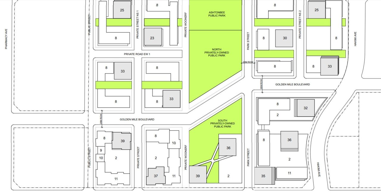

Off the bat.........I have no idea why 2/3 of the parkland is labelled privately owned, that's got to go. POPS are fine, but I want my parks public thanks.

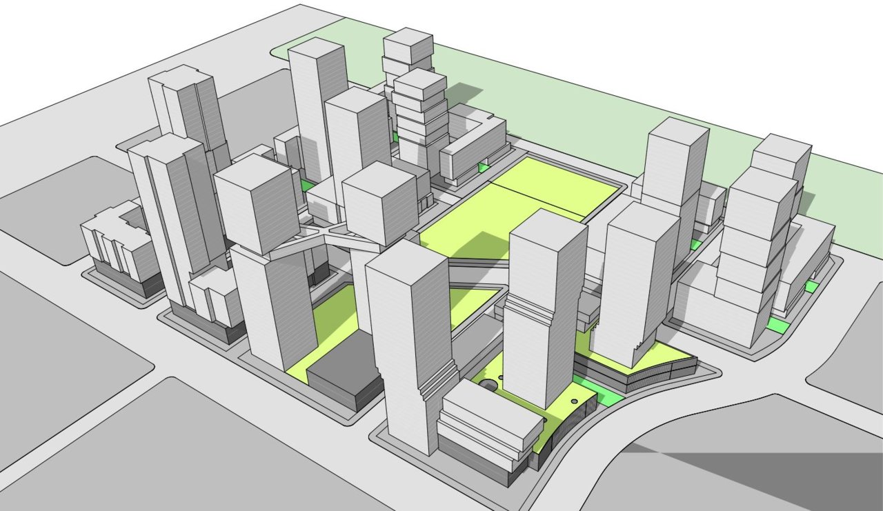

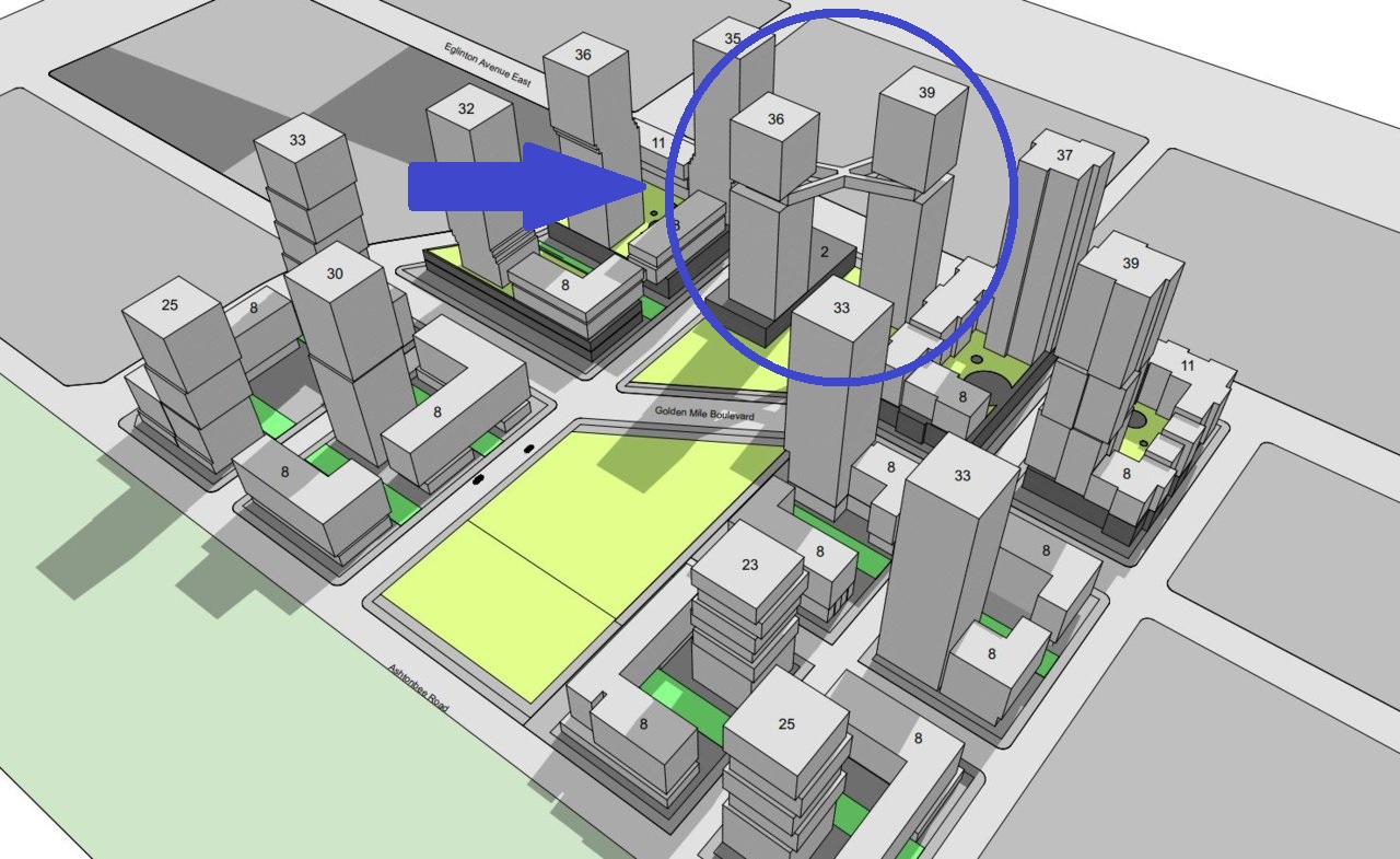

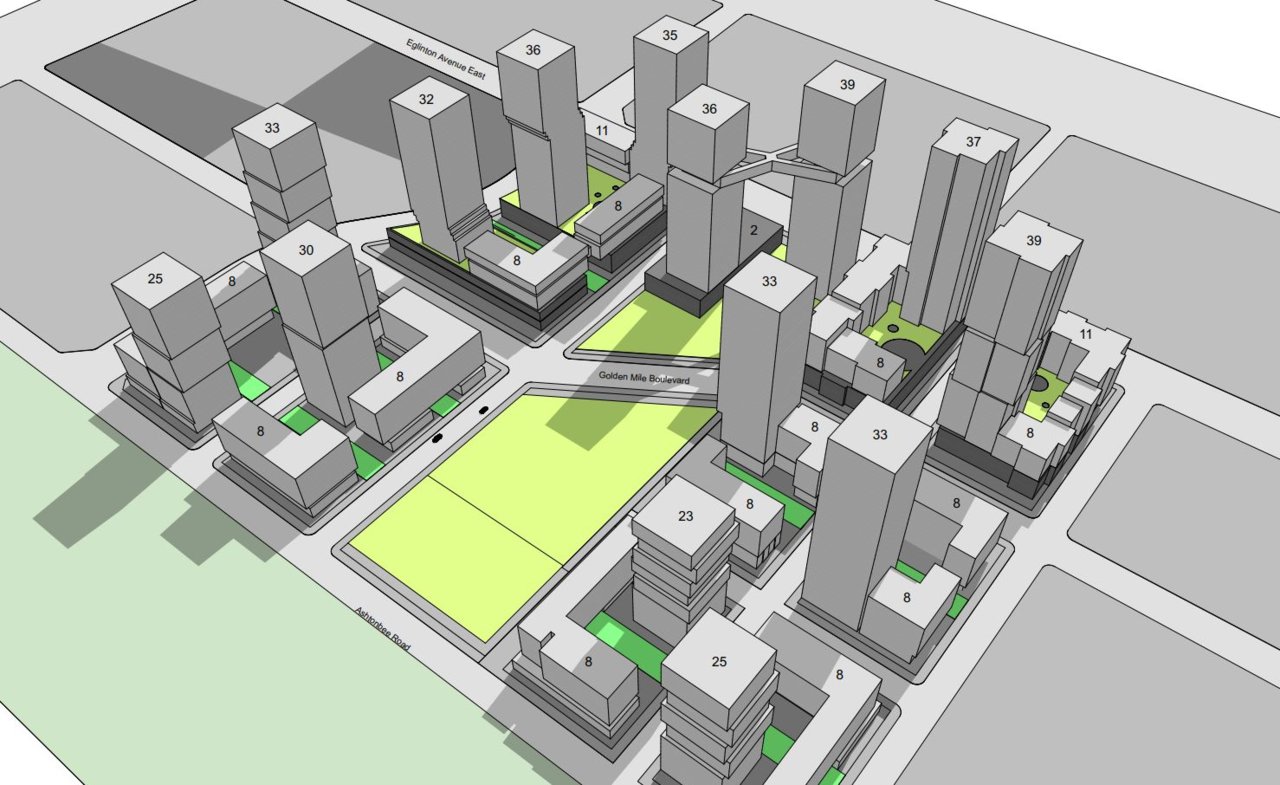

Also the conceptual massing along Eglinton is gross. Its a wide road, and a tall streetwall would be perfectly appropriate. But some human scaling is required.

I see courtyard blocks... this is very good. Hopefully those green connections that link the courtyards together stay in the plan as well.
The density along here is crazy for what is really just a relatively low capacity in median LRT.
I agree. I think for median LRT this far from Downtown predominantly mid rise maybe 8-11 storeys with a few towers at the LRT stops would be appropriate. With some of the proposals that have been submitted it looks like this area will just become a sea of high rises.
