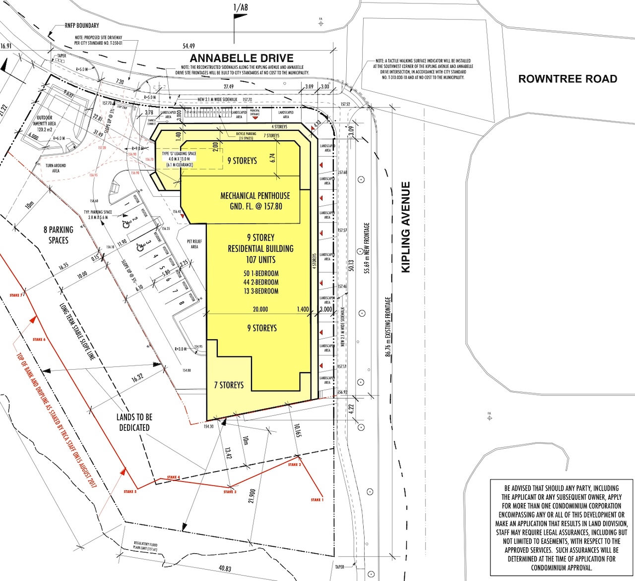

In the image below, you see an orange-shaded area, which is the existing flood-risk designated zone:
The narrower red lined area represents the reduced flood risk area after improvements.
You can see that currently the entirety of the subject lands are within the risk area, while post-improvement only a few metres are the rear of their property would remain at risk.
