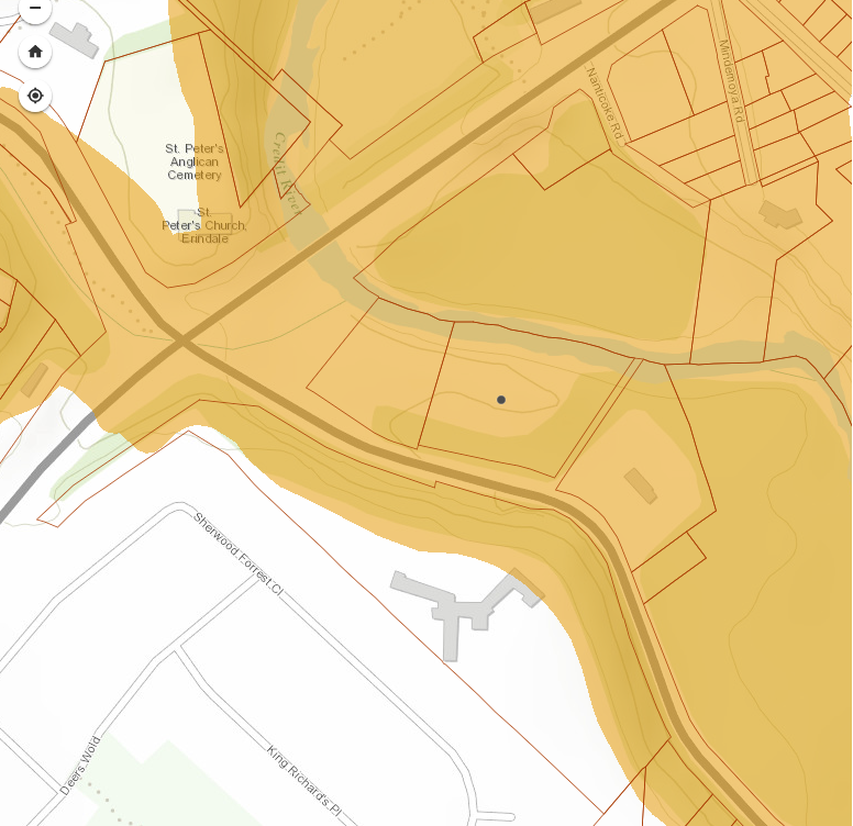

I imagine there's a reason this site has been vacant for years, is there no flooding concerns here with the Credit River literally next door?
The short answer is 'yes'...............but the long answer, not really.
Regulatory Floodplain Map, for this area, flood risk in orange:
The dot is 2935 and 2955 is the next property north.
However, the proposed buildings themselves are not at risk.

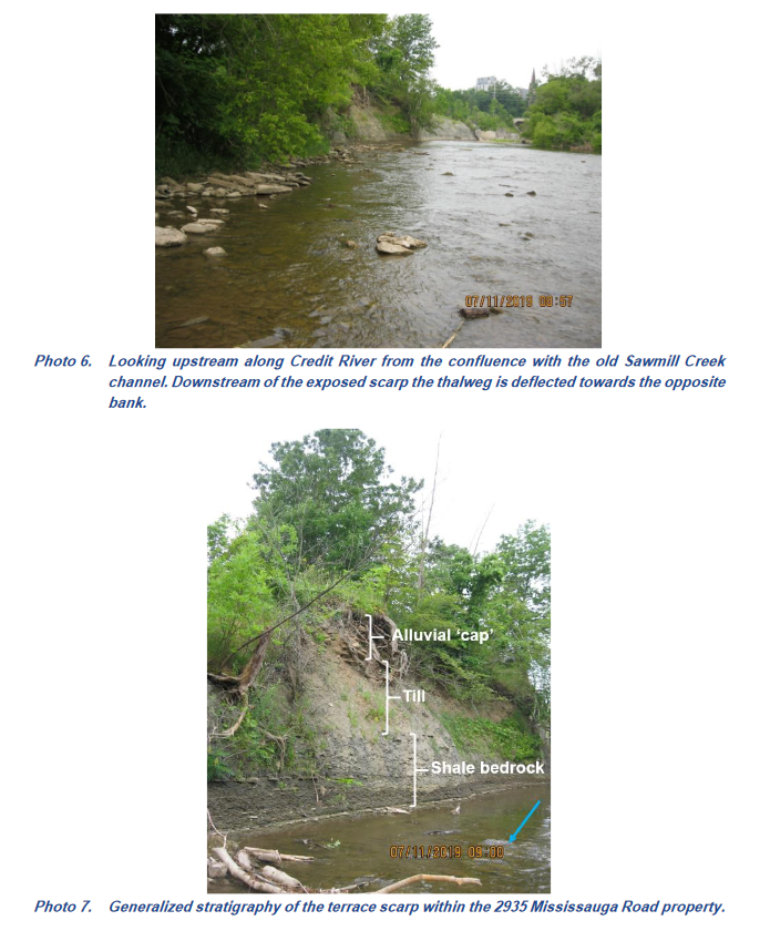

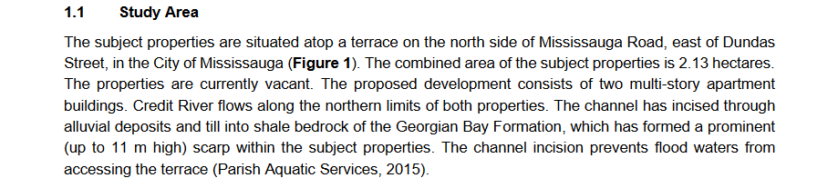

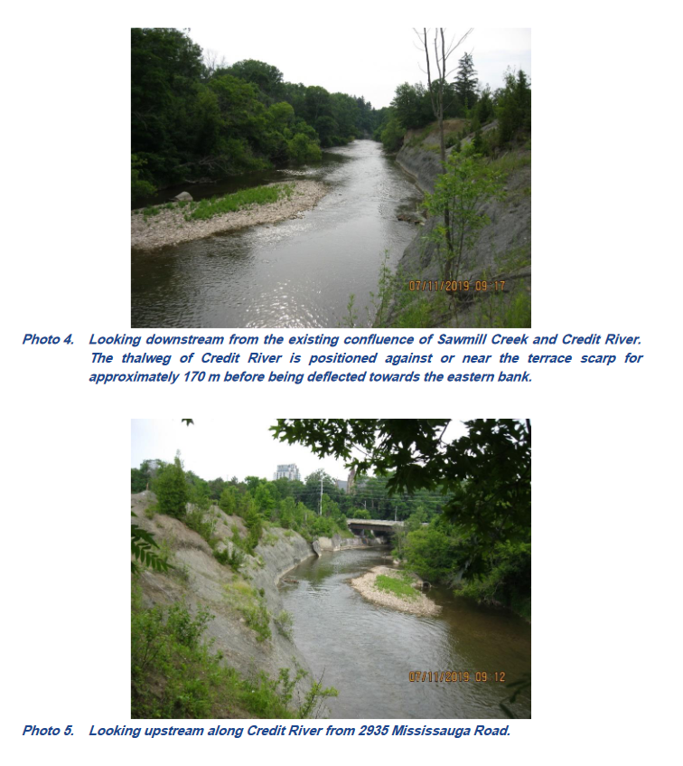

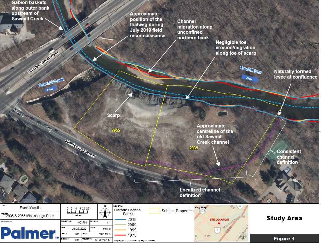

Let me quote the Geomorphology report for the reasoning:

what is this rectangular structure circle in yellow (right above the word approximate)
is it abandoned pool
i look at aerial shots rom 1952 and still cannot figure out
