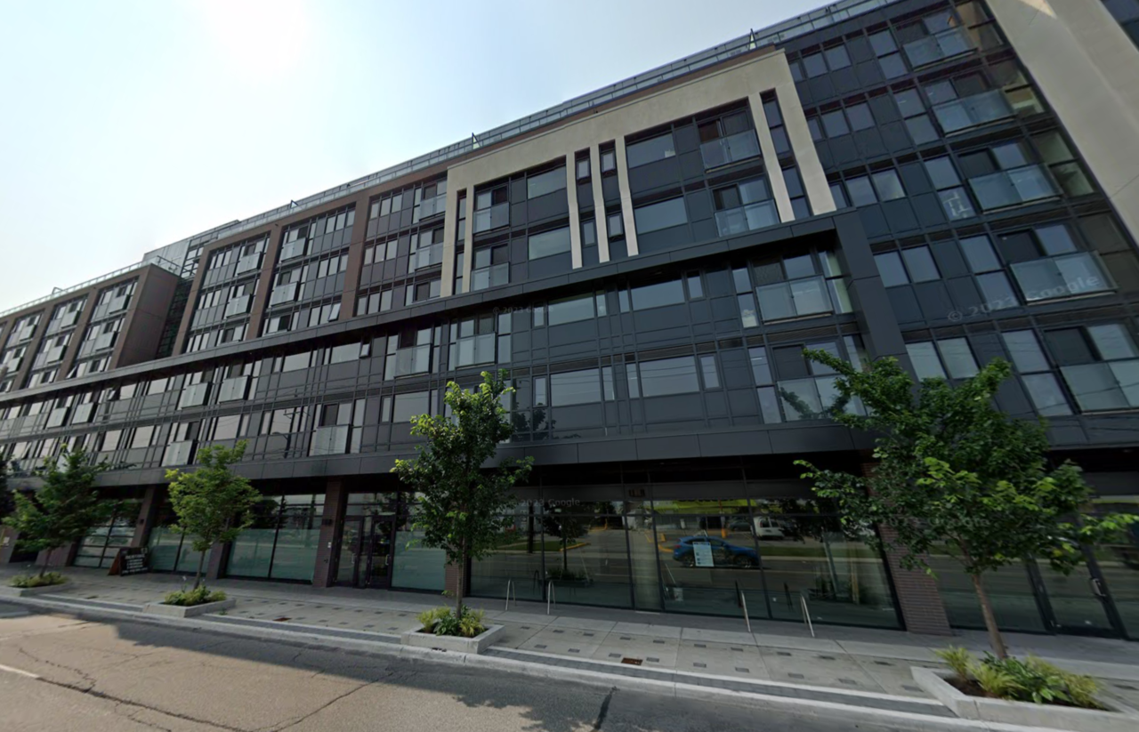

Ah Yes, Terra Firma... Builders of the architectural marvel that is Junction Factory just west of this site. Hopefully they will do rental again.
Aesthetically pleasing it is not. But the massing and scale are perfectly workable for the area. The cost to do just a bit better on the facade treatment and grade experience would be marginal.
Double the width of the brick columns at grade, create a proper signage band, lose the overhang, lose the would-be juliet balconies, extend the brick columns straight up, none of this offset garbage, enlarge the residential windows vertically, and you're most of the way there, minimizing the spandrel on the podium is key, and where present make it as black as possible with a good contrast from the brick to make it look intentional as a design feature, rather than a bug.
The nixed 'balconies' actually save some $$, the extra total spend shouldn't even be 1% of the project's all-in budget.
