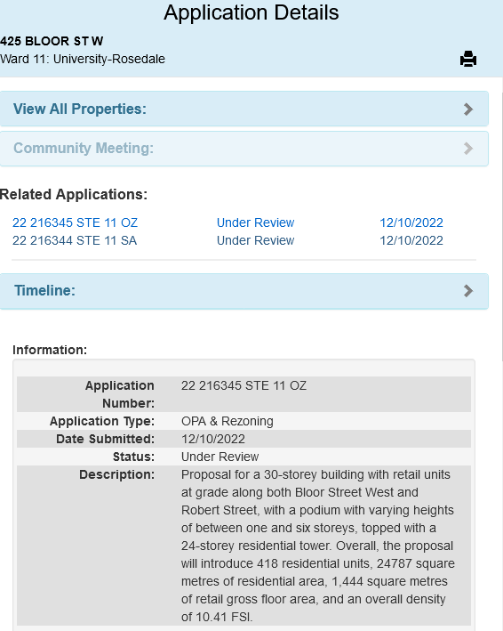

I have been expecting this application for awhile, having hinted at it elsewhere...........but it now arrived in the AIC.

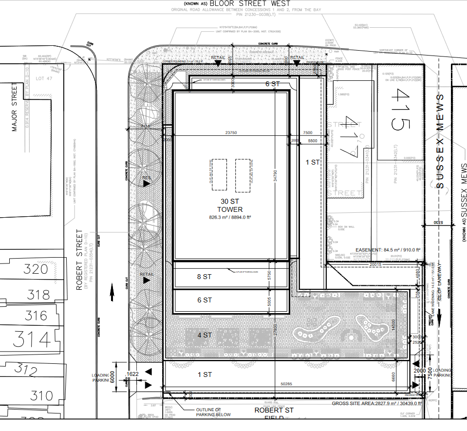

The proposal to redevelop the Metro supermarket at Bloor and Robert, just west of Spadina on the south side.
Site as is:
Application:
From the Docs:
North and East elevations above

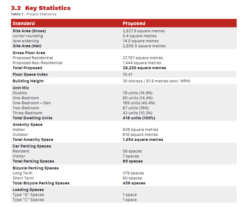

0.14 parking ratio

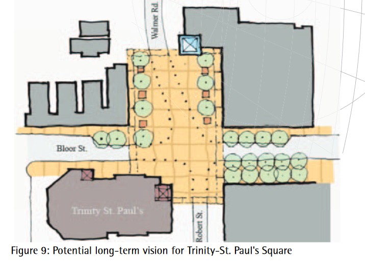

Now for a bit of throwback, this site was first evaluated by the City for its potential in the Bloor Street Visioning Study in 2009:
In that study, we find this image:
and this one: (oddly for the same study, if you look carefully you'll see the Bloor frontage of this site represented differently from the above)
Also from the plan:

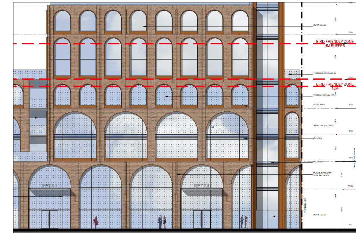

The architecture, shows some aspiration in respect of using brick and making use of arches; though I'm not entirely convinced it comes together as it could/should.

This development seems to look real nice having the precast brick column and arche cladding. Complimenting that punctured window look right to the top of the facade. Which is quite rear in the downtown core with new towers.

Well. Iā€™ve been waiting for this for four years since debating the highest and best use with Metros reps who were claiming it had no better use than the grocery. This density is a bit higher than we predicted though even then, although we were being conservative in our estimates. At the time I was using the apartment behind this to the north of Bloor as a density comp, as well as the newer tower on Spadina a bit south of Bloor. As always, one would expect this to be a starting point for negotiations, with the density to decrease from here somewhat.
EDIT: Actually scratch that, I estimated exactly 10x density here. Not too shabby, if I do say so myself.
