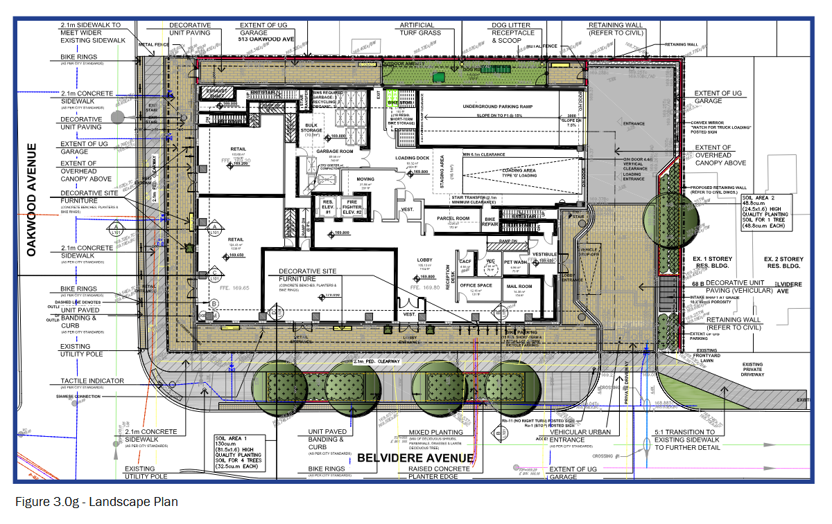

No trees proposed on the Oakwood frontage is non-starter.

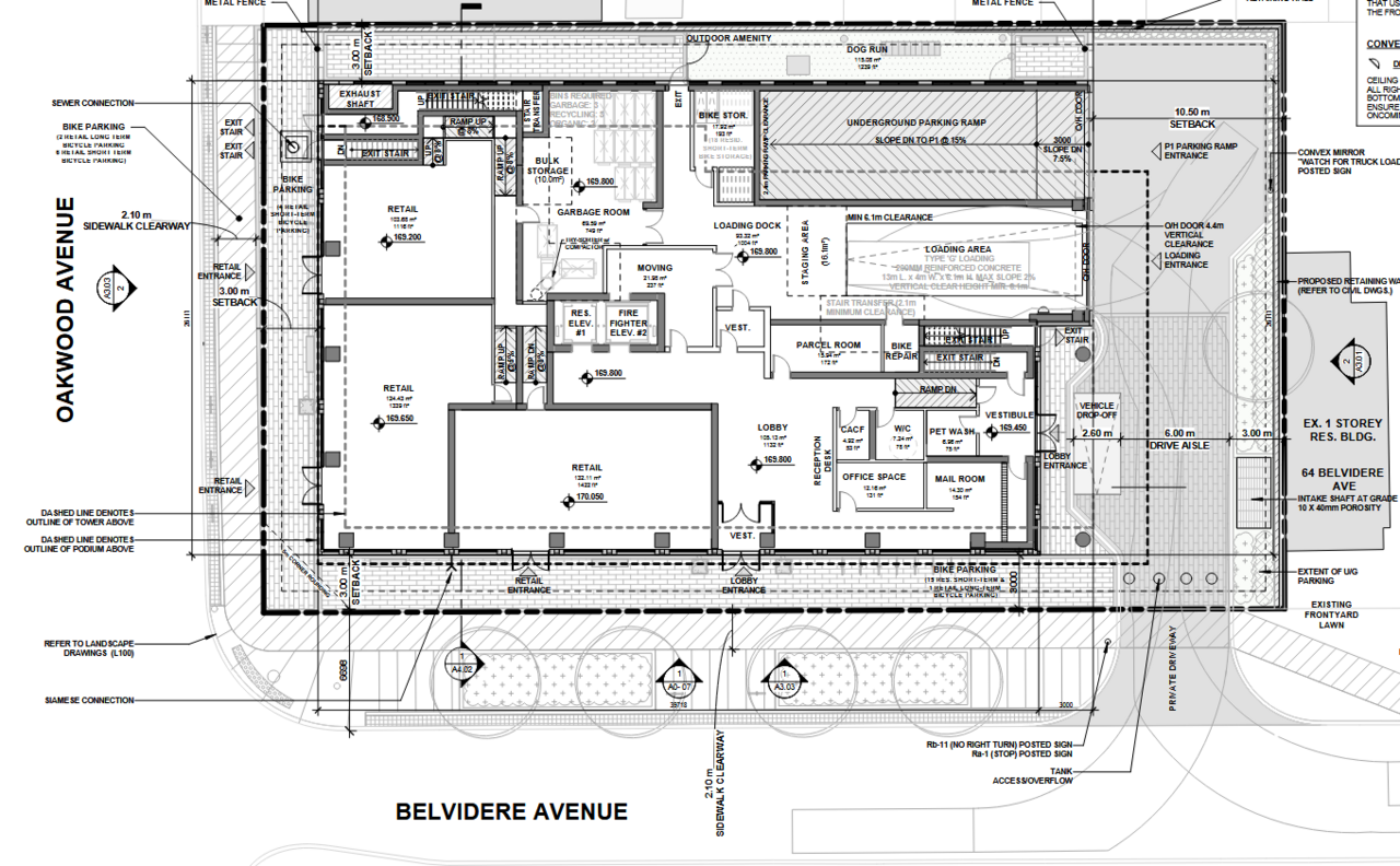

Elevator Ratio: 2 elevators - 161 units or 1 elevator per 80.5 units
Parking: 84 spaces - ratio of 0.5 (not super high, but high for a site relying on a PMTSA designation)
