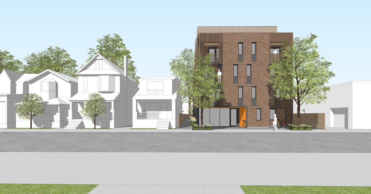

So, here's the thing.........its SuperKul; and they've changed the concept to 6s. + ancillary buildings
Lets have a look:
Now an aerial perspective that shows the shorter ancillary buildings located in the interior of the site:

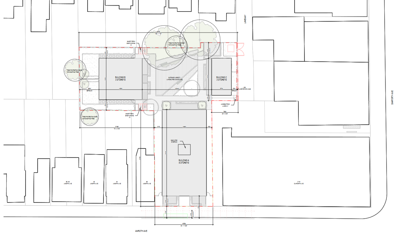

Site Plan:

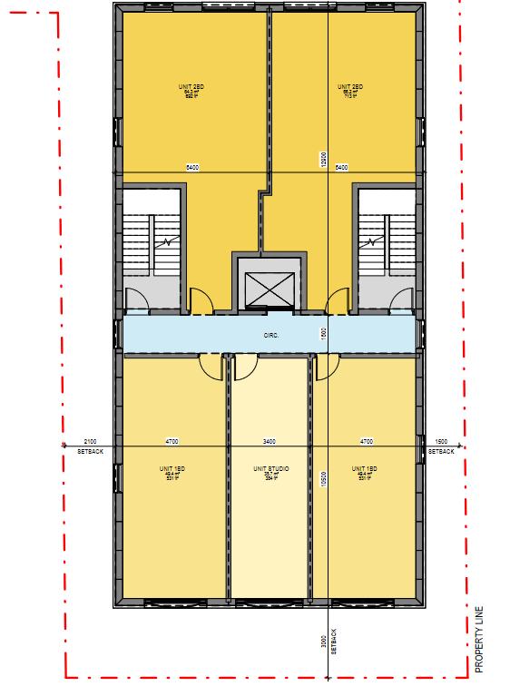

Upper Floor layout:
Comments: I support the idea, but there are issues here.
There appears to be only a single elevator in a 6s building. Should that elevator break/need to be replaced etc etc......do we expect someone to walk up/down 6s? How does that work for a resident with a mobility aid? To be clear, this actually complies with code, but I see it as a real problem. Having had a parent who was on a second floor, but after a stroke, and with COPD, required a mobility aid, I'm concerned about trapping people inside or outside their units.
It might be one thing to take that as a managed risk in a 3s or 4s building, but at 6s, even able-bodied people may be plaintive at having to walk up 6s regularly.
Of note, the 2 shorter buildings (3s) do not have elevators provided, they are walk-up. I think at 3s that is more reasonable, though it obviously precludes anyone with a mobility aid from even visiting said units.

I'm not sure I like the way they massed this really, the open space at rear is curious here, it gives up a lot of ft2; you could transition to the lower height in the interior but still do one connected building; though it would require a very different interior layout. This might be easier to do well if they just bought the property to the south on Amroth, which, I grant makes this more midrise than missing middle...........but there we are.

I do agree that open space at the rear looks far too large and wastes valuable square footage. The floor plans here provide further evidence of how the requirement for two sets of stairs wastes so much space, lowers floor plate efficiency and results in worse unit layouts. Single-egress reform cannot come soon enough!!

I'm open to discussion on the two points of egress, though I expect a robust fire-suppression system in exchange. But as I feel 2 elevators is essential, I think that change would take up most of the space saved by canning a second set of stairs. That's why the footprint needs to be re-thought.
If you widen the frontage on Amroth by even one property, then kibosh the weird open space and or shift it to the south (so as to have one contiguous building here) then it becomes viable to reorganize the layout and make it work.

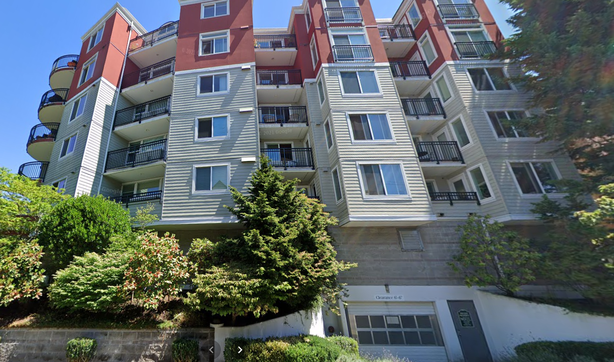

I get that such a thing exists; I don't agree that its viable as a widespread model.
Its not widespread in Seattle despite being more than six years since completion.

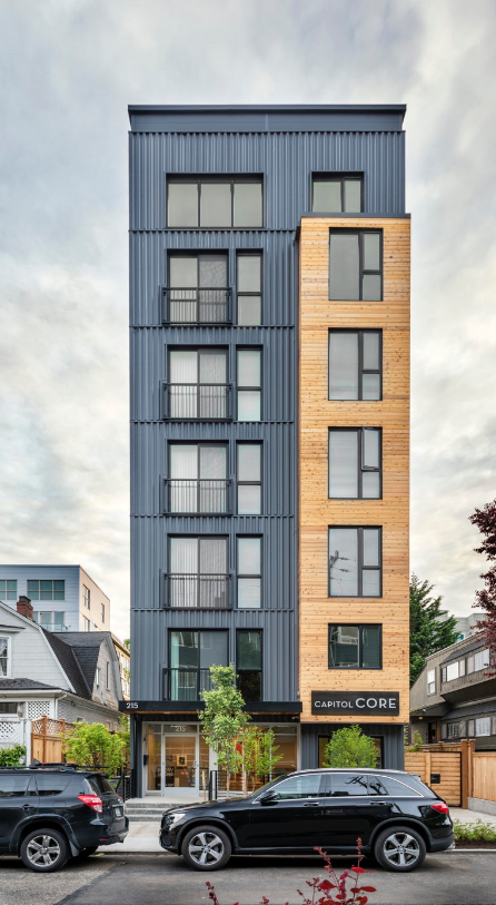

I notice, PE that you chose not to mention what the area around this building looks like.
Let me:
Across the street:
Hideously ugly, 4-storey townhomes pre-date this building.

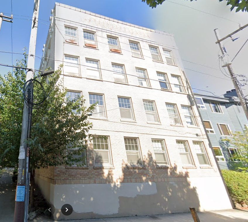

This is the other neighbour to the side: (also pre-dates the Capitol, and is six storeys)
This is on the same street, just 1/3 of a block up:
This is the next street over (which Capitol backs on to)
Every SFH in this set of blocks is being removed.
Context matters. That can't be replicated in most areas.
