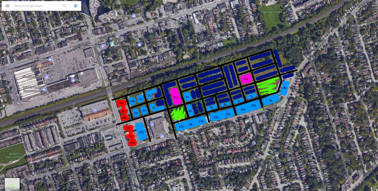

It is a very large site, and with the Growth Plan, it seems like an ideal place to put some dense low-rise intensification along with some mid-rises right at Victoria Park.
So I took a little interest in this fascinating site and spent a half hour coming up with a site plan of sorts. At the end of it I figured I may as well not let the work go to waste and decided to post it:
Street Pattern - Purposefully laid out to discourage through traffic on side streets (safe for kids to play!) while maintaining connectivity and to allow for dense grid. Setback 30m from rail corridor as per the law.
Red - High rises
Light Blue - Mid Rises, some of the smaller ones are multiplex style walk-up apartments.
Dark Blue - Townhouses, all townhouses. With growth projections and a fresh new site overseen by BuildTO, I saw no reason to compromise on low-rise density with semi-detached and detached houses.
Pink - High School and Primary School. Hopefully there is a Middle School nearby.
Green - Public Park
FreshoCo - I didn't propose a development on the Freshco, minus their parking lot. I figured that the area needs a grocery store (and I was completely oblivious to the Loblaws on Victoria Park). This parcel could be developed eventually however.
Transit - I figured the nearby Birchmount bus made no sense looping up Warden. Send the Birchmount bus down Hollis Ave, then Clonmore Dr, then finally either Gerrard St or the new middle street in the above site plan and then up Victoria Park to the Line 2 Station.
My rough density calculation:
Townhouses - Average width of 25ft and depth of 80ft. I got about 7,850ft of townhouses if I lined them up side by side, so about 314 townhouses. That is fairly high 25 unit per acre. Nearly 1/3 of them will be stacked townhouses, so we can make that number a round 400 units. Average household size is 2.8 persons, for total of 1,120 persons.
Midrises - Lets say that 10s midrise complex on a 1.5 acre plot of land is roughly 175 residential units. We got roughly 10 acres of that built form which roughs out to being 1,750 residential units, which with an average household size being 2.8 persons for a total of 4,900 persons.
Highrises - Using similar density to the midrise but accounting for higher storeys, you get 525 residential units, which with an average household size being 2.8 persons amounts to 1,470 persons.
Added up, that is 7,490 persons in 2,675 dwelling units.

But beyond that, this giant parcel of land in a shoulder area of downtown, and all they decide to propose here is 300 dwelling units? I put 9x that number in my half hour sketch above!
This little exercise of mine just goes to show exactly how ambitious the City of Toronto is with actually fulfilling our Provincially mandated growth targets. Not ambitious at all. :rolleyes:

Definitely not enough greenspace. I like the small block plan. I don't no how the northern connection to VP beside the rail corridor wouldn't end up a disaster. The building heights are on the tall side. Forget appropriateness. What's the appeal of plopping a row of 25 to 30 storey towers along VP? I think up to 6 storeys along Gerrard is a better height in providing higher densities and also compliments the lowrise community to the south.
I unabashedly went for maximum density to see how much I could fit in to the land area. I agree, that in reality nothing that dense should be approved and many storeys should be shaved off all around the site. You are right, that road along the rail corridor shouldn't terminate at Victoria Park now that I think about it.
The appeal of highrises along VP is simply that you can. It is zoned Commercial Residential, the towers on Victoria Park north of the subway station are in some cases over 100m, and we won't have shadowing impacts on the surrounding residential area. Assuming the Relief Line gets built, I don't see the issue with allowing towers along Victoria Park, they would be serviced by both the Victoria Park bus and the Birchmount-Gerrard one I rerouted.
The midrises along Gerrard followed a simple formula. How much height can you get out of them given the public ROW on Gerrard? I determined the ROW is 20m, which gives us roughly 6 storeys, then added 4 more for developer concessions. (Thinking about the typical midrise proposal around the city), then squeezed a bit more along the western side for smoother height transition with Victoria Park and since this is a blank slate.
Rather than being lost in the details, I think the point could be better stated as, we can do a lot better than tower-in-the-park, and 300 dwelling units in a site this large is pretty abysmal considering the projected population growth in this region and the provincially mandated Growth Plan targets that we must comply to.
