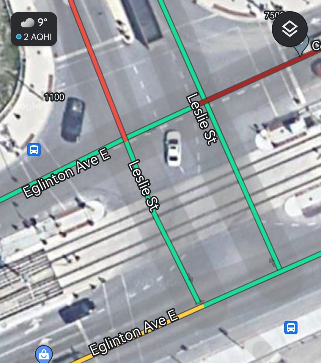

Yesterday I was riding the motorcycle eastbound along Eglinton. At Leslie St., a southbound car turned left into the Crosstown tracks, coming to a stop before the road surface fell away to bare tracks. The car then reversed out of the tracks and carried on east on Eglinton. I was immediately reminded of both: Queens Quay where car drivers were turning left onto the ROW or going down the tunnel to Union Station; and of Murphy’s Law, where if we enable the wrong choice it will be taken by some car drivers.

I wonder why they don't paint the turn path guides (lines) across the track bed?
Maybe they will when they finish and open the Crosstown in 2025. But paint didn't stop drivers entered the Queen Quay tunnel. Instead we needed hardened barriers.

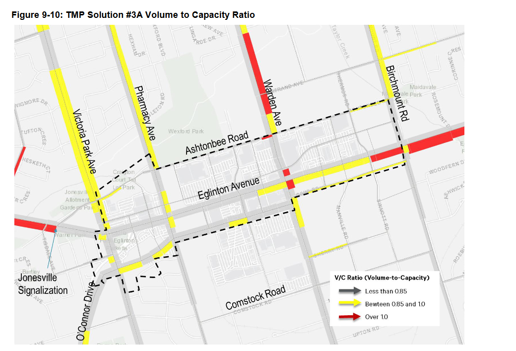

No, not if I say so; if all the traffic impact studies submitted with the associated development along the Golden Mile say so, which they do, and those have been published here, along with the Golden Mile Transportation Masterplan.
Red is over capacity, in the preferred build-out scenario:
(two variations)
Source: https://www.toronto.ca/wp-content/uploads/2019/11/97a2-CityPlanning_GoldenMile_TMPDraft_Part3.pdf

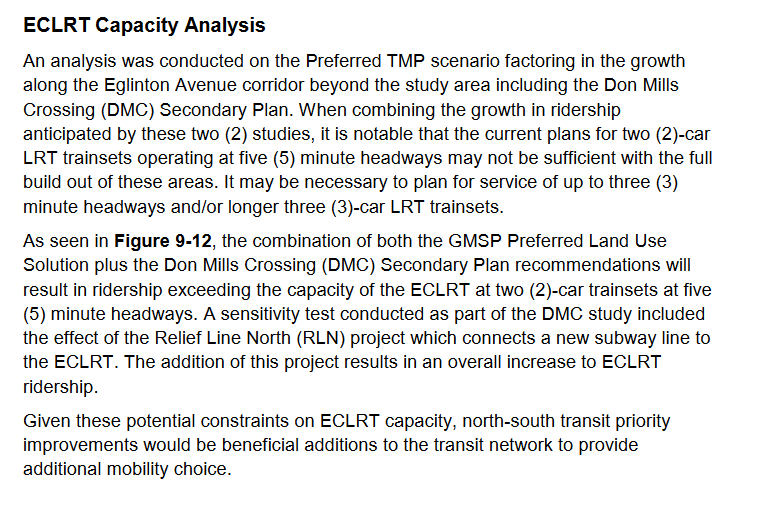

Further, from the above:
* before you say...... but we can have shorter headways.............. Nope, we can't, because the service has to interleave w/the short-turning service.
Ah, but you say, we can run ALL the service out to Kennedy. Nope, can't do that either as this would reduce the headway in the central section of the line.

The problem is greater than I thought. However, can think of a few ways to meet the demand, short of stopping the LRT service for several years in order to build a new tunnel.
1. The report mentions that "the current plan for 2-car trainsets on 5-min headways may not be sufficient", and "it may be necessary to plan for 3-min headways and/or 3-car trainsets".
Which means, 3-car trainsets might be sufficient to handle the demand, without changing the headways.
All underground ECLRT stations are built to be easily convertible for 3-car trains. For the surface section, there may be some challenges, particularly fitting the platforms for 3-car trains. But if there is a pressing need, then it should be doable, for a small cost and relatively quickly.
2. The 4 major N-S bus routes through the area are shown to be near or above capacity north of Eglinton, but below 85% south of Eglinton. Looks like an opportunity to run more buses during the peak, between Eglinton and the closest Line 2 station, to divert some of the demand there.
3. The Eglinton bus. Could run a short-turn peak-period branch #34 between the Science Centre and Kennedy, stopping more frequently than the LRT, and thus diverting some of the riders. Obviously, the bus capacity is a fraction of LRT's. But if the LRT on its own is only 10% above capacity, not 50% above, then the bus can help bring the demand just below the limit.

Wait, who said the current platforms don't fit 3-car trains? All platforms (surface and underground) are around 95 metres long and there will be a 1/3 unused. It's not even walled off unlike Line 4. Hope people don't stand in the wrong place.
I highly doubt people will prefer to transfer to Line 5 over Line 2 unless buses terminated at Eglinton. Unless line 5 has significant travel time savings. They won't likely get a seat in rush hour if they transfer from Line 5 to the bus. So downtown to Scarborough trips will default on Line 2.
As traffic worsens from intensification, you'll have to pay people to take the local bus to get stuck in traffic.
