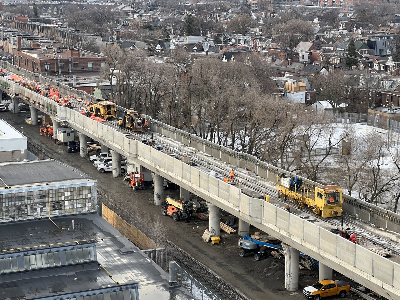

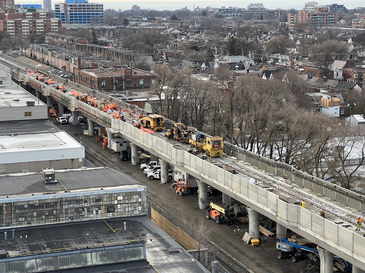

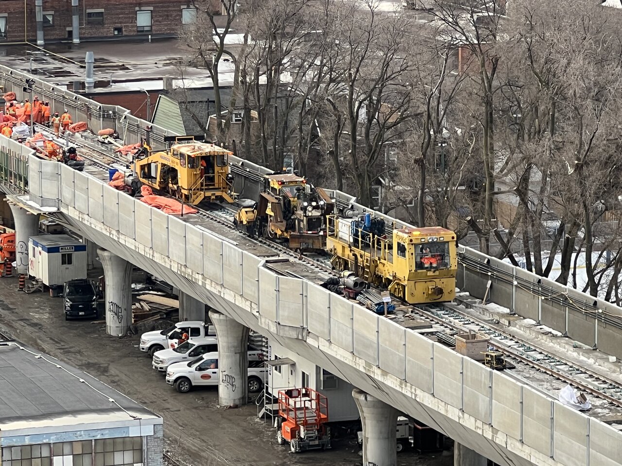

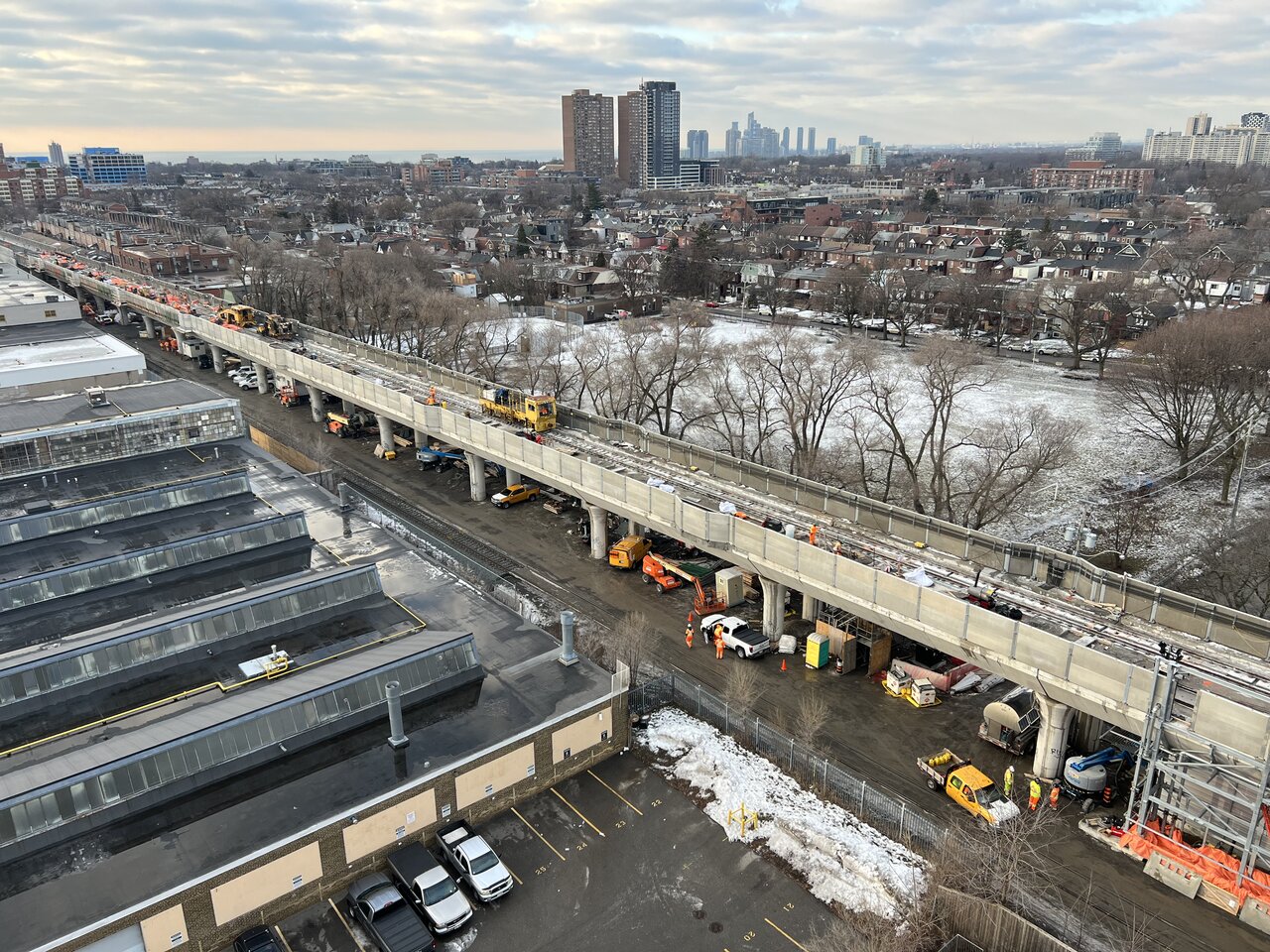

First time these guys have been this far south:

"Completed" is a very long term thing. It will be "opened" with just the one track, and no catenary.
Those machines look like they are just checking clearances and tolerances while waiting to be able to reach the south slope where the ballast starts. Their job will be to tamp the surface on the ramp going south from the end of the guideway.
I am speculating that the orange tarps are covering the last stretch of concrete pours for the plnths, which then have to be bored and the track fasteners inserted. It also looks like there are bolts waiting for a second guard rail (hard to tell, but the first guard rail may already be in place, or maybe it's just the side of the plinths that I'm seeing). Lots of unfastened bolts in the plinths at the north end within the guage - which hints that the guard rail(s) is yet to come.

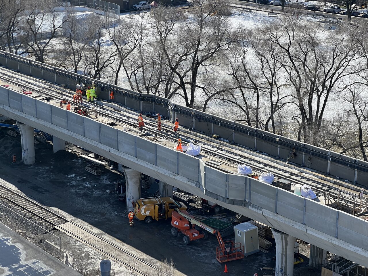

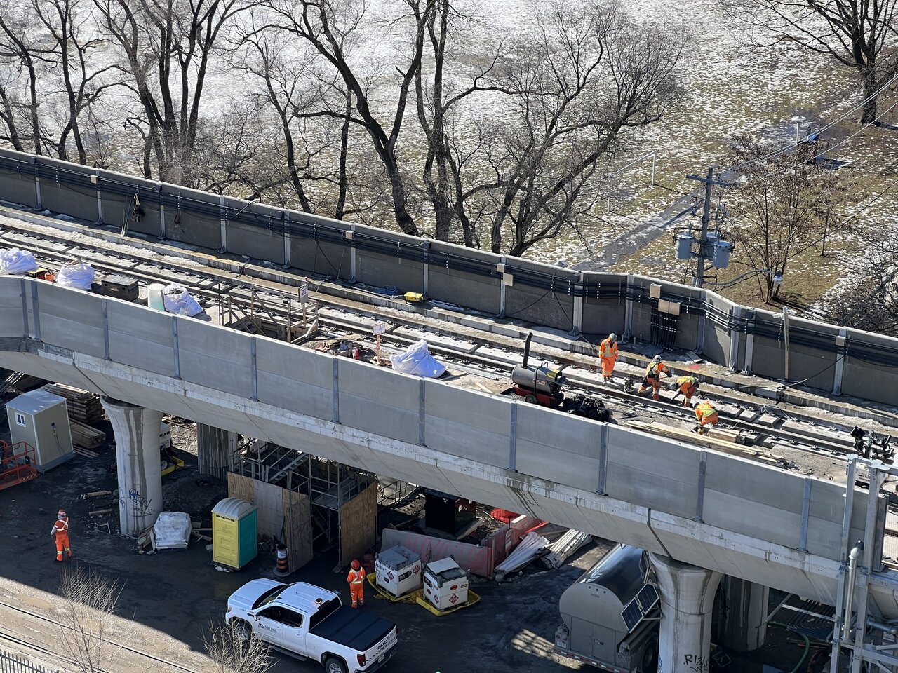

Correct, Paul. They didn’t linger on the guideway, and pretty quickly moved south of Wallace to start work there. Here are some detail shots of what’s currently happening up top:

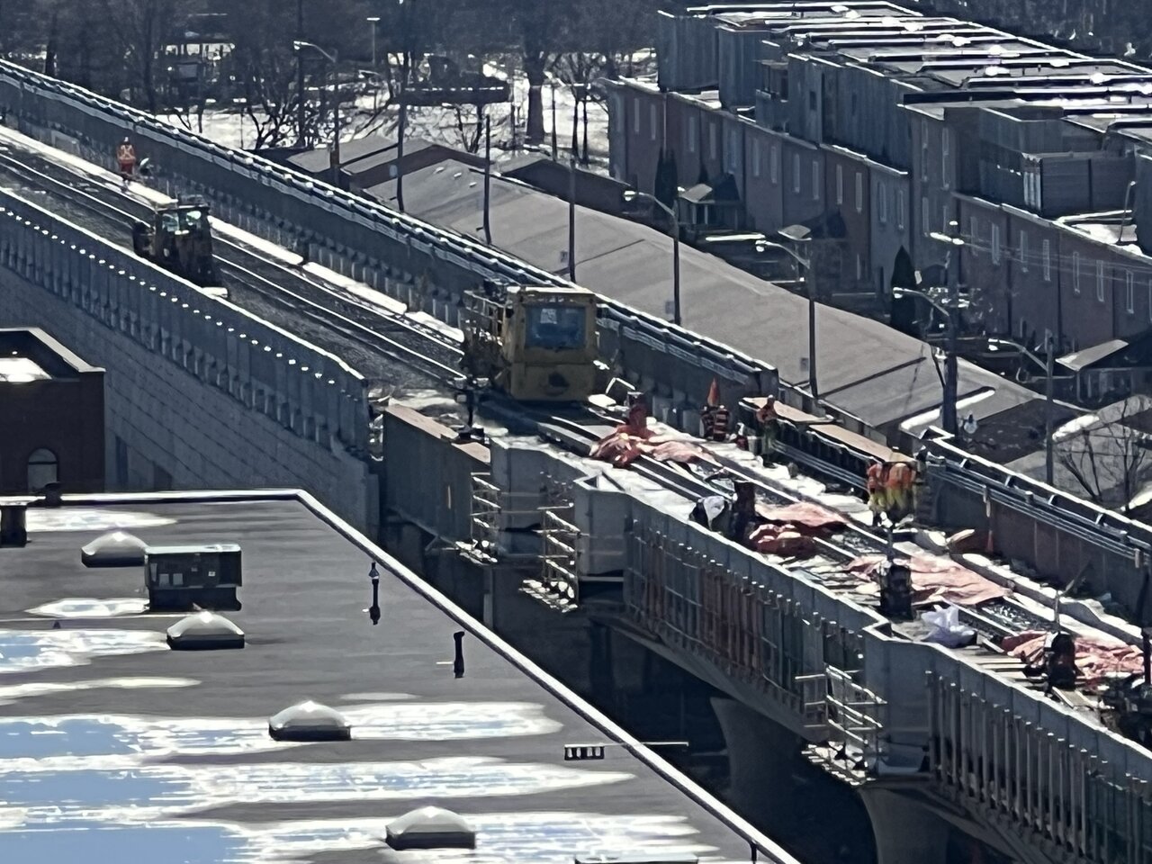

Hard to get an image of at this distance, but the thing they seem to be struggling with somewhat is a taller grade change from the south MSE to the Wallace Bridge. You can see it suddenly bumps up in this photo. It's received the vast majority of overnight work the last two or so weeks:
