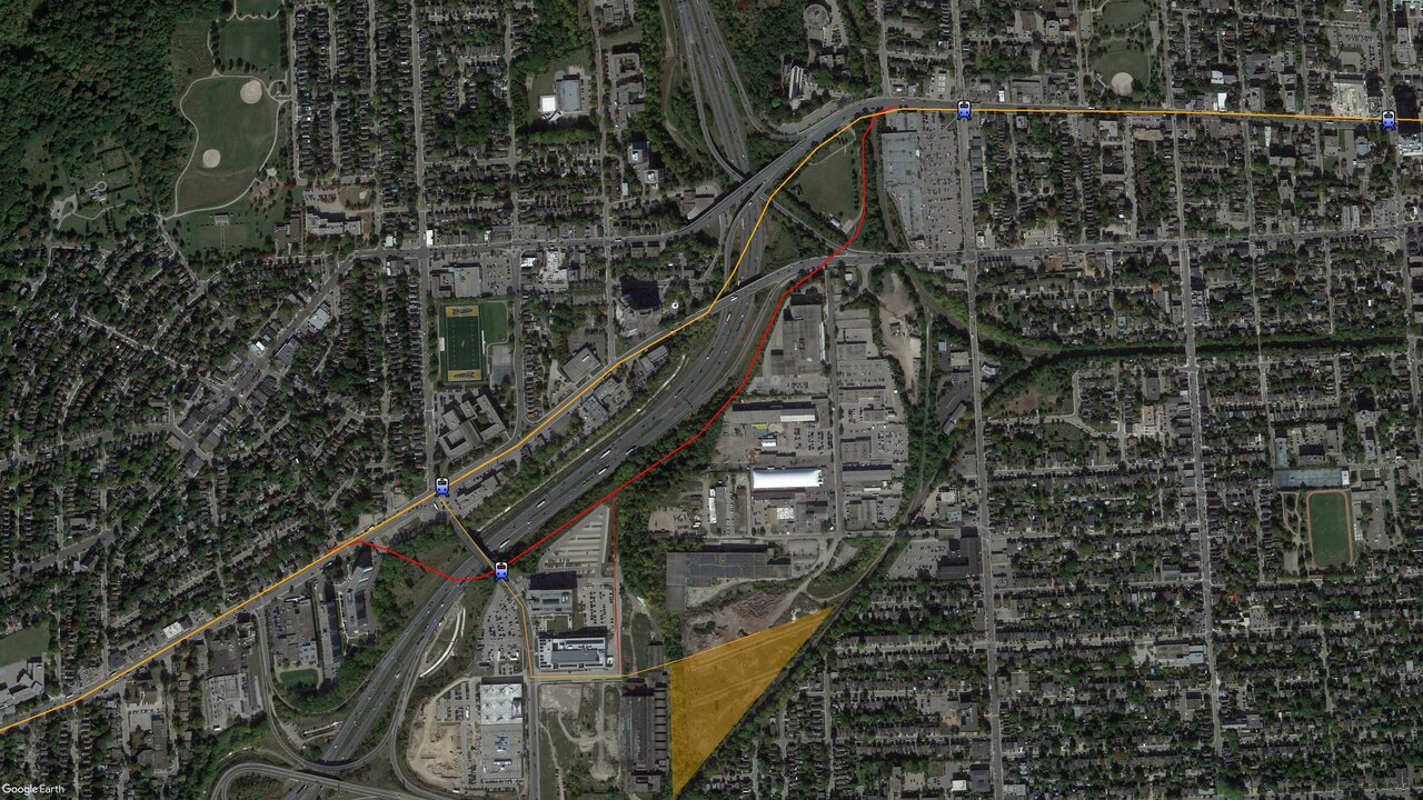

I put a bit of thought into some potential improvements to the alignment, and I think this may be a good one which may actually save costs or at least be generally comparable:
Orange = Existing Alignment, including the orange hatched area which will be the MSF.
Red = new grade separated alignment
Basically instead of a huge bridge over the 403 and Cathedral Park, as well as rebuilding the Longwood Road bridge, it would have a smaller bridge starting west of Longwood Road. a new underpass underneath Longwood road with a grade seperated stop better serving the McMaster Innovation Park would then replace the currently planned Longwood Rd Station, before the line ran along the 403 to an underpass underneath Main Street. Finally, it would run along the CP corridor beside Cathedral Park instead of through it, before rising and meeting King St at grade like currently planned.
There is probably a similar amount of structure, if not less structure, involved, and it would allow the LRT to dodge 3 stoplights it'll have to navigate on it's current alignment. Would make travel times on the core segment of the LRT, between McMaster and Downtown, much quicker. Plus the connecting track to the MSF would be shorter, runing behind the McMaster Innovation Park instead, and allowing the Longwood Rd bridge to not have to be completely rebuilt to support LRT tracks.
So why are the trees in the International Village sacred, but the ones your your modified route not?
…I think it’s pretty clear why. One area is what remains of a historic neighbourhood, full of vibrance and activity. The other is effectively a noise barrier for the 403 backing onto the Mac innovation park. One location clearly offers more shade utility and aesthetic value than the other.

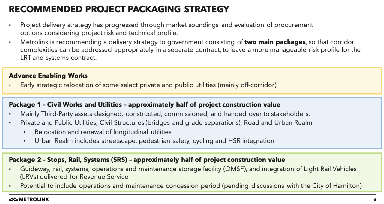

Metrolinx also gave a presentation to council. They are no longer planning to use a P3 for the whole project.
No private sector company would have agreed to P3 for the entire project (which I assume means utility relocation, urban realm, etc). Too many actors and too much timeline and implementation risk. I’m surprised Metrolinx even considered it, or thought it would be feasible.
