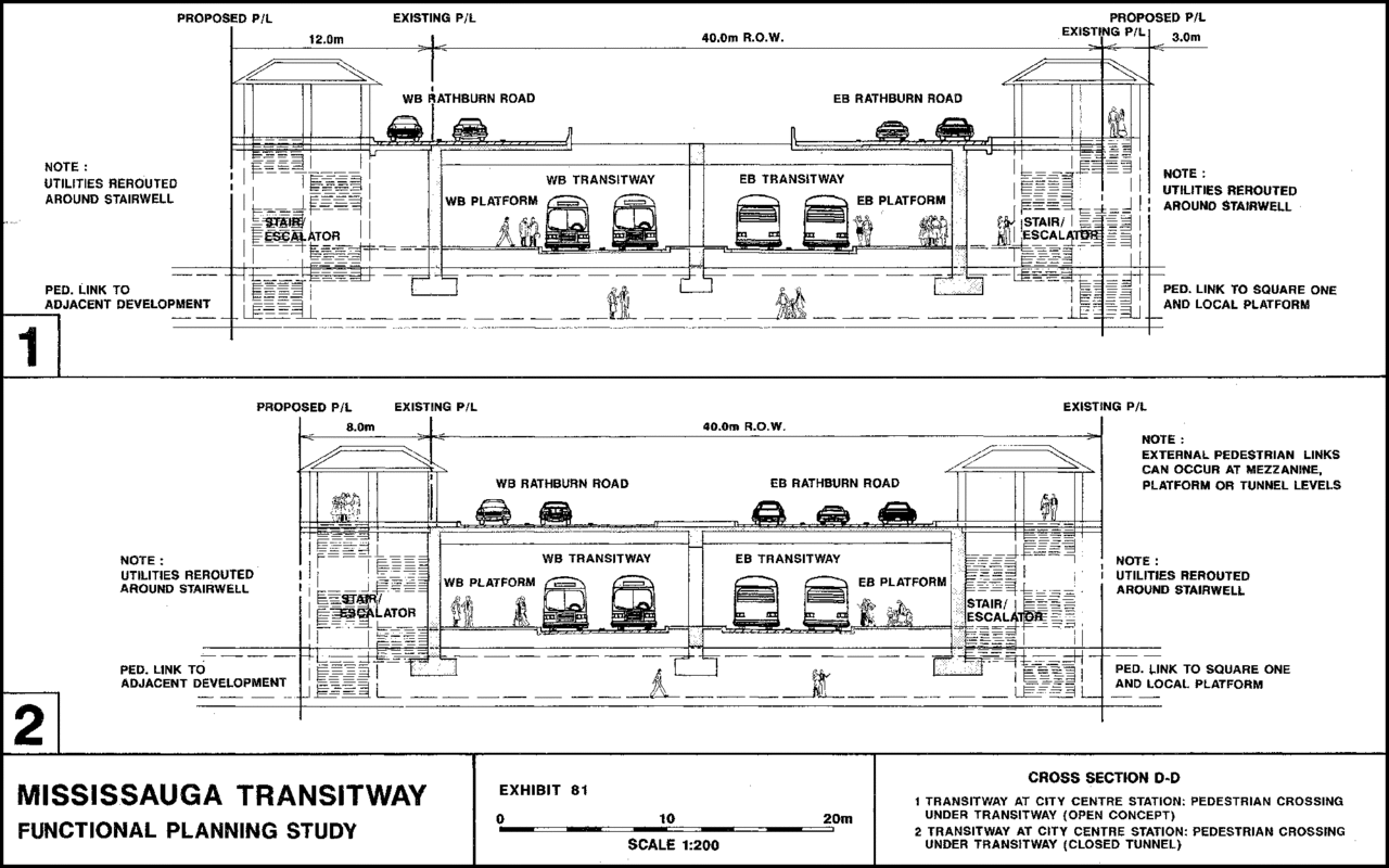

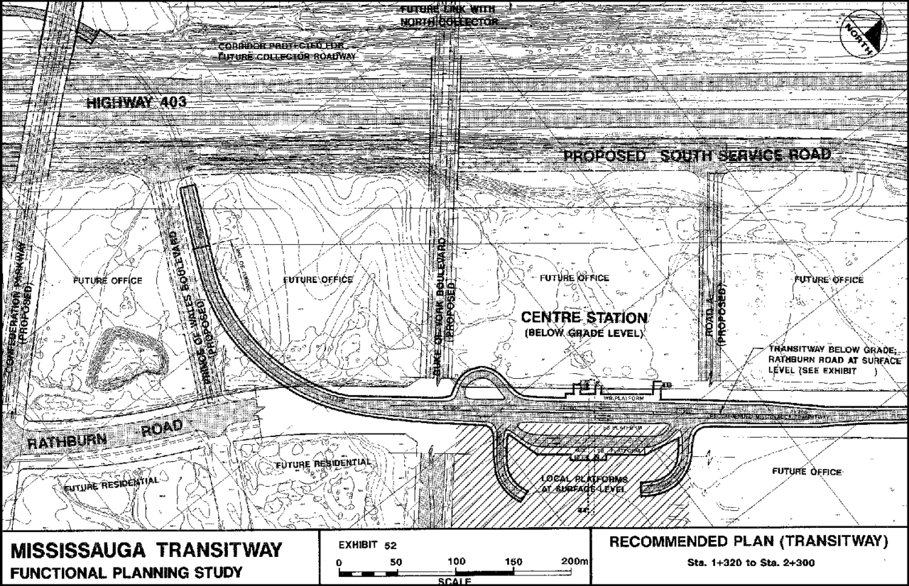

I really wish that they built the Missisauga Transitway as originally planned, with the underground bus bay at Square One
210893
210894
Then, have the Hurontario LRT tunnel underground to meetup with it in an underground station exchange. The tunnel could just be a jog to the west and then come back to the east to link back up with Hurontario Street. No transfer, a through routing.
None of this weird Y Junction mess.
Can you explain why it would be necesary to build an expensive tunnel for the LRT all the way to CCTT instead of simply connecting to the transitway at Hurontario station?
If you look at the map I drew, you can see a complete transitway with a Hurontario station would make Hurontario LRT to CCTT unnecessary.
