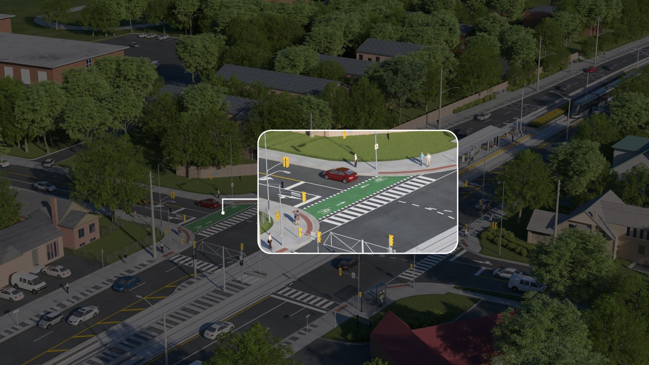

New rendering showcasing the multi-use path at Mineola Station:
There will a virtual open house on Thursday, June 15th at 7pm.
