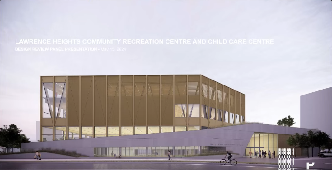

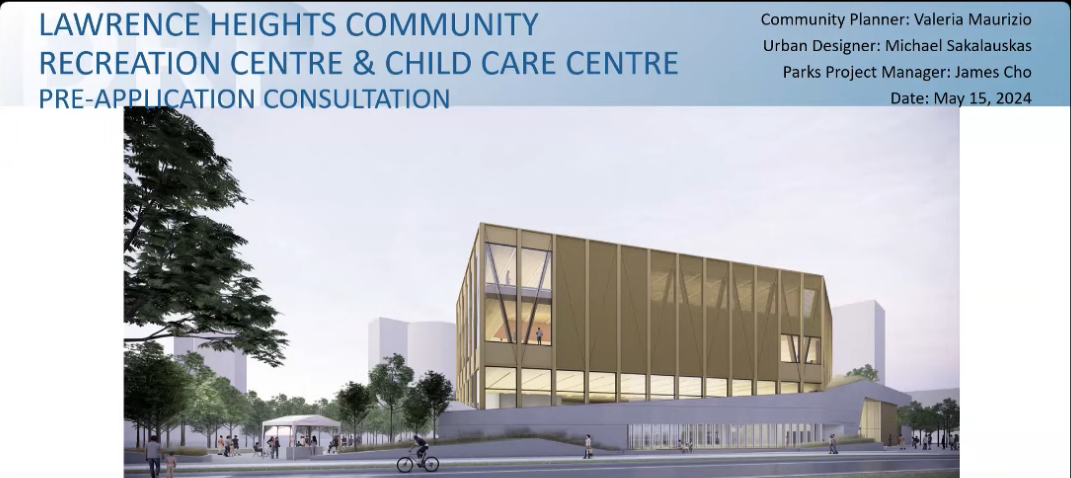

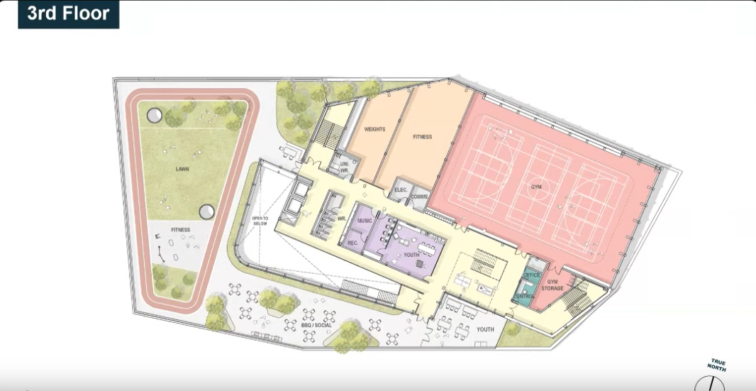

The above will be heading to the Design Review Panel on Wednesday.
I don't know if @Paclo will want to give the above its own thread, but we do have the architect listed here now.

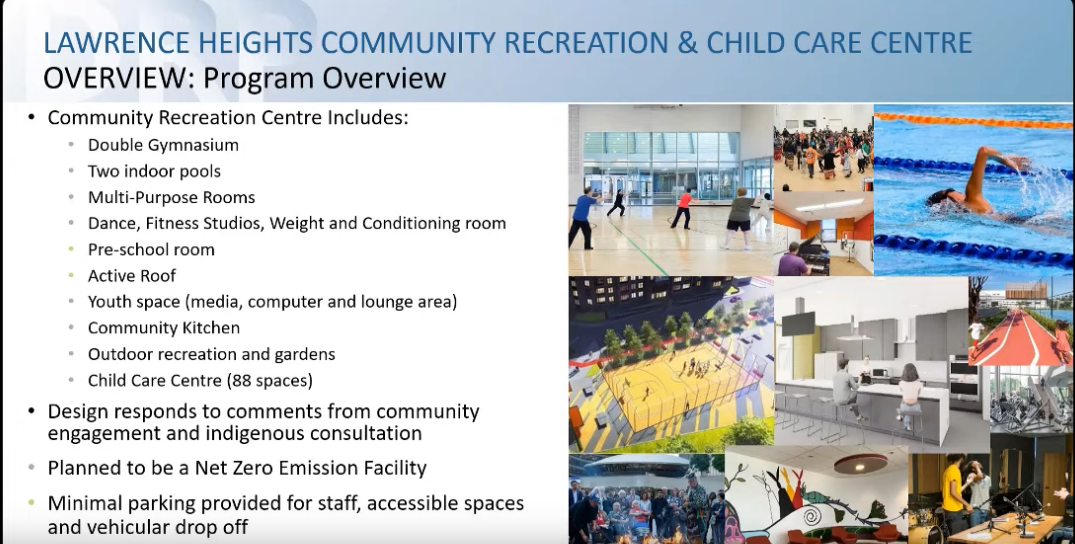

From the presentation to DRP:
(City Team)

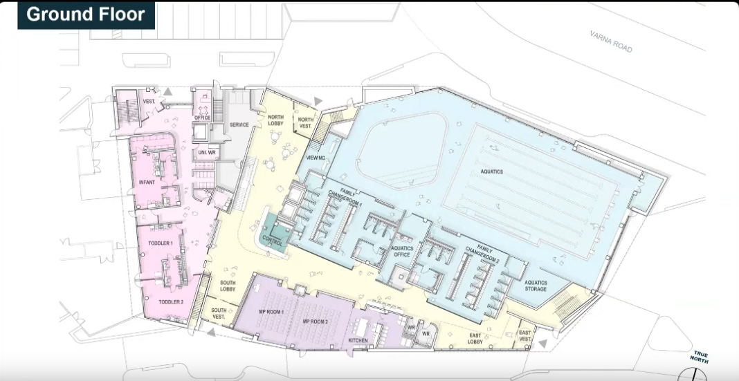

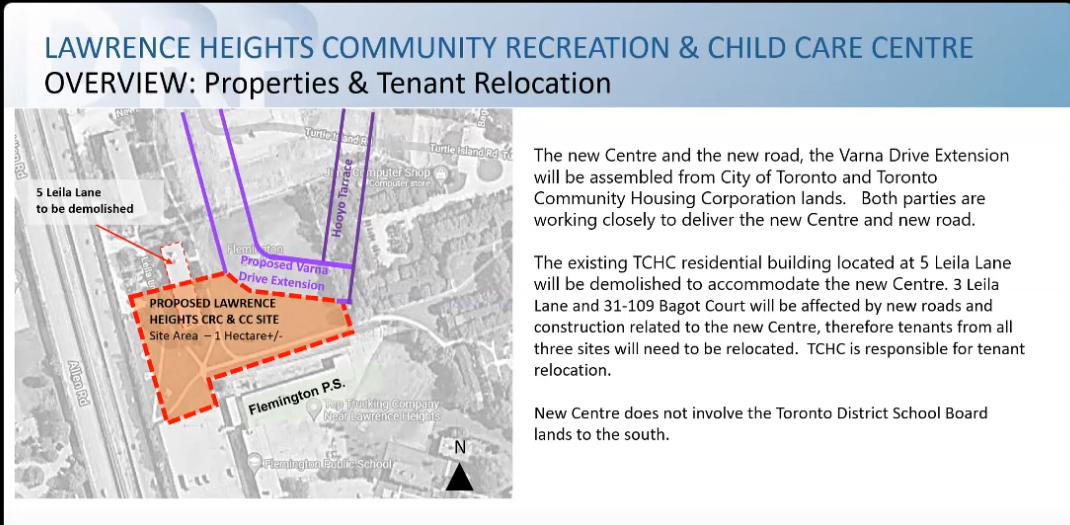

@DavidCapizzano your answer is below:

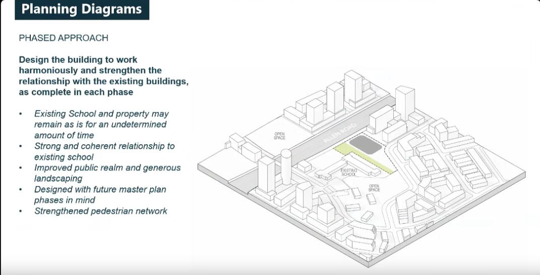

Proponent Team:

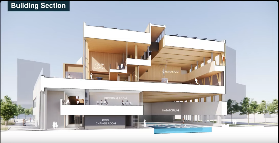

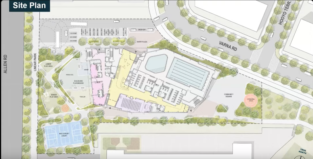

* for the above, note that the full plan rolls out, the school is to relocated elsewhere within the community and the current school footprint is to become a park.

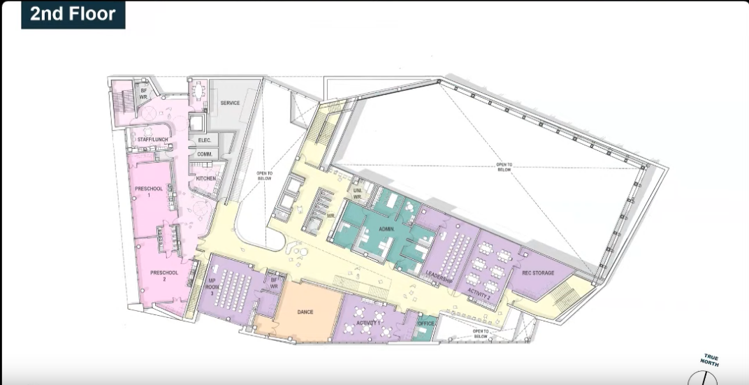

There is a nominal 4th floor in the plan as well, but its mostly mech. except for supporting the running track that will be above the gym.
I will add panel comments when I get a chance.

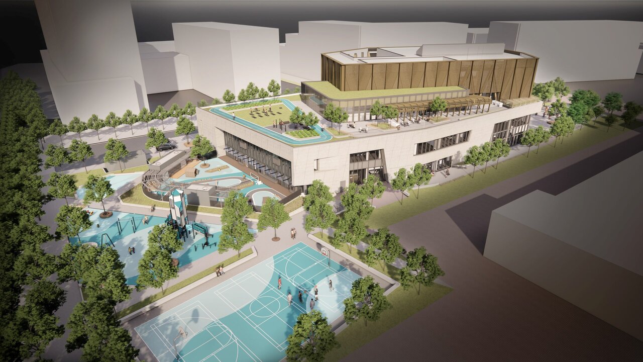

Have to go a second post for all the images:

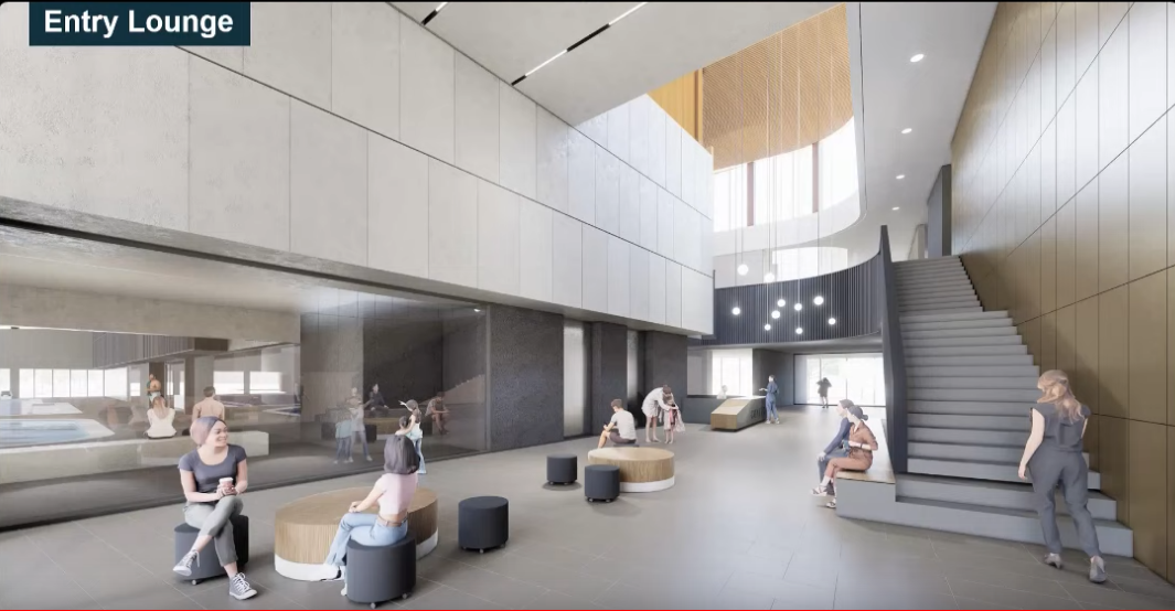

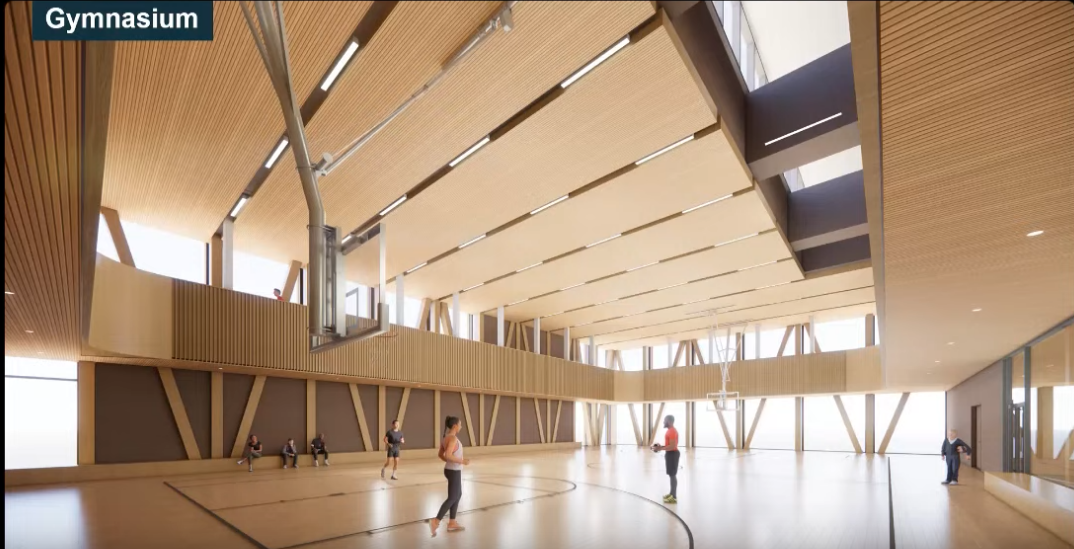

Have to say, love the gym, below:
Phew, that's it for slides.
@Paclo is flagged in case there is a desire to break this project off as its own thread.
Great post! Thanks as always! I wonder if the two Multi-purpose rooms on the main floor have high enough ceilings to act as a theatre?

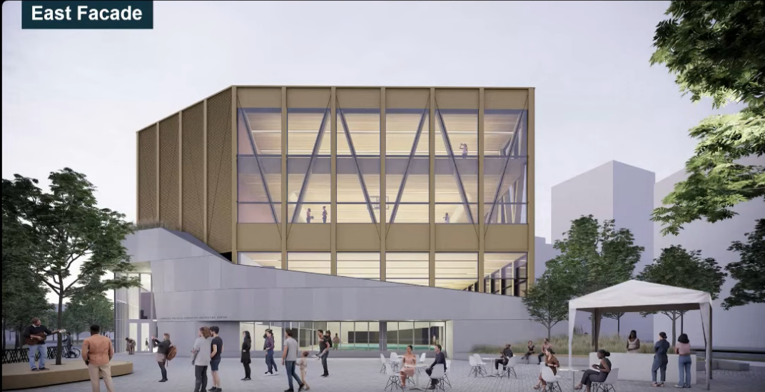

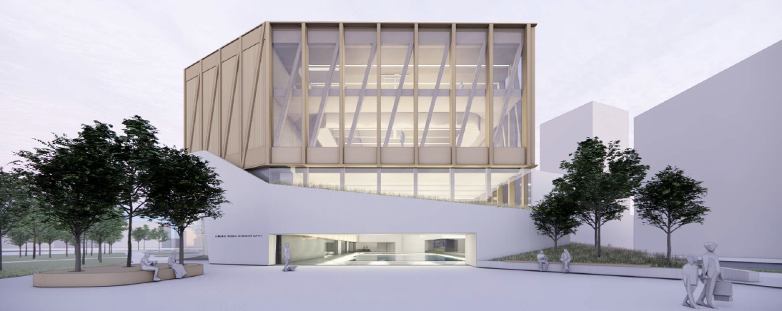

Panel Comments:

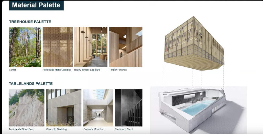

- The concrete on the lower exterior level is meant to emulate stone, doesn't work as well as it might, too smooth, needs a rougher texture to make it feel more like real stone. *
- Concern about the challenge of the south side expression (school side) because the school is temporary in the longer term.
- Feeling that the south-east entrance is maybe a bit too understated. *
- Bus turnaround is too much, and surface parking for staff is questionable. *
- If the parking is needed (accessible etc.) could it be maximally greened w/storm water infiltration - swales etc.
- More bike parking required.
- Awkward visual relationship between the 'stone' and the 'wood' of the lower and upper levels. Improved transition desirable.
- Too much glazing at grade, it's a bit relentless
Items with * were brought up by multiple panelists.
Overall panelists liked the proposal but for the comments above.

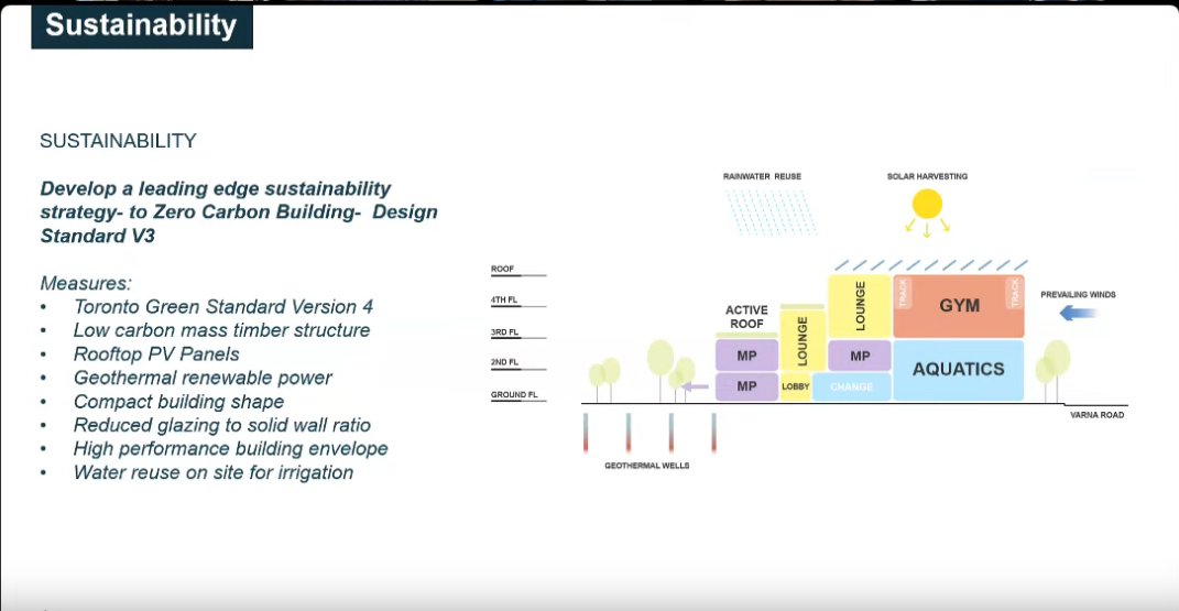

In terms of sustainability, the mass timber building is expected to be a net-zero carbon building, meet Toronto Green Standards Version 4. It will also include PV panels, geothermal, a compact building shape, a reduced amount of glazing and a high-performance envelope.
