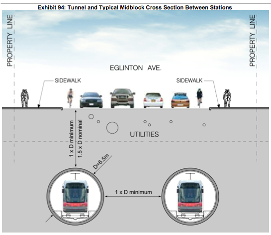

I was going to say that Pape would be too narrow for bored tunneling, but looking at the following, it looks like you could fit an LRT tunnel (the Crosstown tunnel diameter is actually a few feet larger than the Spadina-York extension tunnels).
View attachment 40680.
You would therefore need at minimum a 19.5m ROW to accommodate 2 tunnels. The narrowest section of Eglinton according to the link below of Toronto ROWs is 23m between Laird and Bayview and 27m through the center of the city. Pape is shown as having 20m, same as all the downtown streets King, Queen, Richmond, Wellington, Front.
http://www1.toronto.ca/static_files/CityPlanning/PDF/3_row_dec2010.pdf
If you wanted to put in a tunnel like the Crossrail in London, which uses mainline rail technology, you're tunnel OD is 7.2m instead of 6.5m, requiring a minimum ROW of 22.5m. Downtown you have deep basements going to the property lines too, meaning I'm not sure you could even fit 2 bored tunnels underneath, regardless of diameter.
You also couldn't make the 90 degree turns on Pape within that ROW, or up Roncy.
Instead you may have to bump up to 2 trains in one bored tunnel, not something we've done in Toronto. The Evergreen line under construction in Vancouver has one of these for Skytrain-sized (Scarborough RT) train sets with a tunnel OD of approximately 10m. If you wanted to up to mainline rail size with double deck trains, you're looking at a tunnel at least 12m OD. Larger diameter tunnels have inherent problems because of their size...more earth to remove, less optimized to the vehicles travelling through them, more concrete to deal with higher pressures. That's generally why twin bores are preferred.
