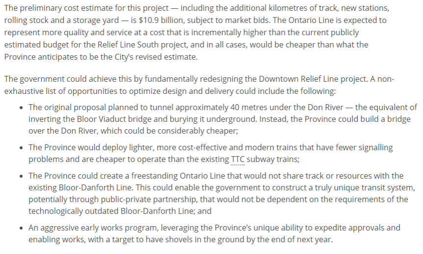

So there are these details from the budget:

If the bridge option for crossing the Don was so much better, why wasn't it being considered again?
That's my concern as well.
Hmm, is it possible the Prov is referring to the Queen crossing this whole time? When they talked bridge stuff it made sense that it was Leaside. But if they mean Queen vicinity then someone needs to tweet Metrolinx asap and get details on this backroom vision. Where's the bloody report. We've all looked at this for years, and for a sub-grade alignment there's pretty much zero opportunities for crossing above-grade between the lake and Gerrard. Where's their uproar for tunneling under river valleys in Scarb, or virtually zero density outer suburb areas in Markham/Vaughan. Doesn't add up.
The bridge is cheap but where will it go? The only possible solution I see is to demolish the current Eastern Av overpass and build a two level bridge over the Don. Maybe this can be Toronto's signature bridge LOL
The the line can remain elevated over the GO tracks till Gerrard Station. They will save billions here with this option. If they can shift the GO tracks and build beside them, even more money can be saved. With a light metro technology that can handle tighter curves, we'll likely see half the line above surface.
Then the have two more Don crossing at the Millwood Bridge and the West Don River crossing. The cheapest option is elevate the line through both these crossing. They might as well elevate it through Thorncliffe Park too and over Eglinton. It'll be expensive to dig under Science Centre Station.
$11billion sounds about right for a ~14km-15km underground railway with 15 or so stations (at least 4 of which would be interchanges according to the published maps).
They actually used the word "cheaper" in the budget??? Wow, this is indeed the government of Doug Ford.
And while a bridge may be less expensive, the portal to access it likely won't be. I wonder if they could run the line beside the existing GO line though, and have the East Harbour Station have tracks for both services on the same level.
That is what I gathered from the language.
If so, that would be a significant change from the municipal studies. Still, they couldn't have just thought this out of thin air, everything seems like it has Metrolinx's hands behind it.

I don't think so, the EA for the Relief Line South shows track level being 18 metres underneath of the Don riverbed.
If it's for the northern don river crossing, that would have required some ridiculously deep stations at Cosburn and Thorncliffe park as the elevation change is absolutely massive, especially if it's 40 metres underneath of the river. That would be about 80m below grade at the north end of Pape..
