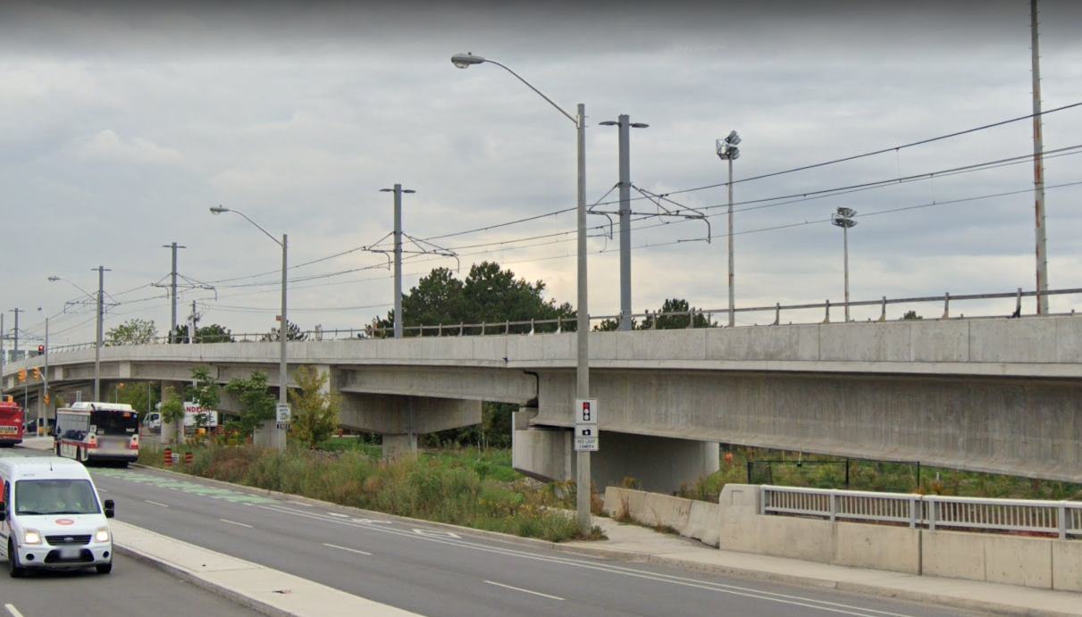

I posit that this doesn't matter. An elevated structure is large and intrusive. The difference between a third rail and catenary, once it's placed on such a structure, is trivial.
You said there would be more pushback if the line comes with catenary as opposed to not.
I would've thought the same a few years ago. Until I saw the 20ft masts. It makes a difference. How could it not since it doubles the height of the structure. And keep in mind I'm one of the biggest advocated of elevated rail. If overhead is not needed - and they're most definitely not for the reasons listed - we shouldn't have them. My opinion.

PS, the catenary masts do add height to the overall look of the guideway.

And we have a catenary guideway in Toronto now fyi.
