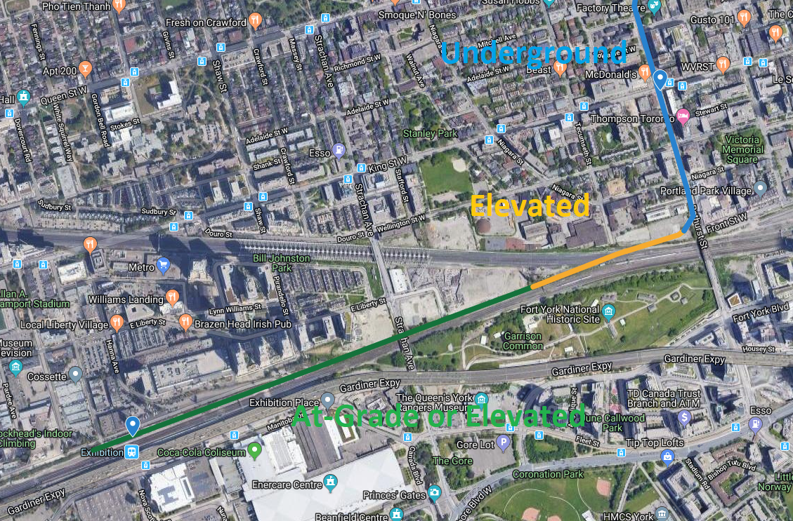

I see this being a rather cheap way to get the line to Exhibition
It looks like the line goes from underground to elevated over the tracks in about 150m. That's going from 5m below grade to 9m above grade (7.2m clearance + 1.8m for the bridge structure). That's 14m in 150m - or about 10% grade. I'd suspect the best trains could do about 5% (or maybe 6%).
Looks interesting, but is it possible to make such a quick transition from underground to elevated just west of Bathurst? Especially, after taking a sharp 90-degrees turn.
It's doable with LRVs and Skytrains. I just drew it that way, they could make it not as sharp. It all depends on what technology is selected. Light metro could be able to make the curve. I does add time to the trip but if they can save half a billion for a couple more minutes, I don't see why not.
it's 215m from Bayview @ Lawren Harris square to the top of the berm near the train tracks. We now know they plan to follow the train ROW up to Gerrard
The berm is 8.5m high. So 13.5m height in 215m distance. 14m high in 230m for going over the tracks. 6.3% grade for the former and 6.1% for the later.
Pittsburg has a grade of 10%
Portland has 7%
Sheffield has 10%
So the grade is not a problem.
Portland has 7%
Sheffield has 10%

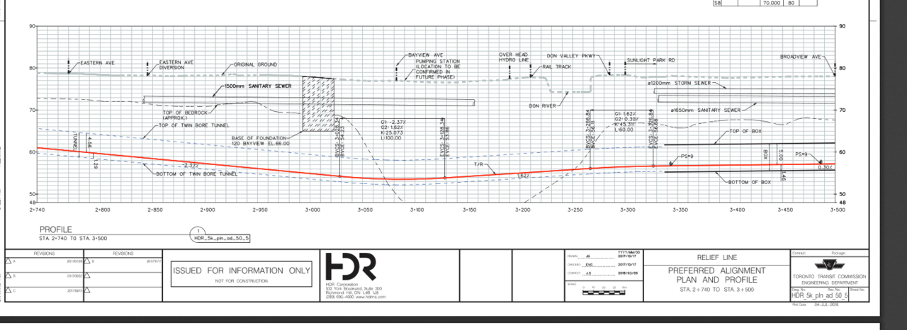

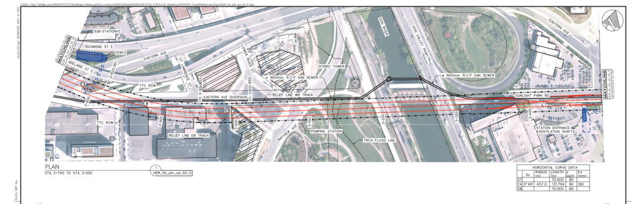

On what basis did you figure out the required clearance for the Richmond Hill GO Corridor?
Bare minimum clearance requirements are 6.7M, assuming the 2 tracks were equally elevated, that works out to 15.2M, assuming you got the berm height correct.
Moreover, though, wouldn't that assume the subway was already fully at grade at Bayview?
It has to get from tunnel depth up to height, the tunnel itself is about 5.8m tall, but the ceiling will not be right below the road as it has to slide under a rather large sewer.
For reference, the tunnel is currently designed at a depth of 20M under Eastern Avenue.
Perhaps my math is off...........
But I'm getting a number closer to 14% grade.
Keep in mind the require thickness of the base supporting the tracks, at elevation.
Then there's another issue.........did you notice the high-voltage Hydro Pylon just beyond the Richmond Hill tracks? In the pic, below, the near-side pylon is shown, but the wires end up on the riverside just to the south.
There's not a very big clearance window between over the Richmond Hill tracks and under the Hydro lines.
Alignment from www.reliefline.ca
189321
Vertical (depth) from www.reliefline.ca
189322

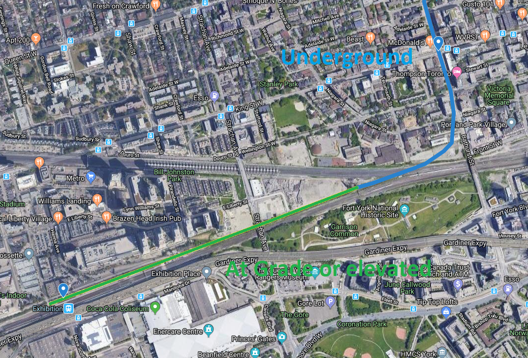

IMO the traditional TTC approach would be digging a very deep tunnel with a TBM under Liberty Village and the EX. It'll make a connection to LSW line very inconvenient and an expensive station.
Maybe this is more reasonable?

His numbers are problematic. Particularly the depth assumption immediately prior to a portal; his clearance assumption over the tracks is fine, give or take that hydro issue I mentioned.
But the FPL isn't exactly 4M, and that excludes the current trees and park infrastructure, which would presumably be removed in this scheme?; If not, problems would really abound.
Suffice to say, this is much more challenging that some of you seem to think; and that's IF you're willing to destroy the park.
Virtually nothing is impossible. Some things are just incredibly bad ideas.
All Verster et al would have to do is produce some engineering drawings and analysis. Since they don't exist outside of what the TTC has done, then it's pure fantasy on Verster's and others part. The Metrolinx Wish List keeps growing.

Your wish is........................
Excellent! I can increase size many times to see the detail. I've downloaded the file again with a new title I can remember for later reference. Those drawings speak volumes.
