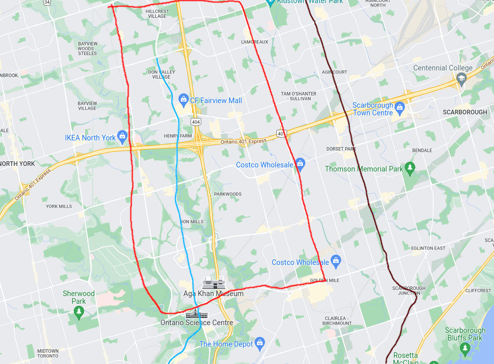

Here's a crappy drawing of a potentially OL North extension to finch that I drew for the sake of example. Realistically, the area highlighted in red here is the areas that will be most affected and well served by the Ontario Line (and even that is questionable since a strong argument could be made that people living near Pharmacy might prefer to use Stouffville RER). In order for the Ontario Line to get such a massive need for capacity, realistically you'd need like 10% of this red square to just be jam packed with high density development, and the moment that happens, you're probably better off solving that capacity problem by just building another line on Victoria Park.

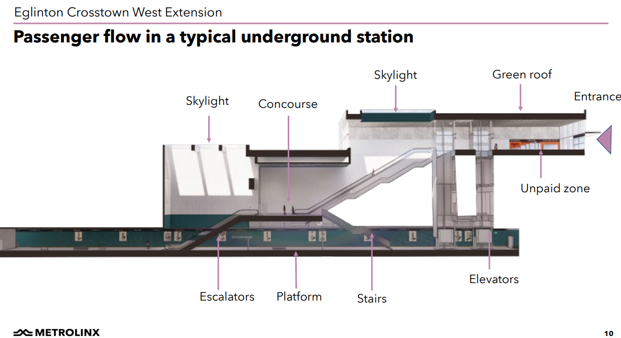

That's the frustrating part, though. The stations on the Eglinton West LRT extension are all much shallower, only one concourse before heading down to the station platform, maybe 15 to 20 m below street level? This is the same level at which the Ontario Line platforms should be built. Instead, the OL tunnels are bored at ~35 m, well into the bedrock in the downtown section causing the 4 flights of stairs/escalators to get between Line 1 and the OL.
The case with Eglinton that's important to point out is that it seems like the government is well aware about the cost problem so they want to have it both ways. They want to bury it (because Doug Ford), but they also want to cut costs on stations. Now the obvious solution here would be to Cut and Cover it, however because there's a massive gas mainline in the way they can't. So they try to TBM as shallow as possible in order to save on construction costs. Plus Eglinton has the benefit of being mostly greenfield so there is less to disrupt. As such, maybe my example of EWLRT was a bit misleading and presumptuous.

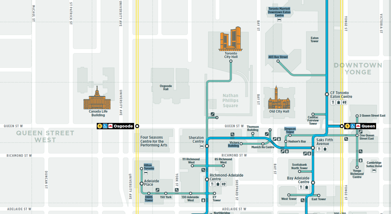

From link.
There should be underground passages that lead to both the Ontario Line and Line 1 stations from the surrounding building. In fact, the PATH could be expanded to include currently unconnected buildings. For example, they could add underground passages to and from St. Michael's Hospital, maybe even bypassing Line 1 and going directly to the Ontario Line stations.

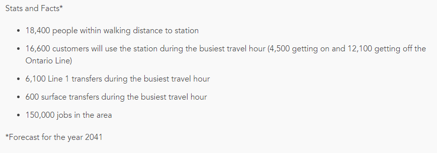

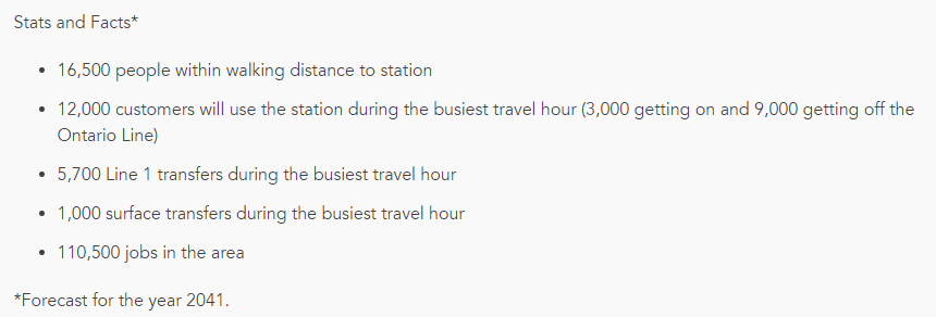

So, the current estimates for transfers is as follows from the Ontario Line Metrolix page.
Osgoode Station
Queen Station
I'd say the demand for transfers are high enough to warrant designing these stations as close to the Line 1 platforms as possible. Similar to what Yonge-Bloor station layout looks like.
