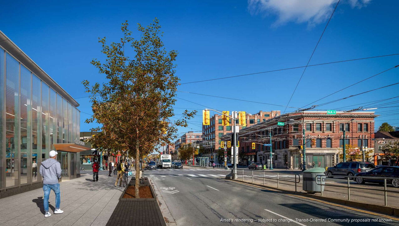

A whole block of buildings on the south side of Queen west of Spadina is fenced off with green mesh - I’m assuming it’s for OL station construction.

... they should also see if they can squeeze an entrance to the subway directly from the streetcar platforms .. although yes I acknowledge the platforms are maybe too skinny for that.
Not possible if they require accessibility for all. If we had double-ended streetcars, with doors on both sides, we could have use a centre platform with escalators and elevators available.
It would save pedestrian death/injuries to move the streetcar ROW from the centre of the avenue westwards to where the southbound traffic lanes are currently. Even if we couldn’t do it for the length of Spadina, it would really help through Chinatown. It would also help with transfers to the OL as the sidewalk is narrow on the SW corner of Queen/Spadina on from of the to-be station.
Thanks for the response, though my thought was more toward the design of the OL right-of-way. A less constraining loading gauge could be useful when designing the alignment at difficult locations compared to using TTC loading gauge.
Especially once dynamic motion of the carbody is factored in, you're likely only going to see a savings of maybe a foot per track.
I can't see any locations along the ROW being so tight as to require two feet - 2 tracks worth - making any substantial difference.

How bout' we ban left turns at this intersection. Not only will we speed up the busy streetcars, but we can also use the space claimed from the left turn lanes on Spadina to create wider streetcar platforms with amenities and widened pedestrian infrastructure in this area to handle the passenger levels.
Oh, but we won't do that because drivers take priority, of course.
