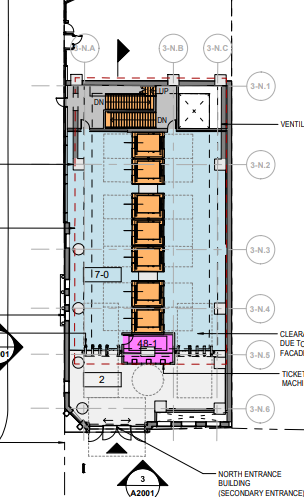

Interesting - so Spadina will be mined and appears to have elevators proposed for access from the northeast entrance?
Only Elevators, correct. (plus emergency stairs).
I'm seeing a few secondary entrances as elevators only. King-Bathurst, Queen-Spadina, Osgoode.

Spadina is a odd duck - with that much space devoted to the elevator bank, you can probably put a pair of escalators in scissors format.

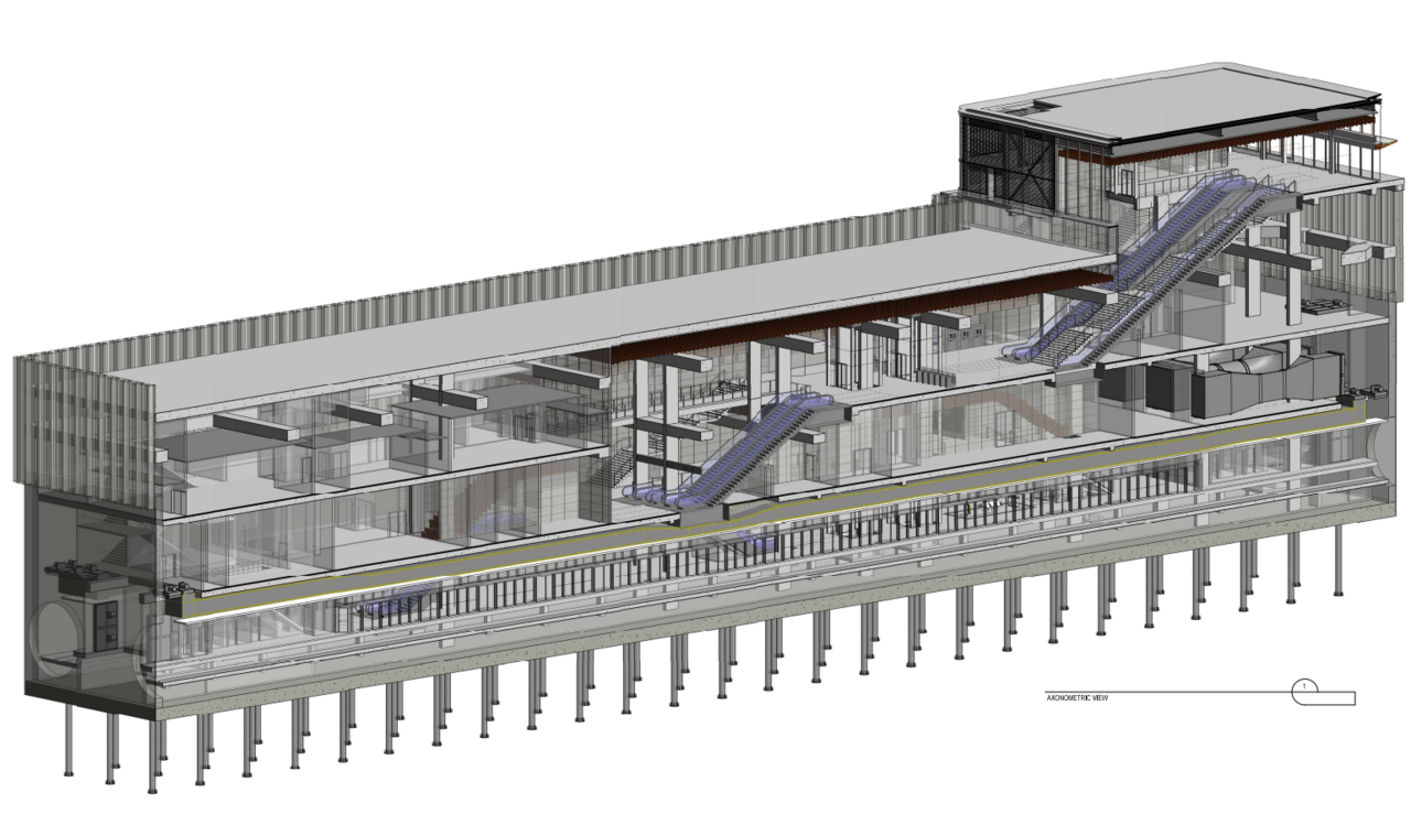

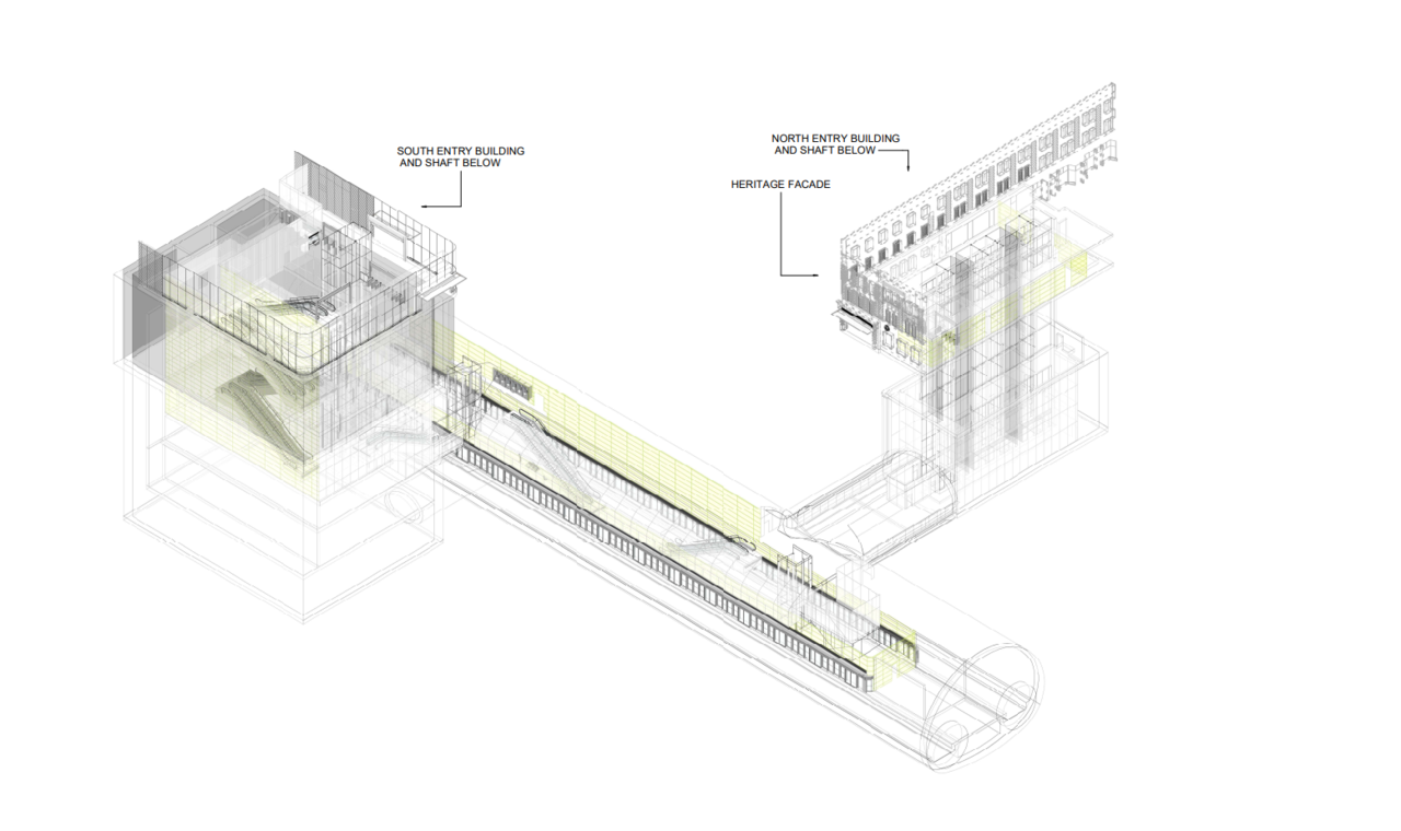

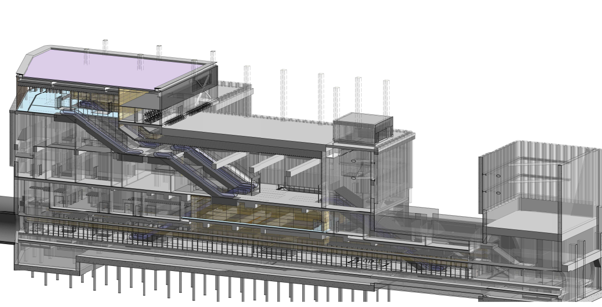

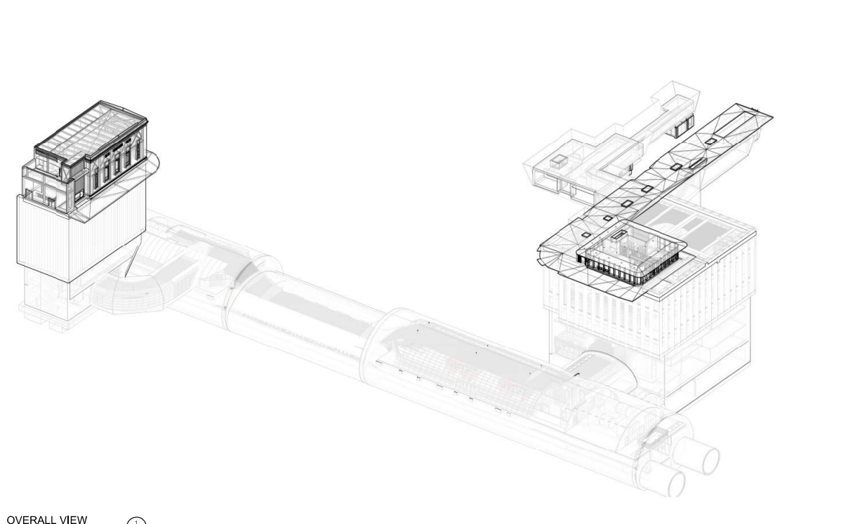

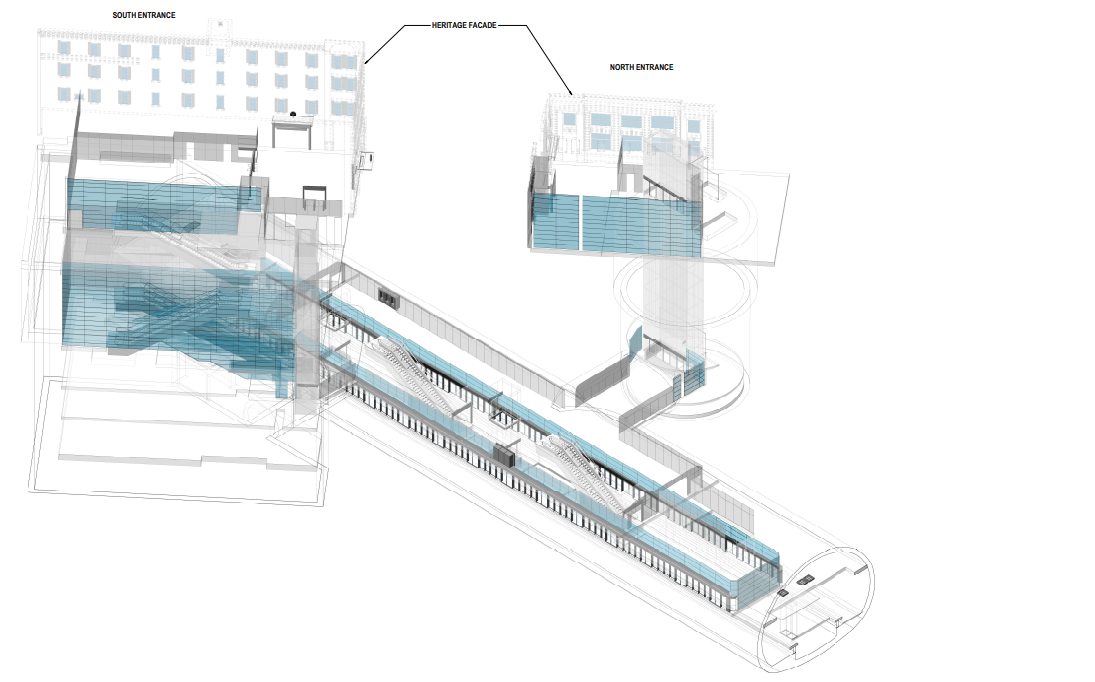

Documents seem to have already been made available for some! Curious to see the layout of Queen station, but nothing seems to be there yet.
Here's just a few isometric diagrams as a preview, along with the application links:
King Bathurst
Spadina
University
Moss Park
Corktown
The non-mined stations here (Moss park and Corktown) look overly complex with massive mezzanines. What is all that space going to be used for? Hopefully, they have some use and we're not paying for it to just sit empty all day.
