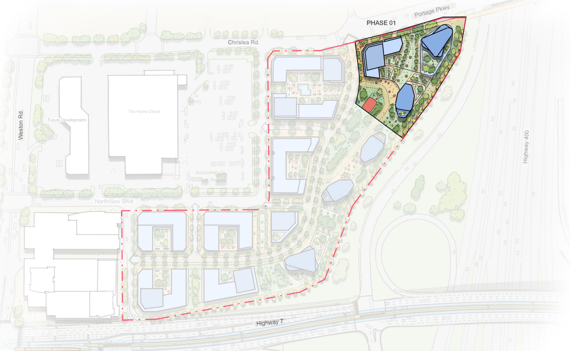

The madness at VMC continues. Smartcentres submitted a new Official Plan Amendment and Rezoning applications on the North West corner of Hwy 7 and Hwy 400.

Wayyyy too much density here. The walking distance to the subway is too far and unpleasant having to cross the 400 on either Highway 7 with that terrible median crossing or the tiny sidewalk on Portage Parkway.
I could see this working maybe as a midrise site with a few highrises along Highway 7.. not 5,000,000+sf of density and 10,000+ people living here though.

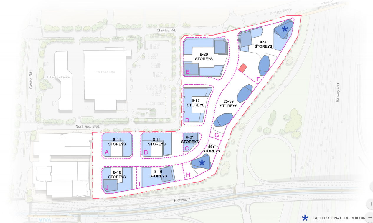

On the contrary, I believe having density here is fine, though it should probably be chopped by a few floors and redistributed across the site.

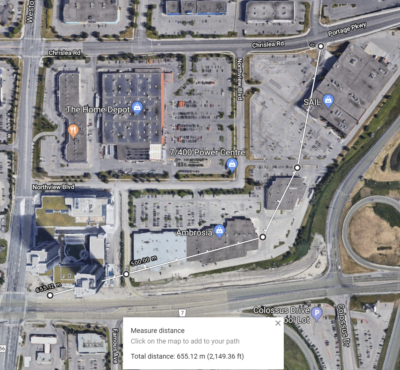

There is a station at Weston and Hwy-7, and it is two stops away from VMC. Phase 1 of this proposal (which is the sites furthest away from the station) is just 655m away from the BRT. Every other phase is even closer.
655 metres is generally seen as walkable for transit, and the master-plan here makes it seem like it will be an enjoyable walk for the majority of residents rather than one through suburban misery.

Have you been up in this area? The stretch of highway 7 here is essentially a freeway, it is an extremely inhospitable environment for pedestrians. The new BRT may have actually finally added a sidewalk to this stretch, but pedestrian friendly it is not.
The reality is too that most transit trips in this area are going to be on the subway, and nobody is going to pay $3.50 to take VIVA 2 stops to save the walk over the 400. They are going to walk over the highway on that terrible median pathway breathing in horrible air quality from the 14 lane highway underneath them.

I believe there are contradictions with your claims @innsertnamehere. If the area is so inhospitable to pedestrians, then that would make it more likely for residents to take VIVA instead of walking over the 400. The majority of the blocks in this master plan are within 500m of the BRT station, whereas they are looking at a 1.85km to 2km or more walk to VMC over said extremely inhospitable environment. The standard rule in transportation planning is that people are willing to walk between 500m and 800m to transit.
Yes, Hwy-7 is essentially a freeway, but the residents in this development don't need to traverse it for long except next to the Centro Square development on their way to the VIVA station. The residents will instead be walking through that new street traversing the master plan, which looks to be intended as a pedestrian friendly and landscaped environment, and not miserable suburban conditions like Hwy-7 or Weston Road nearby.
Sounds like to me the only real issue is fare integration between VIVA and the Line 1 subway, which is an institutional problem, not a development planning problem. This development has to be considered from a planning lens, which considers BRT stations like VIVA as rapid transit in the same manner as LRT or subway stations and doesn't consider concerns such as fare integration.

Those aren't contradictions - they are the exact reason it shouldn't happen.
Even with fare integration at $0.00 in additional cost to take the bus, most will probably still walk as by the time you wait for the bus and take it two stops, you may as well walk.
And when walking involves a long walk through an inhospitable environment, people just drive. Thus bad planning and a bad location for this kind of density.
I can tell you today that many in the Centro Square walk to the subway, but that the development is mostly auto based, unlike the projects opening up on the other side of the highway like Expo which at least appear to have proportionately much higher levels of pedestrian activity accessing the core.
This is requesting a maximum FSI of 6.0 in the OPA as well, which is above most subway station's wildest dreams for gross density, yet alone BRT. It's not appropriate for a BRT system. Something closer to 2-3 FSI is more appropriate.
