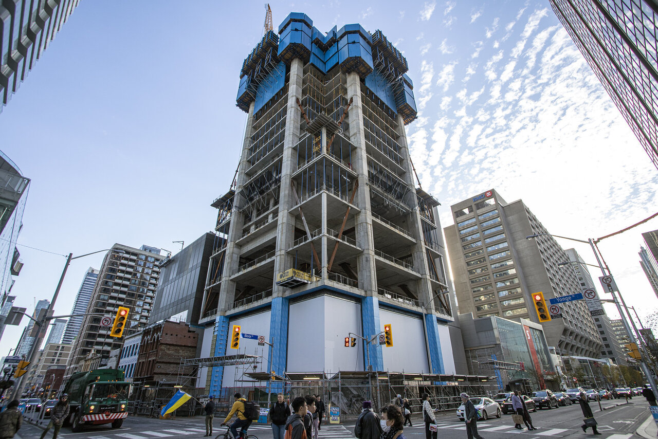

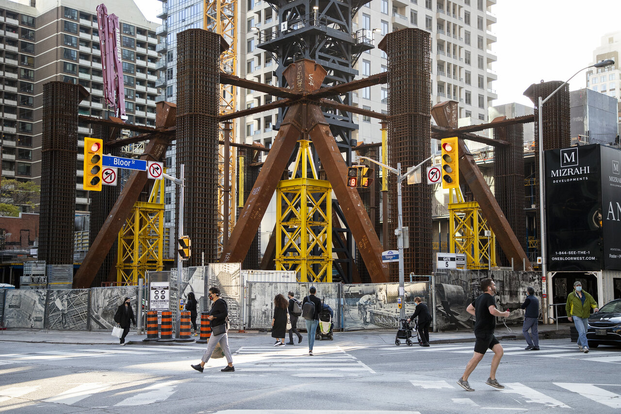

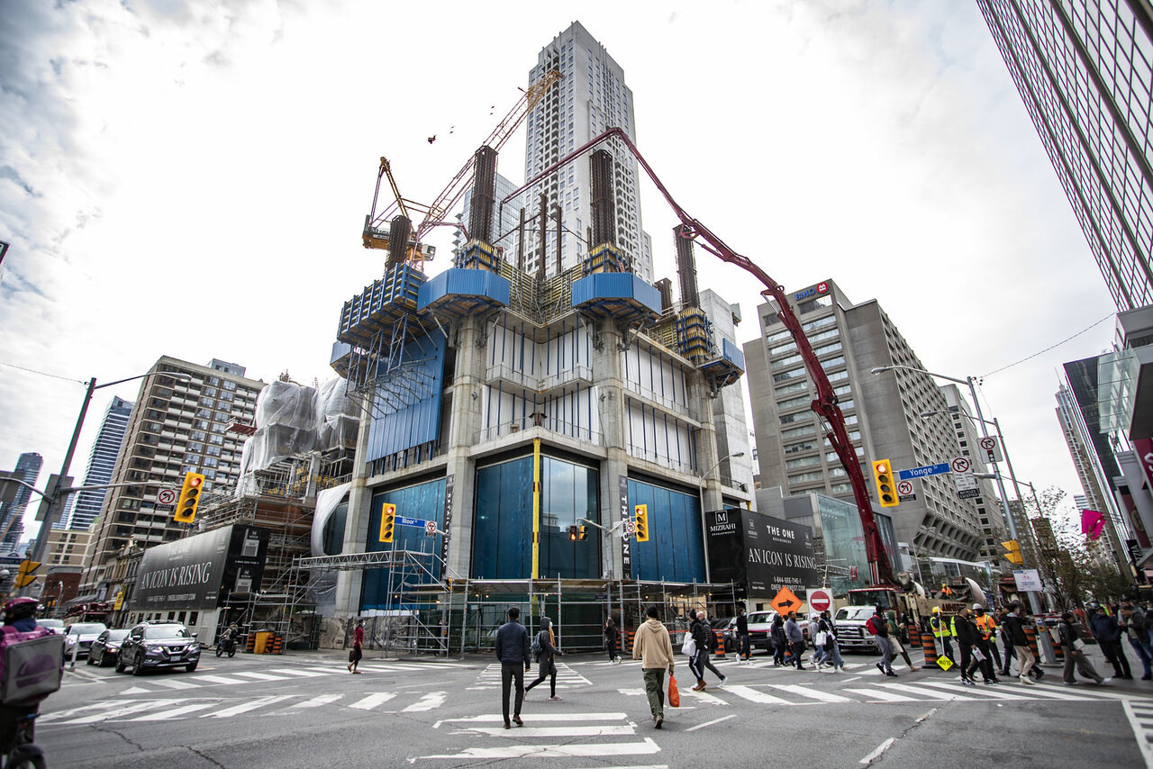

My second post - on my Flickr account, I have several albums dedicated to this project. One is a weekly "time lapse" from the NE corner... Starting in October 2020, virtually every week since.
Not sure if links are allowed, but here it is to the weekly time-lapse album: https://www.flickr.com/photos/jer1961/albums/72157718725607562
Some samples, at near-annual increments - first shot is Oct 23 2020, second is Oct 23, 2021, third is this past Friday, Oct 21, 2022
View attachment 434489View attachment 434490View attachment 434491
Pictures like these make me appreciate how far this project has come, albeit slowly. Living in the area it seems like just yesterday it looked like your first pic! I'm proud that such a unique and high-quality building is being brought to the area.

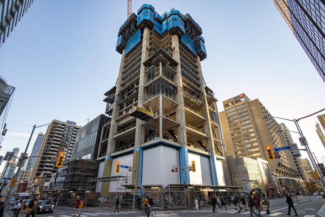

The tower, October 28, 2022. For an updated time-lapse of the construction going back to 2020, go to my Flickr album:
