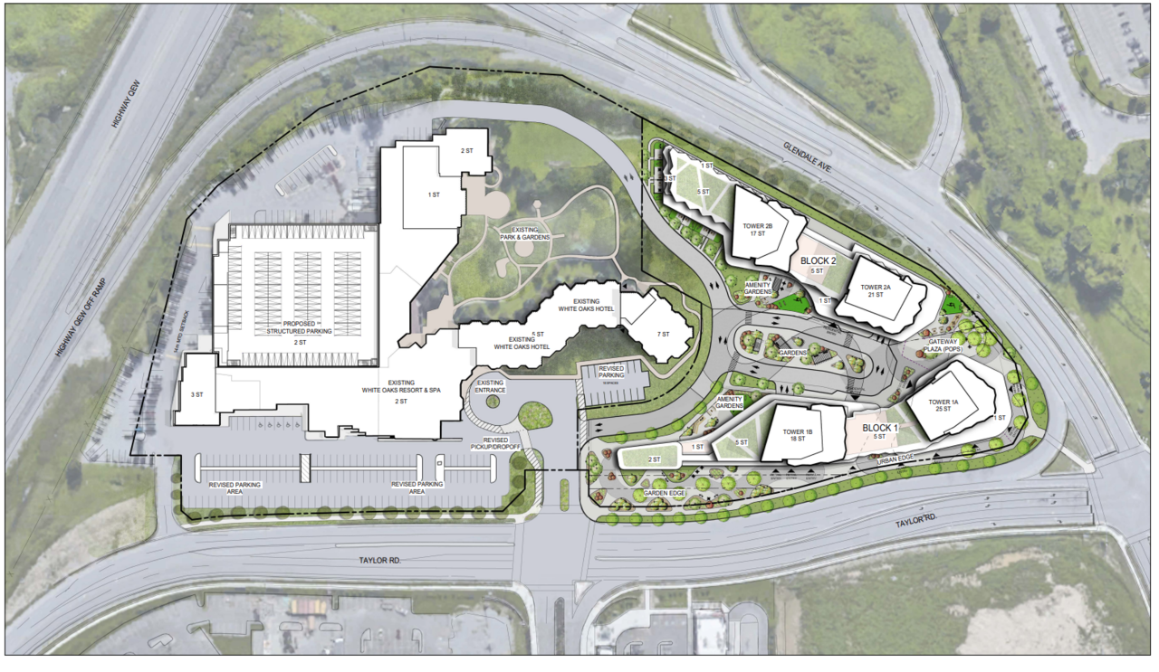

Immediate thoughts:
- The Glendale to Taylor slip lane must go. Regularized intersection please.
- I don't like the 1s base sticking out, I'd prefer 2s-3s, which would help create a real or illusory main-street small town feel. 1 storey base make it feel like a strip plaza with towers grafted on top.
- This is Niagara, it's Wine Country and there is a burgeoning cycling tourism market. Cycling needs to be accommodated here either with on road cycle tracks or with a multi-use path.
- For the base only, it would be good to incorporate some use of brick as a nod to the old town; it needn't be pastiche. I'd prefer true masonry but good pre-cast, done properly, could work. It can add some nice warmth.
- The landscape plan should play on the White Oaks theme, and go oak heavy, obviously including white oak, but red and bur would be a nice mix. Contrast them by adding a few Beech and maybe a hemlock or two for winter interest at the low point on the property.
- If not the case already, I assume Niagara Region Transit will serve this area, and proper stops should be incorporated (with shelters and outdoor seating). If that doesn't make sense now, space should be allocated to it for future implementation.

To add to your comments.
Here is the current Secondary Plan Link:
There apparently are bike lanes already on Taylor Rd. though updates will follow and I'm sure some intersection upgrades as well. Not sure about a MUP though (multi-use path).
Review is on going for a proposed transit hub across the street from the White Oaks site in the PDF.
I like your thoughts on the trees, definitely would be a good add as well as sturdy lol
Lastly, I don't believe a "main street" feel would be appropriate in this location due to the size and traffic that Glendale and Taylor Rd. have and will have, but in saying that the secondary plan is looking to have that feel brought into the Outlet mall site by adding a retail main street there. Retail on this side of the street I think will have a tough time, but was requested.
MUP I offered as an alternative to Cycle Tracks. Since there are on bike lanes on Taylor, how about we just upgrade them to cycle tracks? That could be a 'Community Benefit'; the development implication is simply ensuring there is sufficient ROW.
I just glanced at the Taylor ROW. The interior lane is 3.3M wide, it can be restriped to 3.0M which would come very close to enough room for a Cycle Track, you might need to concede 0.2M off the applicant site. Depends on if there's any room to squeeze the left-turn lanes.
Glendale would benefit from cycling facilities as well, but man is that interchange w/the QEW an unholy mess.
It wouldn't be reasonable to pin fixing that on this applicant.
However, I think a preliminary look at the foot print of a better interchange design might be wise to ensure it works w/the proposal.
For clarity, I want those on/off ramps to meet each other at a traffic light; i actually think the implication might be a small net add-on to the applicant''s land, but its difficult to say, turning that ramp has radii implications.
