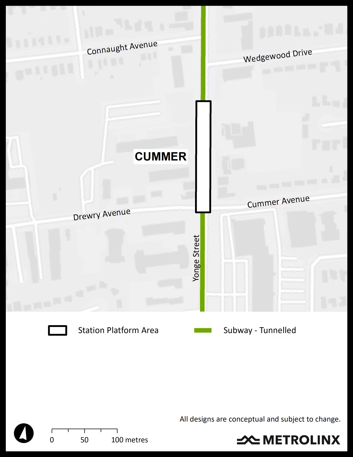

This thread will be used for discussion of Cummer/Drewry Station: a potential TTC station on the Yonge North Subway Extension, serving the intersection of Yonge Street, Cummer Avenue and Drewry Avenue in Toronto's Newtonbrook neighbourhood.

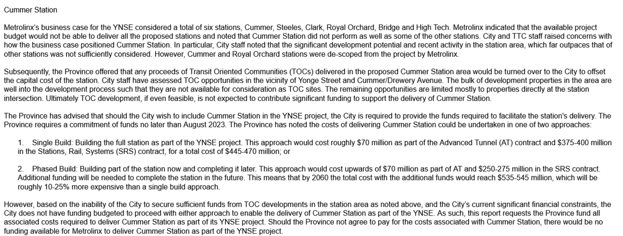

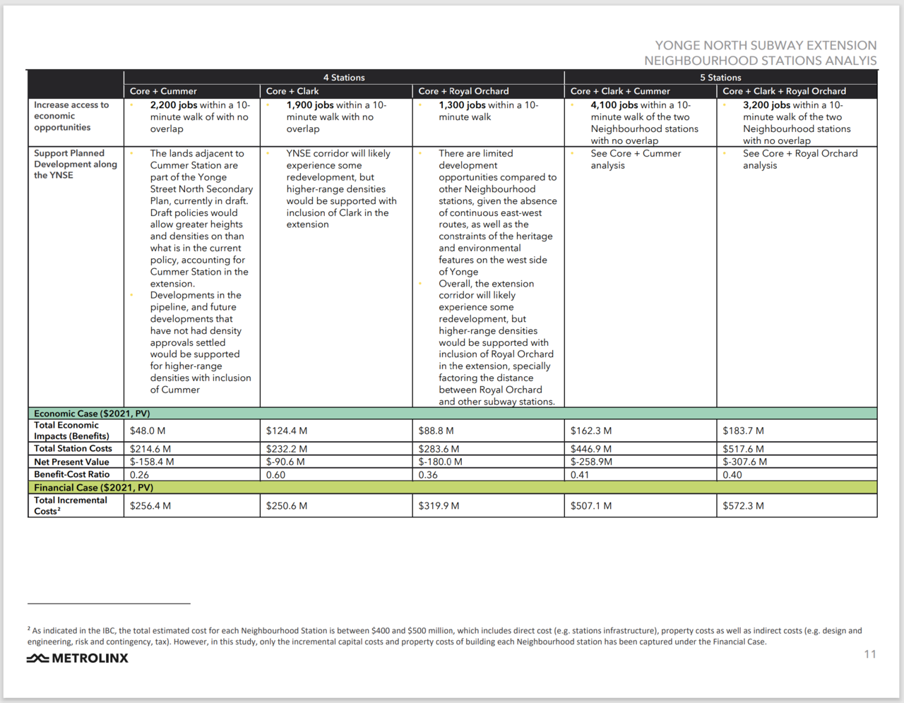

In 2021, Metrolinx did Cost Benefit Analysis of the Optional Stations (Cummer, Clark and Royal Orchard) and the cost of Cummer Station was $214.6m in 2021 dollars,... why have these cost now doubled???
Page 11: https://www.metrolinx.com/en/region...NSE-Neighbourhood-Stations-Analysis-Final.pdf

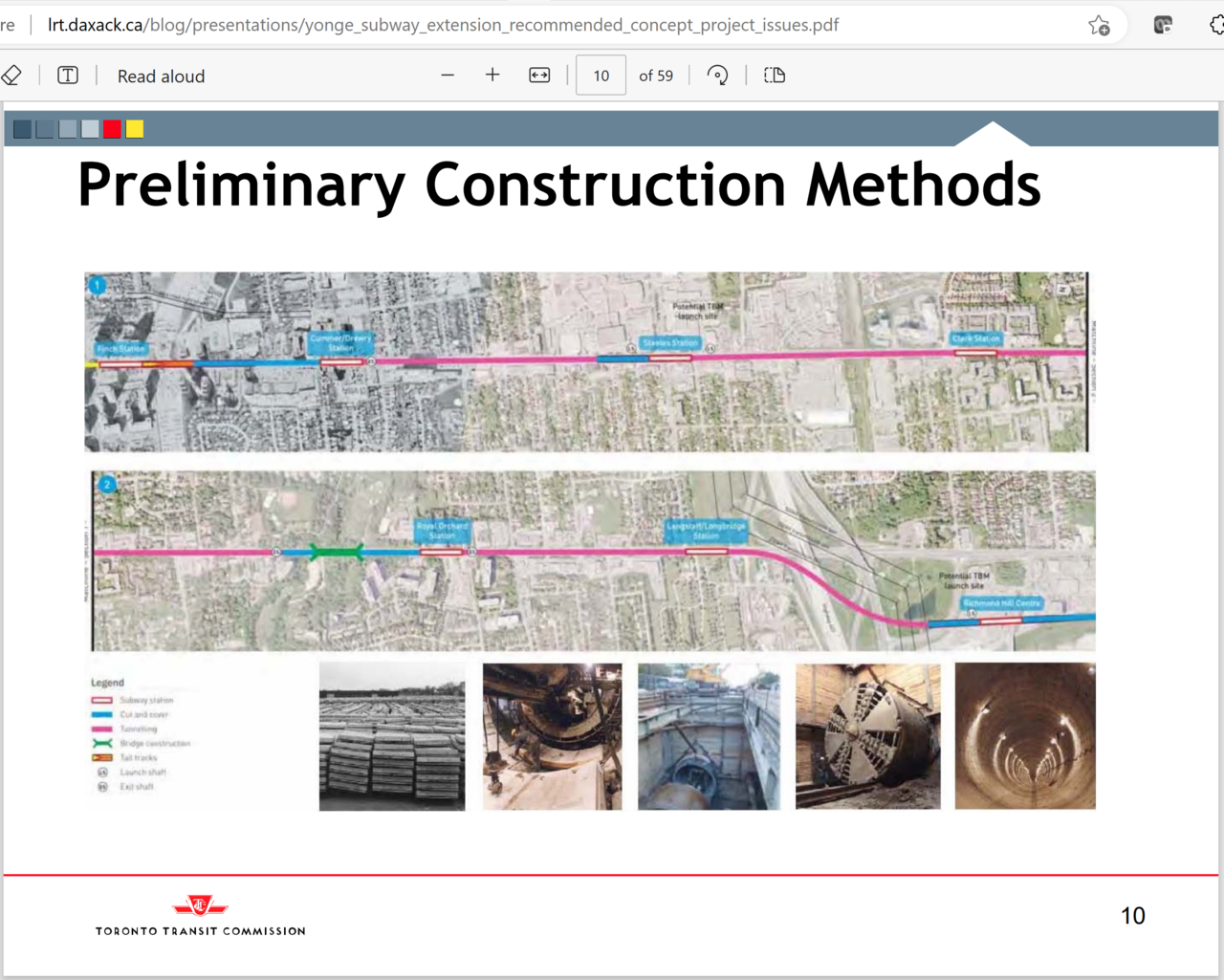

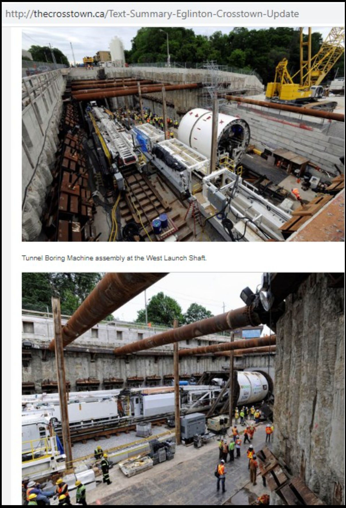

At recent May 16 update on Yonge Subway Extension,... Metrolinx stated the Tunnel Boring Machines will start/launch at the north and dig southward to Cummer (Extraction Site) - where the Tunnel Boring Machines will be brought back up to ground level, they will need to dig a big hole right at Yonge and Cummer,.... right where the unfunded $215m Cummer Subway Station would have been!!! So what are they gonna do afterwards? Fill up the hole with dirt as was done with the cancelled Eglinton Subway Line 30 years ago? OR, since the subway station size hole is already dug,... just build a Cummer Station at half the original cost!!! Come on, this isn't rocket science,.... and people are surprised MetroLinx keep on finding new ways to mess up construction of the Eglinton Crosstown!
NOTE: Image above shows longer Launch sites to give you an idea of how big the hole is relative to the people - so you can see a Launch site can easily fit an entire Subway Station!
Note: the subway tunnels from Cummer to Finch Station's existing tailtrack (just north of Finch Go Reginal Bus Terminal) will be done via Cut-&-Cover Construction
If you have a big hole in the ground for Tunnel Boring Machine Extraction site on Yonge at Cummer,... and you're using Cut-&-Cover to build the Subway Tunnel to the south,... how much extra will it cost to build,... err, to fill the hole with a Cummer Subway Station - since the hole is already there?
