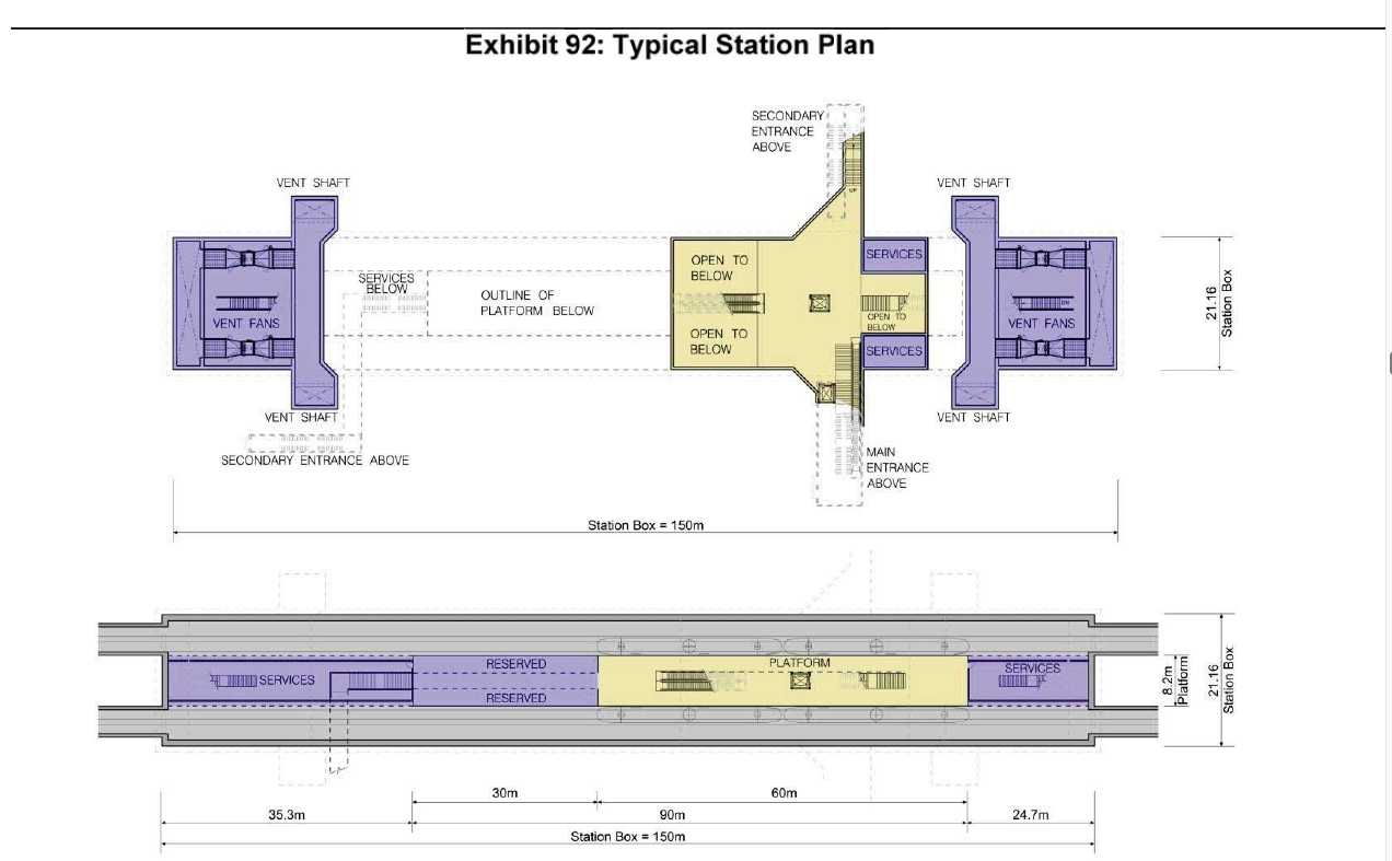

From link.
The typical station box accommodates a 90 metres platform with a 40 metres service area at one end and a 20 metre service area at the opposite end resulting in a total station box length of 150 metres. Initially the LRT operation will consist of a 2-car trainset requiring a 60 metres platform. To protect for the ultimate 3-car train set the 90 metres platform would be constructed, but then temporary walls would be installed to create the initial 60 metres long platform. A 2.5 metres wide corridor would bisect the remaining 30 metres reserved portion of the platform leading to an additional secondary entrance.
That makes them almost the same station box length of Toronto's legacy subway platforms. While 90m is about 3 Flexity Freedom light rail vehicles in length, that could be extended to 5 Flexity Freeom light rail vehicles, if they make use of the entire station box.
From link.
I doubt they can occupy the whole station box with platforms; the "services" areas are probably essential for the operation, and if they repurposed them to make more platform space, then new "services" sections would have to be dug. Plus, 5-car trains could have problems fitting both the surface sections/stops and the elevated sections.
3-car trains is probably the limit for this line, but that's quite a bit of capacity.
