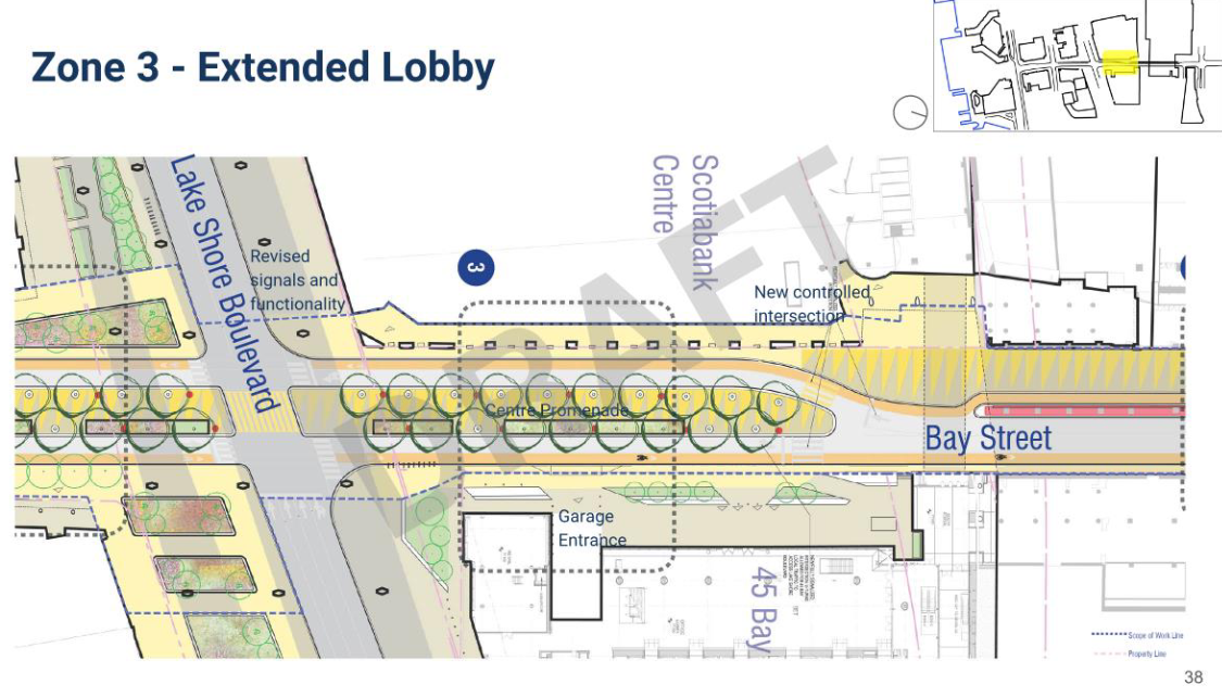

I welcome it south of Lake Shore but can't help but wonder what cutting Bay's traffic lanes will do from Lake Shore to Front St will achieve.. just to put in a median? The space under the underpass isn't really needed for pedestrian traffic either right now as most people have excellent room to access where they are going through the two GO concourses on either side.
At the very least it should be widening the sidewalk along the ACC (err.. Scotiabank Arena) to help deal with game time crowds.. It's not a fun experience lining up for security clearance getting into the gates along there right now. I'd be supportive of dropping the double right turn lane there to fix that issue, but beyond that, I just don't see the need to completely screw traffic for marginal, not very useful pedestrian space gains. If you want to reduce crossing distances at Front/Bay, cut the left turn lanes there, especially the NB one, and restrict left turn movements in peak hours at the intersection.
South of Lake Shore Bay St isn't nearly as busy, especially once the Bay St on-ramp is demolished, so a single vehicle lane works better there. I would probably want to keep dedicated left turn lanes though.

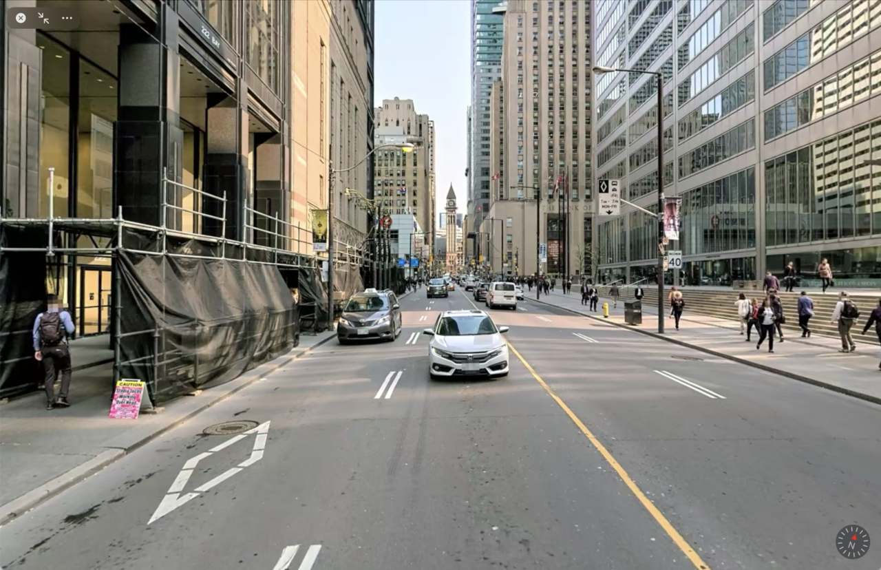

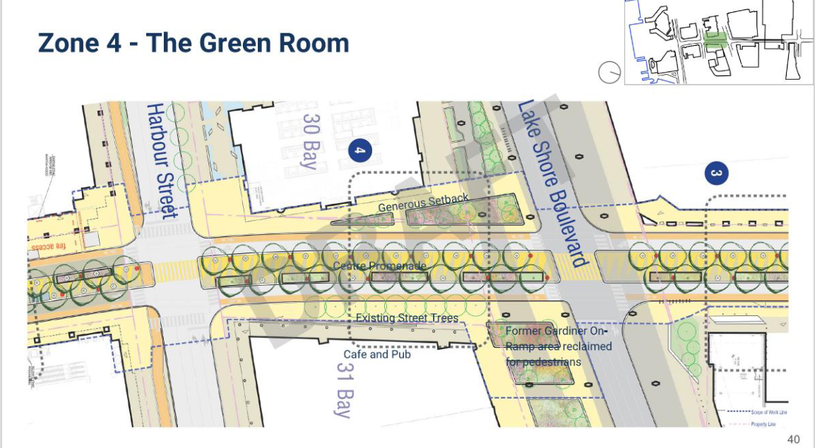

I wish we’d use this opportunity to fix Bay Street between Front St and Queen St too. In the pre-COVID times the sidewalks were overloaded with pedestrian traffic, due to people walking between Union Station and King/Queen. There will be even greater pressure on sidewalk capacity with GO Expansion, the Ontario Line and population/office growth funnelling thousand of more pedestrians onto Bay Street at peak hours in the upcoming years.
The street is also rather windy and loud and not particularly comfortable to exist on. This is likely due to all the hard surfaces (skyscrapers, road surface) reflecting the sounds and creating a wind tunnel. The installation of trees would address both issues.
We're fortunate to have a marvellous terminating vista with Old City Hall at the top of the street. With some proper streetscaping, this would be a wonderful view.
TheTigerMaster
Superstar
Feb 4, 2012
13,263
7,065
Tentatively, I'd suggest removing the transit priority lanes to widen the sidewalks here on both sides. The additional space could also be used for the installation of trees.
This would negatively impact the operation of the 6 Bay bus, however with the Yonge Line, University Line and Ontario Line being providing alternative routes, I'm not convinced that this would be overly detrimental to transit users. Heck, I'd even consider terminating the Bay bus at Queen if that makes route operations more reliable. I can't imagine this route is heavily used between Queen and Front.

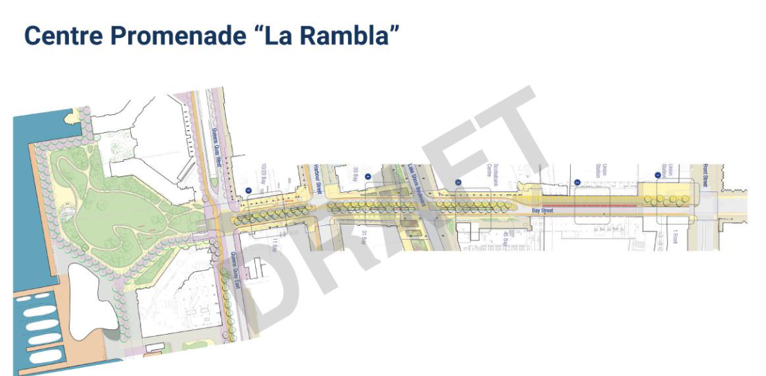

Have they ever considered one way traffic like in Hamilton. That way they can still have 2 lanes of traffic if not possibly 3. Not sure if I am a fan of the La Rambla design, because the one side of the street will get much less foot traffic then the other, and that will affect retail on that side would it not?
Either way those designs are better then the present, and yes we definatley need a main entry boulevard to the waterfront, similar to what places like Montreal have when walking to the waterfront.

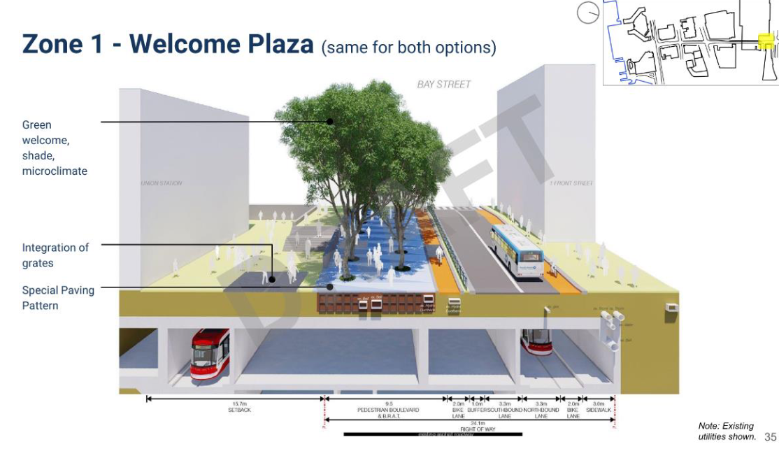

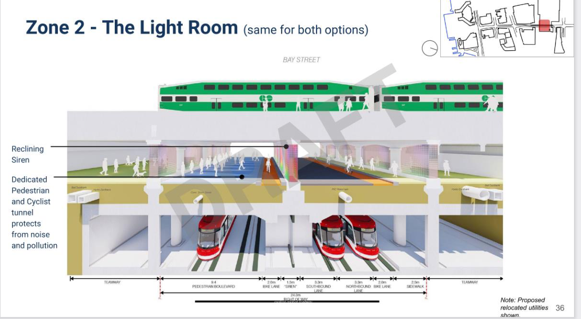

The centre median is a bad idea. We know from our experience with University Avenue that the centre median will be a dead zone for pedestrian activity. Nobody will want to hang out between two car lanes (as depicted in the image).
The "West Side Bioscape" concept is preferable, as it provides more space to pedestrians, which will help relieve pedestrian overcrowding in the area around Union Station.
