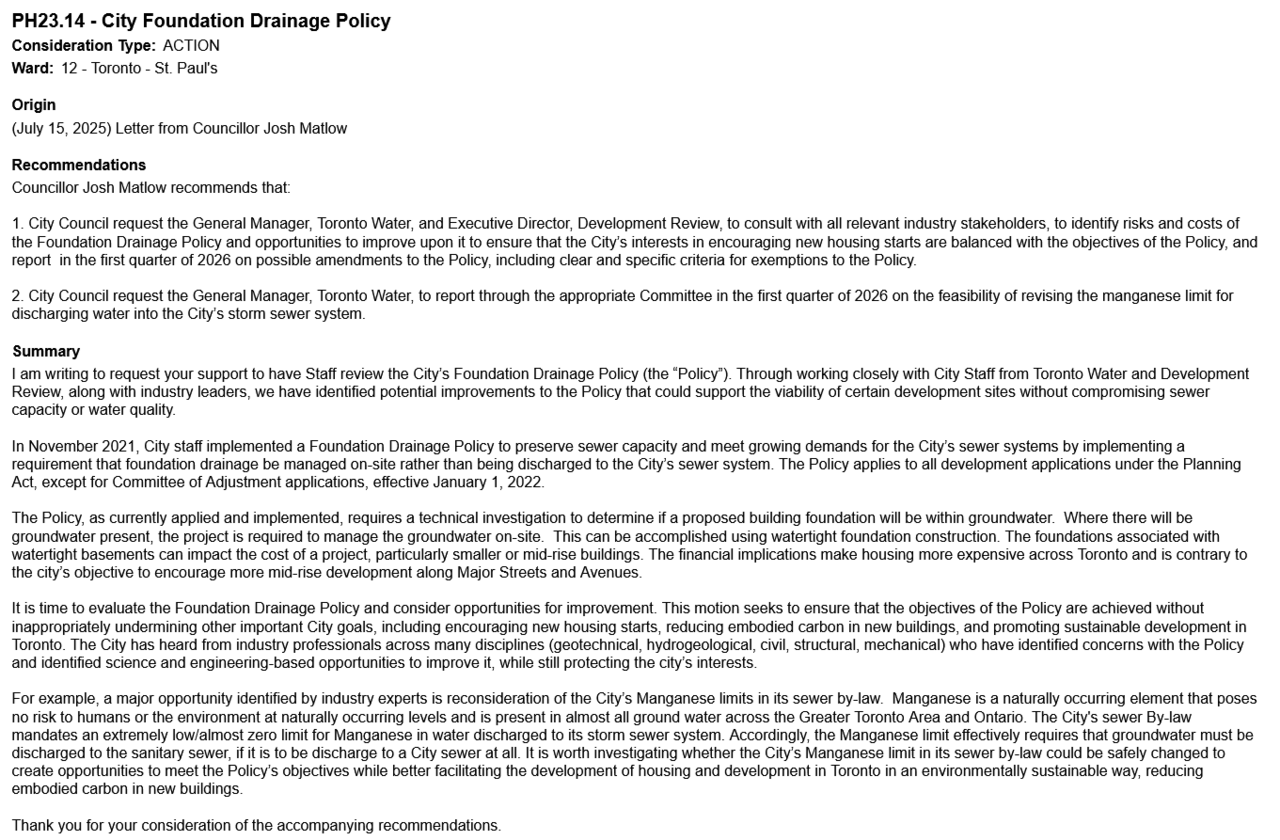

A Letter from Councillor Matlow has been added to the Planning and Housing agenda for today seeking a review of the foundation drainage policy.
Not zoning per se, but it fits as one of those rules about how you build that effects what gets build and where.
For those unfamiliar w/this issue, a policy change was adopted in 2022 which required that buildings whose foundations will sit in the water table had to go water-tight in their foundation or find other means of dealing with the water, other than draining it to the City storm sewers.
The result is extra costs for developers which can be particularly impactful on smaller scale/midrise projects.
*note, the policy is sensibly intended, as the discharge of ground water to the sewer system uses up capacity, that can then result in a holding by-law until the City can enlarge capacity.
The question here is whether the balance is correct in the details, and the answer is probably no.
From the above:
@ProjectEnd and @ADRM will now have their opinions solicited.

Yeah, this is an interesting one -- because the current policy is so un-uniform in its application, some developers have no idea that this is a problem and others think it's the biggest one in the city (i.e. if you've encountered it and gotten unlucky with the Staff on your file you know about it, but otherwise you don't think it's a problem).
The policy is currently interpreted by different Staff reviewers as both: A) The City under no circumstances allows a building to not be bathtubbed; and B) The City makes exceptions if your civil engineer can demonstrate that you won't have a problem.
It's obviously a big problem to have that much discrepancy in policy application, so it's definitely right to ask the question; I suppose time will tell whether they wind up getting it right or not through this review...
