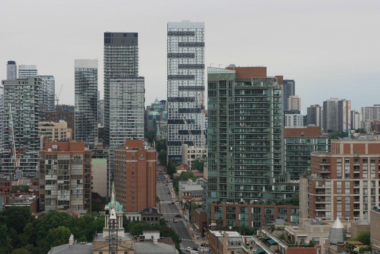

I know I've posted this angle before, but the building has a real presence from the south; one that will be significantly blocked as the redevelopment of The Grand continues. This will be my last view of it from Market Wharf; as I have mentioned in a few threads, my friends who live there are moving. Taken July 31:
