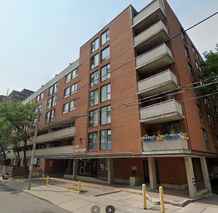

Existing mid-rise fronting Dufferin:

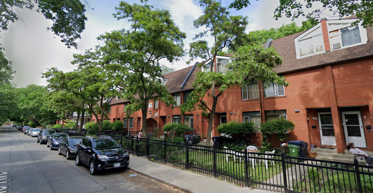

Existing townhomes fronting Gwynne:

Though I am sympathetic to the "we should do more retrofits because of the embodied carbon implications" argument, this seems to me to be a pretty obvious instance where a teardown and rebuild would make more sense. If it's currently envisioned as a 3-year project, you basically have to assume it's 4 minimum, at which point you're not really saving any time from a ground-up rebuild (and, as NL said, there is ample planning justification for significant height/density here).
