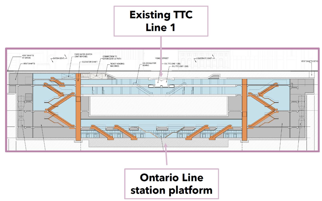

Edit to Add: This is the layout diagram:
Poached that off Steve Munro's site, here: https://stevemunro.ca/2021/12/02/ontario-line-downtown-construction-i-queen-station/

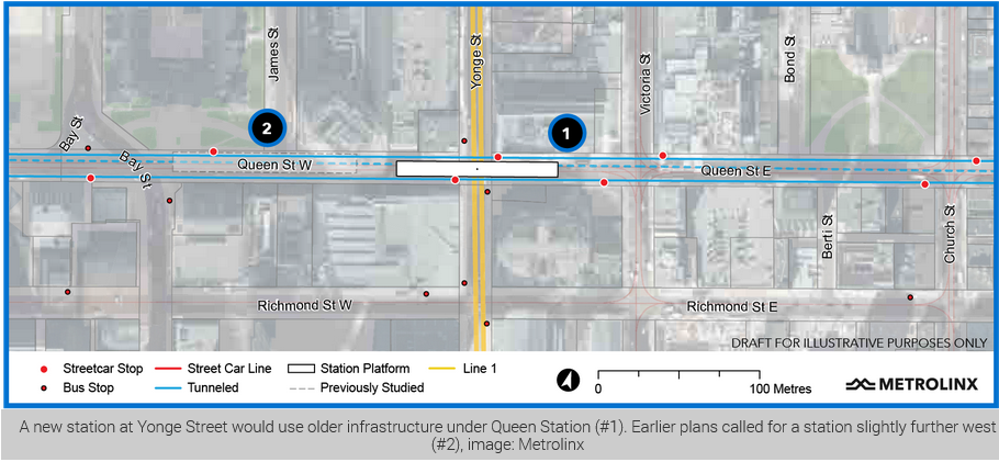

You can see the station box siting here:
Taken from a UT front page story: https://urbantoronto.ca/news/2020/09/metrolinx-fills-more-details-downtown-section-ontario-line
Holy.... this line is deep! Those elevators are going to be extremely popular if they aren't broken 6/7 days a week.
Montreal has a few stations that rival that depth, but yeah - you want the escalators and elevators to be in good trim at all times.
Yeah, that's unbelievably deep…

…and is the 'blank' section in the middle to be unexcavated, meaning that the new station below will be mined? The excavations at the east and west ends will be staggering to look into.
42
Yes, the station below will be mined.
From Steve Munro's site:

As we talked about before in the Ontario line thread, for some reason (probably Canadian/US building codes) they won't be using very long escalators to get down there. 5 escalators from street to platform is pretty embarrassing when other cities do that depth in 1 or 2 escalators.
(and assuming each escalator in that diagram has a friend going the other direction- that's at least 22 escalators at this station. Schindler, Kone, and Otis must be rubbing their hands in glee!🤑)
Oh, and the use of a full length lower concourse levels - when other cities like Stockholm or London don't do this - saving money!
