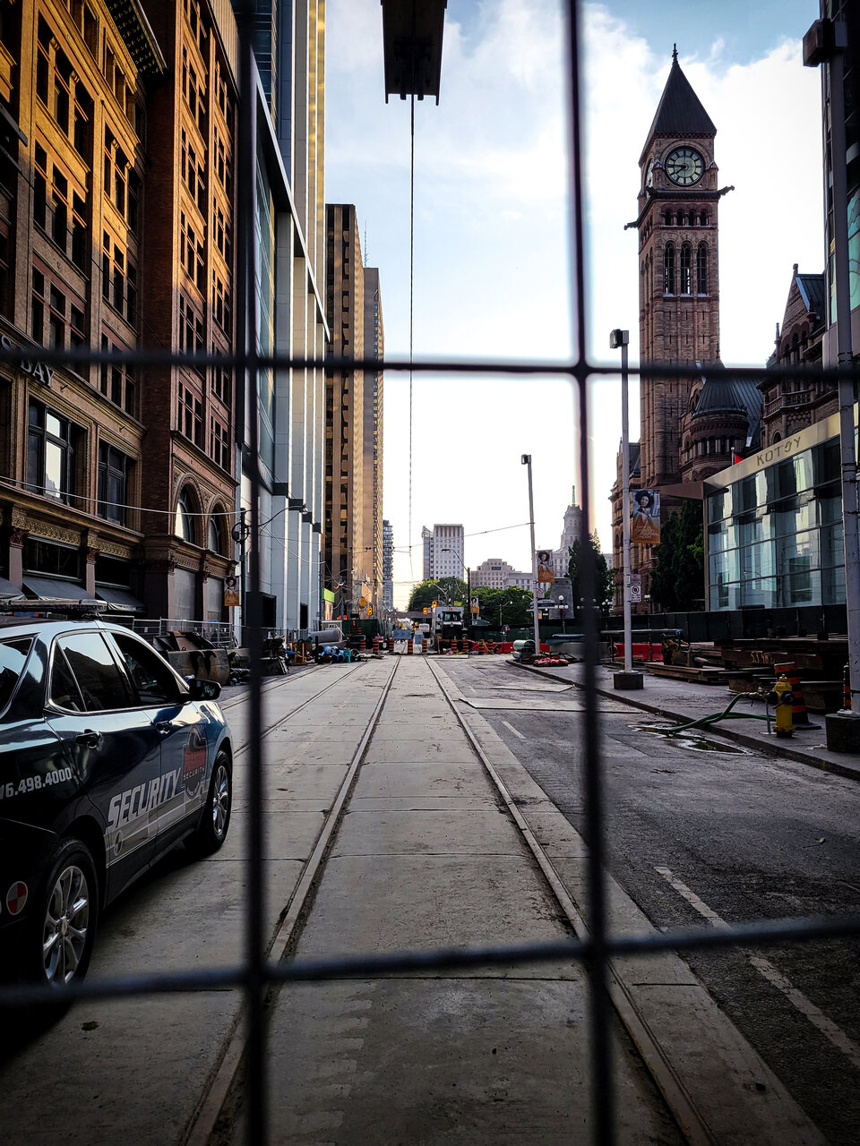

Should put in benches, picnic tables, trash cans, and peddlers that can be moved around during the construction. (Even some playgrounds for the kids to play on as the adults drink their beer.)
