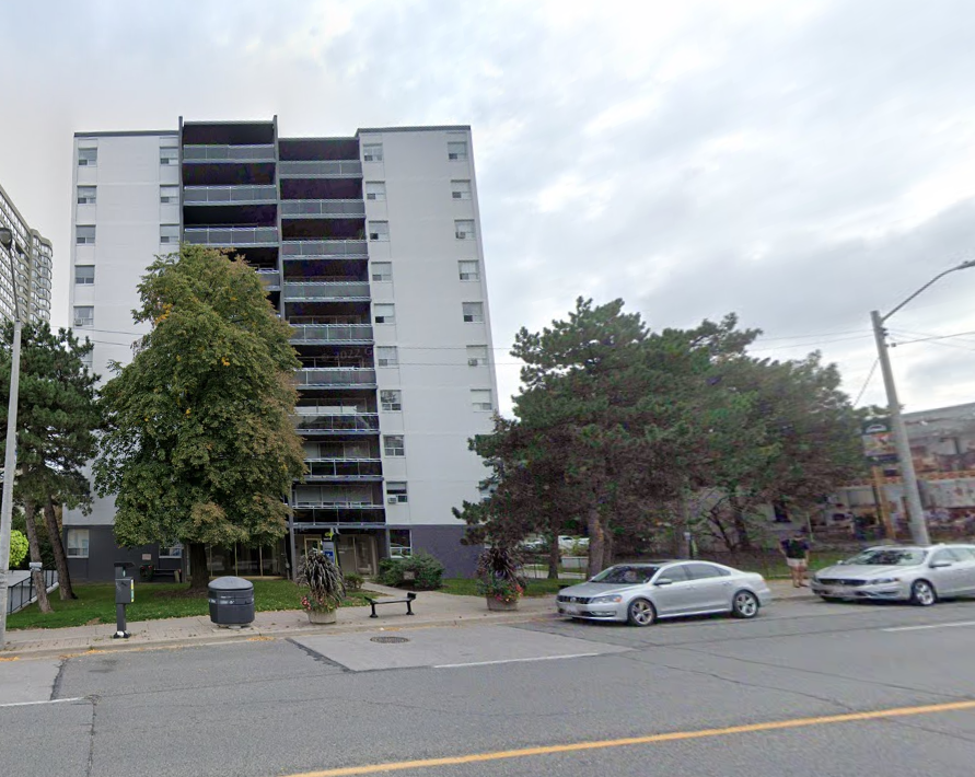

This new to AIC application seeks to redevelop an existing 10-storey, 56 unit purpose built rental on Dundas, just east of Cordova.
Site as is, per Streetview:

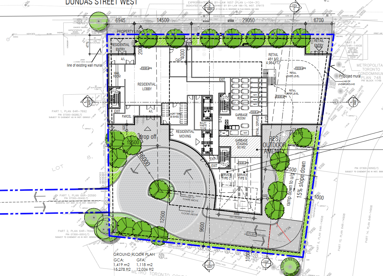

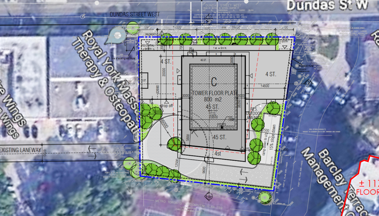

Site Plan:
Ground Floor Plan:

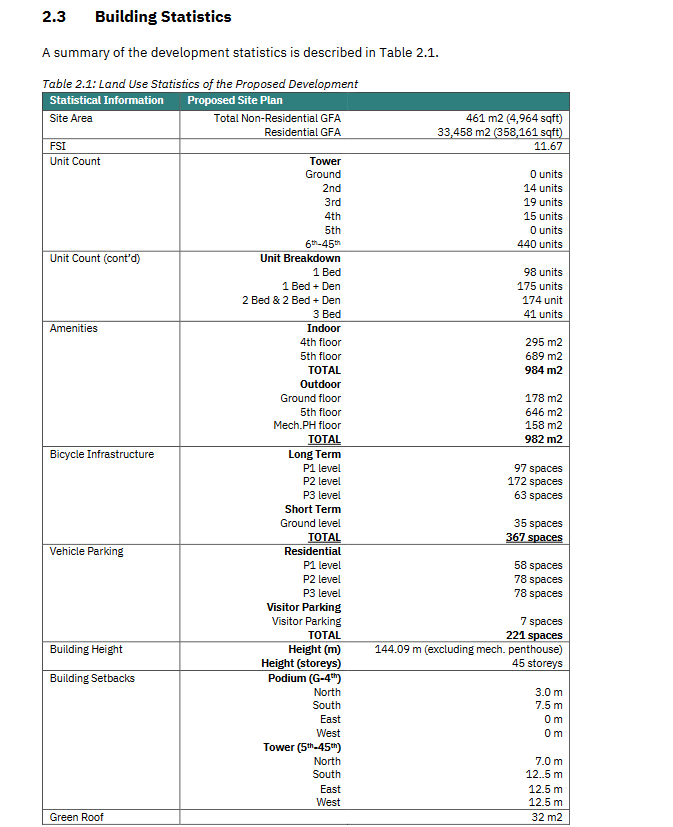

Project Stats:
Parking Ratio: 214 residential spaces to 488 units: 0.45
Elevator Ratio: 4 elevators to 488 units, one elevator per 122 units.

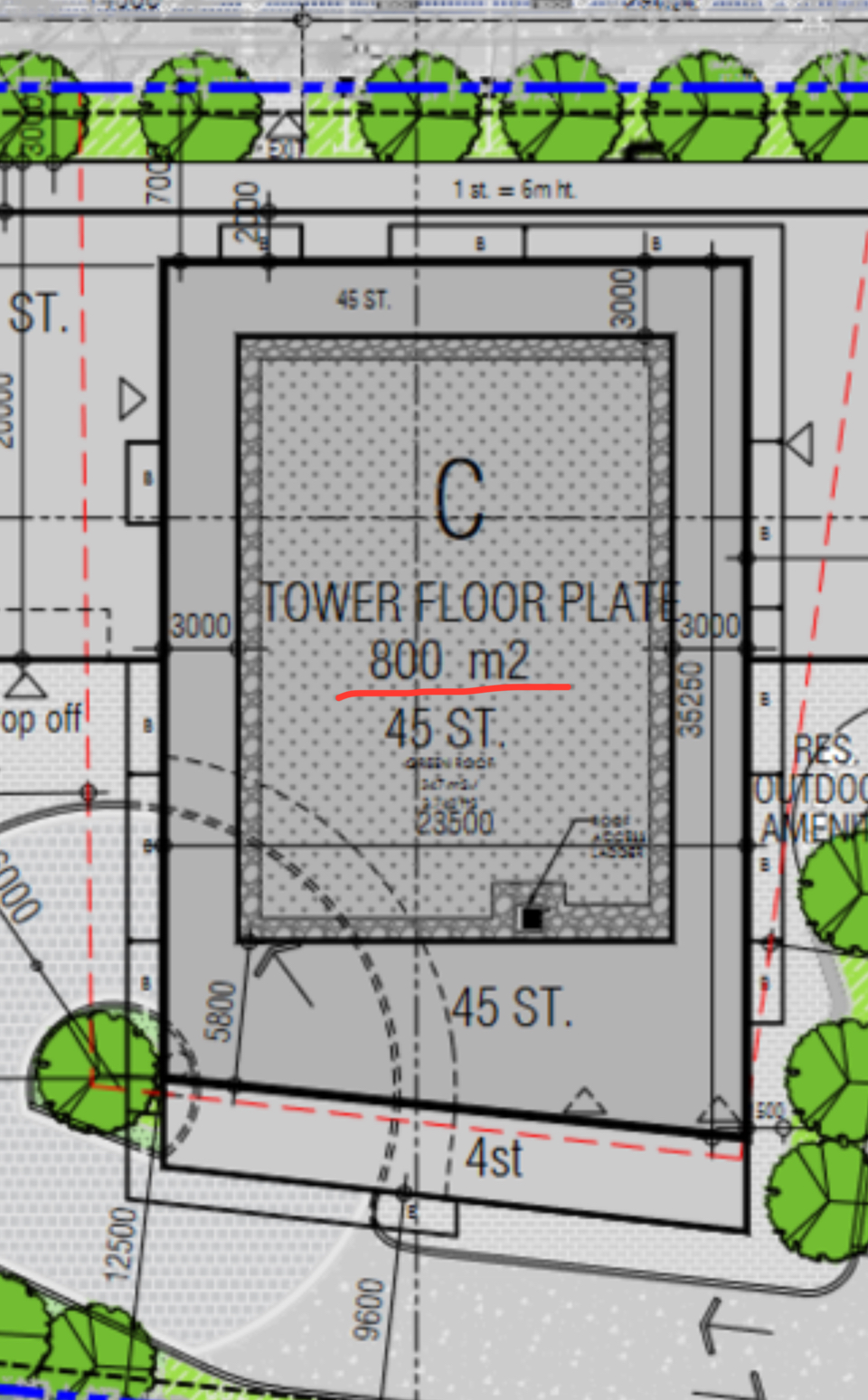

They would also like an above-guideline 800m2 floor plate. That might be an otherwise reasonable ask, but in the context of asking for vastly more height than recent precedents, I don't see them getting near the proposed height AND and over-sized floorplate.

Edit: Since I'm here, I will say the podium isn't all that bad; the landscaping is incorrectly positioned right up against the building, based on the render, this position means there would only be a single retail entrance, for a ~5,000ft2 unit. That pretty much makes it a chain drug store.
Too large for the vast majority of retail businesses.
The retail is aligned shallow and parallel to the street which means window film in the majority of cases.

Also adding this site to our “towers over +750 m2 floorplate” list.

As someone that lives in this building for 20+ years and is familiar with the local traffic, I question the approach on redirecting traffic through the back of the building to Cordova (with 210 additional underground parking spaces + all additional new traffic from the other developments in the area).
Here's why:
Let's say you want to make a left on Dundas St W during rush hour. To do this, you would need to exit out the back to Cordova making a right, and crossing two lanes of traffic to make a left at the intersection (that gets backed up for left turns from much farther back during rush hour), all in a distance of one restaurant chain called Thai Jalearn. The other option you have is crossing those same two lanes of traffic and making a left on Cordova, then making a right on Mabelle Ave that curves around via single lane through the area with newly added condos to eventually make a left on Dundas St W. Before you can even get to Mabelle, Cordova already has a lot of congestion and incoming traffic from Burnhamthorpe road that consists of a lot of people trying to follow the Cordova Ave loop that curves left and connects to Islington Ave and gets backed up, while the right lane is less busy at this point of the road (primarily allows to turn into the junior school on the right or keep going straight). So the latter option involve crossing two lanes of Cordova traffic going right, and one lane of backed up traffic going left.
The current front access is not an issue for this. During rush hour, the traffic moving right on Dundas St W allows you to make a left in between the cars that give you space during the red light of Islington and Dundas, which also prevents oncoming traffic from that intersection coming through, making a left very functional and I never had issues with it (or worst case make a left at Burnhamthorpe Cres and U-turn back out from there).
I understand the reason to make the exit come out from the back from a building design perspective, but I do see this path being very impractical for the above scenario of needing to make a left on Dundas St W during rush hour.
With the allowed 6 meter diameter for the entry way to the parking area (1 lane in and 1 lane out), if you encounter someone needing to make a left on Dundas St W, their wait time to exit and difficulty on achieving this will affect everyone else trying to get out. Between the added 210 parking spaces (and additional 56 existing spaces of 4875 Dundas building relocated to the back) and the existing users of the parking from the adjacent buildings, it will be a cumbersome issue.
