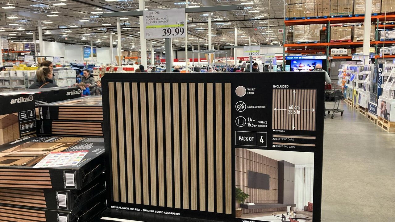

Interesting, do you know of retrofit options that could achieve comparable results? Would love to soundproof the place I'm headed to, but I'm fairly resigned to hanging up acoustic paneling and hoping for the best.
Acoustic paneling won't help much. Do you own or are you renting? Do you want all rooms sound-proofed or just one or two?

I just saw these in Costco, supposedly have sound isolation properties.
