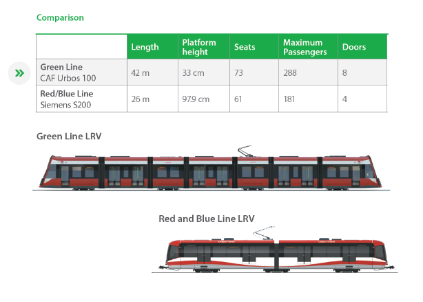

Can those trainsets be coupled together to make a longer consist for peak demand?
Forgive my laziness to back through a 100+ page thread but have they finalized all the design yet? Like how much of this will be underground? The animated renderings on YouTube are about 7 years old now.
Yes. They will start off with 2 car trains. But all stations will be built to handle 3 car trains. (The trains are much larger than the current LRT trains to start as well)
The designs are not finalized yet, but they have new renderings every now and then you can find on their website. They are currently in the final design phase before major construction starts. Currently, just the downtown section is tunnelled (2km out of 18km, 3 stations underground)
