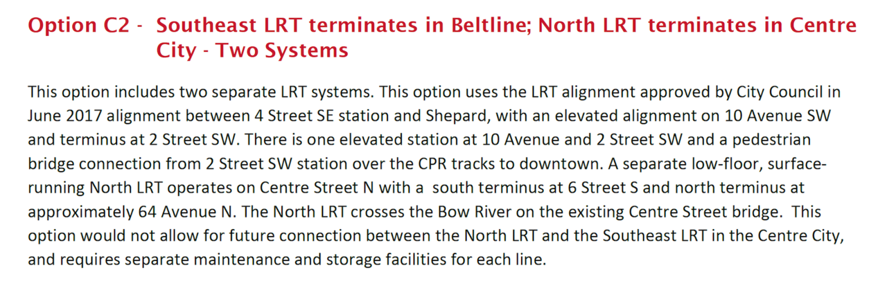

The more Green Line budget increases and the more political it becomes I'm starting to think the way forward is to split the line. Green Line south, Seton to Eau Claire (as planned; no changes) and then a Green Line north (with a new name obviously) straight down a transit only Centre Street Bridge with a terminus at Chinatown.
The biggest cost is the tunneling under the river/new bridge over the river and underground stations. Just remove that. I'd imagine that the cost of strengthening the Centre Street Bridge is a fraction of the current plan.
Ideally, yes one continuous line is better but let's not let perfect be the enemy of the good.

How would you propose vehicle traffic be diverted away from the Centre Street bridge if it becomes a transit only bridge?
Why terminate particularly at Chinatown? Why not at the 7th avenue transit corridor (to make easier connections to existing Blue and Red lines) or Calgary Tower?
Couldn't it simply run down the middle with one car lane on each side like it will to the north?
This is what planners originally wanted, because the plan is to have the tracks take two lanes of Centre St immediately north of the bridge anyway. But, there is some engineering issue preventing this, like the existing 110 year old bridge is unable to support the required weight or track bed.
(Which is weird to me because the bridge had streetcar tracks from day 1)
John Wick suggested a transit only bridge so I was curious on his thoughts about vehicle traffic.
Ahh, I missed those two little words.

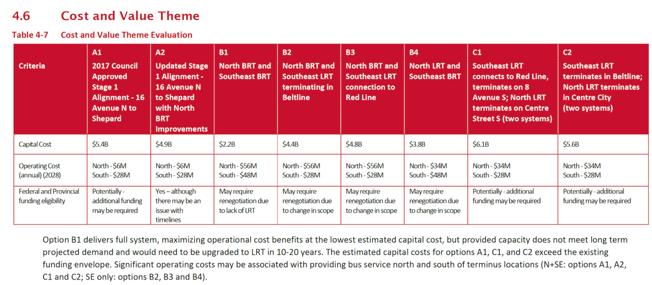

At that point, why not just have a bus? Save even more money
Sign me up! I've always been on team SEBRT + NLRT. One of the biggest arguments against this was how much land acquisition and design work was needed for the north and that it wouldn't be able to begin construction until the mid 2020s...which happened anyways. Of course there are also some political issues to deal with in terms of changing scope/timelines, but they've had to do plenty of tapdancing anyways.
OTOH BRT segments can open piecemeal as they are ready. Personally I'm just concerned that the SE is not going to have the ridership to justify the OPEX, let alone the addtional CAPEX.
