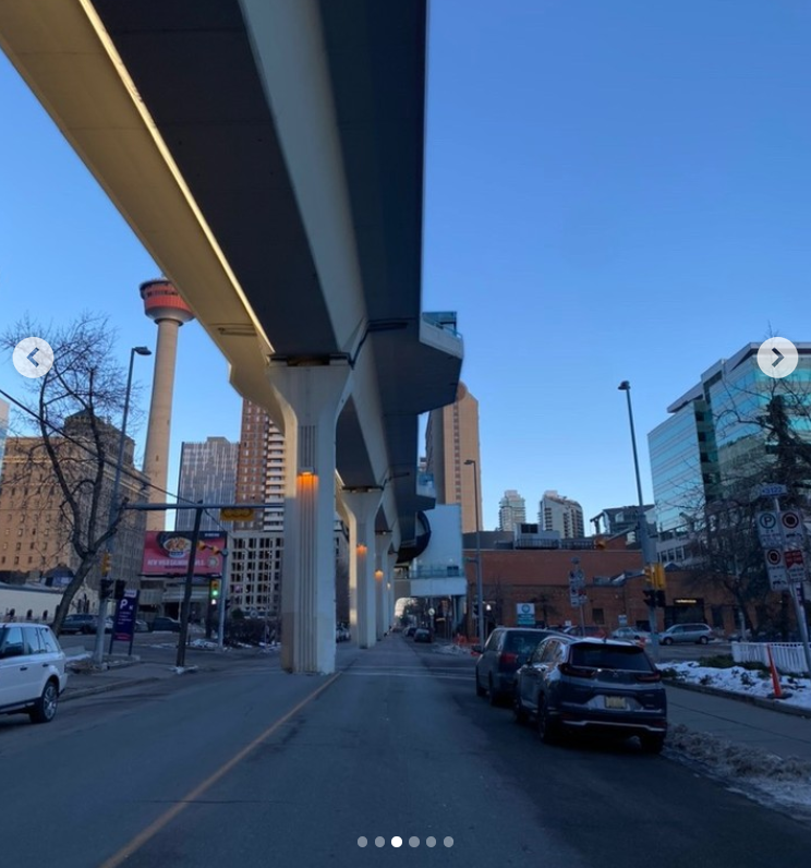

Yeah, it doesn't look great. And the heights of the track are probably too high. (which actually reduces the visual impact of the tracks.) But what do you think it would look like? Obviously, for a mere $2.5M we can't expect AECOM to do renderings, but I think there is some onus on the proponent to provide some indication of what the plan is or might look like, especially in a complicated, constrained urban environment.
But the existing elevated LRT track in Calgary is on a viaduct 35 feet wide, and 10th Street is only 45 feet wide curb to curb; what do you think it could look like? Where should the supports go? There';s not enough room on the sidewalks and the City has a commitment to prioritize the pedestrian. There could be columns on either side in the parking lanes, which would take up a substantial portion of the parking and be a real hazard at intersections, or they could go in the median, which would work if we dropped one parking lane entirely.
The Sunalta LRT station is 85 feet wide at the access point; it's only 75 feet across 10th St from building to building. I think that fitting 85 feet of station into a 75 foot wide space probably requires more than handwaving, and a "surely it can't be that bad".
@ByeByeBaby is right about the taller guideway being much better than a lower one from the street.
The median is what they should do. Could do a green boulevard between the columns (they won't it'll just be concrete) that allows you to have a left turn lane in the middle too.
There is plenty of parking so losing one lane of parking isn't a big loss. I don't see how you could do this style and put columns on a tight sidewalk.

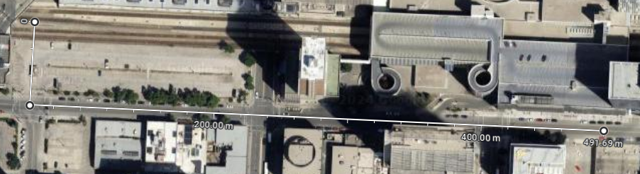

Maybe if you have the Beltline Station straddling 1 Street (as depicted) you don't have a choice. I was expecting that station to be pushing into the parking lot but that means expropriating more land... I mean you have a low floor LRT, why not keep it at grade as long as possible. West LRT takes about 500m to get to the CPKC required height.
Using that you could only have to start climbing just after Palliser South and get to the required height. You lose all the street parking on 10th because the surface line would take the two driving lanes for those blocks leaving you with the parking lane as driving lanes but at least for a couple blocks you don't have an elevated line. Wouldn't it also save money?
