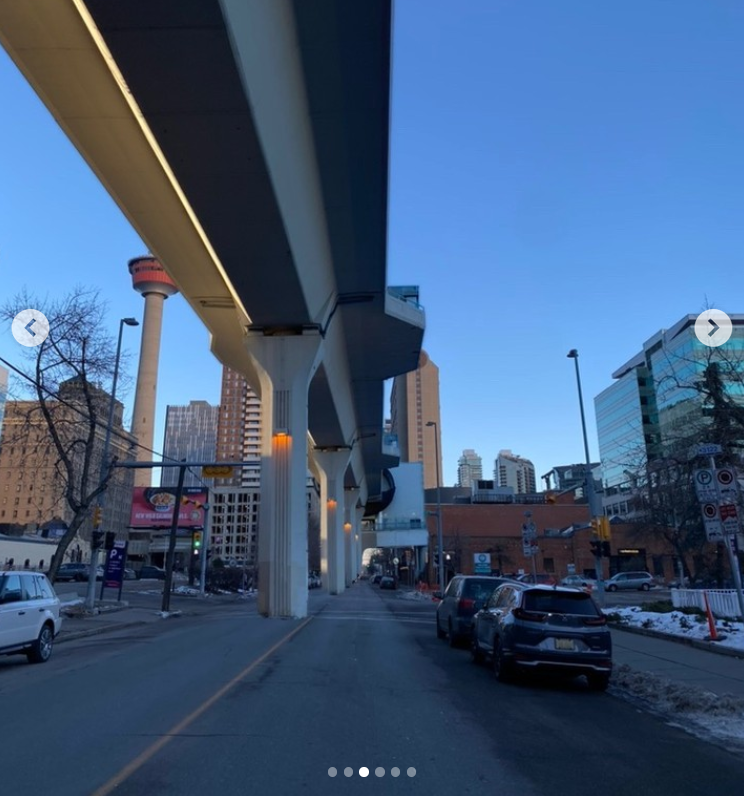

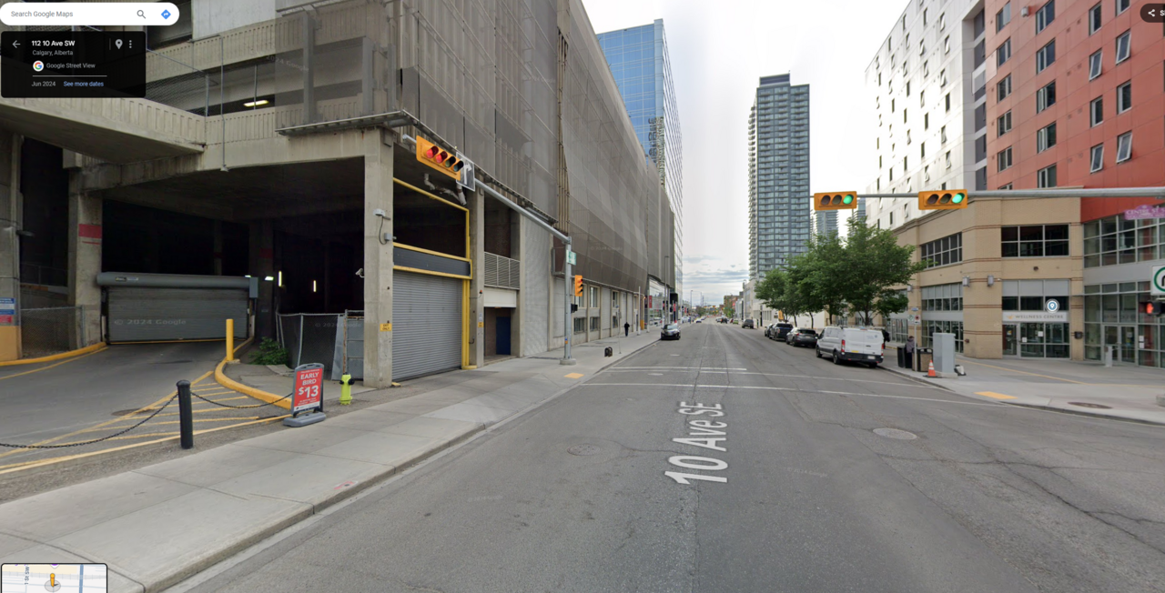

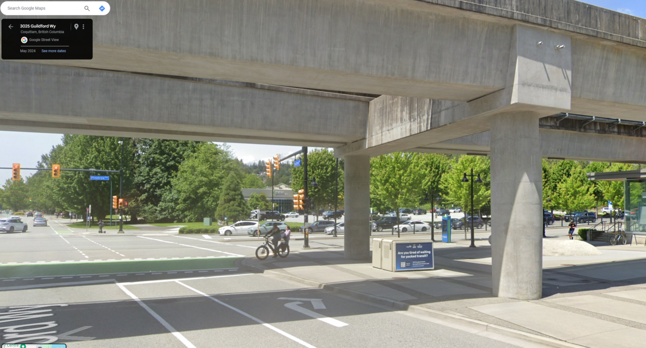

Yeah, it doesn't look great. And the heights of the track are probably too high. (which actually reduces the visual impact of the tracks.) But what do you think it would look like? Obviously, for a mere $2.5M we can't expect AECOM to do renderings, but I think there is some onus on the proponent to provide some indication of what the plan is or might look like, especially in a complicated, constrained urban environment.
But the existing elevated LRT track in Calgary is on a viaduct 35 feet wide, and 10th Street is only 45 feet wide curb to curb; what do you think it could look like? Where should the supports go? There';s not enough room on the sidewalks and the City has a commitment to prioritize the pedestrian. There could be columns on either side in the parking lanes, which would take up a substantial portion of the parking and be a real hazard at intersections, or they could go in the median, which would work if we dropped one parking lane entirely.
The Sunalta LRT station is 85 feet wide at the access point; it's only 75 feet across 10th St from building to building. I think that fitting 85 feet of station into a 75 foot wide space probably requires more than handwaving, and a "surely it can't be that bad".
An elevated train gives passengers a good view of the city. It's kind of silly to elevate a tram, but whatever...it is what it is.
I don't think it's a big deal if a couple parking stalls on 10th Ave get chewed up every 20' for the elevated guideway columns. 10th Ave. isn't a shining beacon of what a beautiful walkable street should look like. If two columns on either side of the street where installed, it wouldn't be the end of the world.

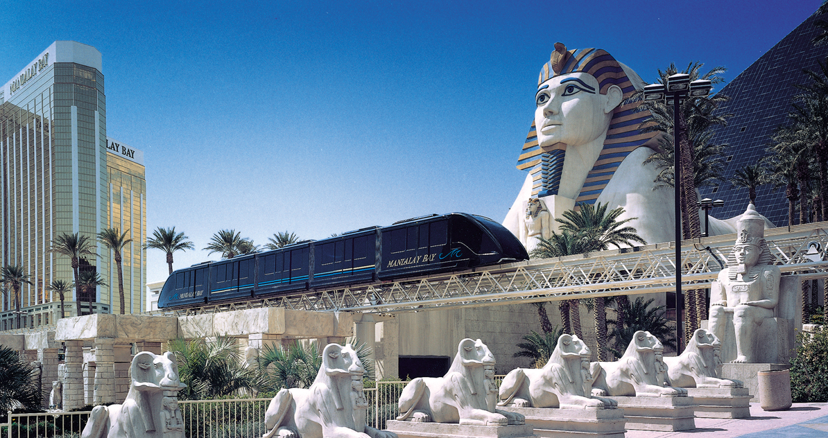

If sunlight/aesthetics are such a concern for an elevated line, would a steel truss rather than reinforced concrete guideway structure be an option? Beauty is in the eye of the beholder as far as whether it would be any more aesthetically appealing, but it definitely would allow a lot more sunlight down to street level. Perhaps a dumb idea, as I can't think of anywhere else this has been implemented on such a large scale. Perhaps corrosion would become a concern, making it more favorable for somewhere like Vegas and not here.
